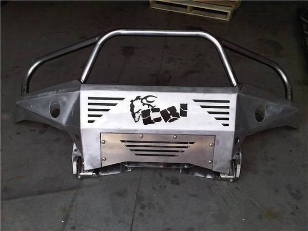

  12. Jan 24, 2008 at 7:18 PM
    L_Jackson
    L_Jackson Well-Known Member
    Jul 14, 2007
    #2093
    454
    Houston, TX
    2007 Black Sand Pearl PreRunner Acce
    Tinted Windows, Tow Hitch, 3" Toytec Lift, American Racing Outlaw II Wheels, Cooper Discoverer 33's, Aries Bull Bar w/ (2) 5" Lights, Nerf Bars, Fog Lights as DTR Lights, Roll Bar w/ (4) 5" Lights, Sony Speakers, 2 Extra Tie Downs
  13. Jan 24, 2008 at 7:30 PM
    piercedtiger
    piercedtiger Devout Atheist
    Oct 29, 2007
    #3284
    6,445
    Jon
    Southern Tier, NY
    2015 F150 3.5EB SCEW 6.5ft

    DEMELLO ROCK CRUSHER SLIDERS, PIAA LIGHTS, TSB 4 LEAF PACK, CBI OFFROAD REAR BUMPER LINEXED, CBI OFFROAD FRONT BUMPER LINEXED, REAR 5100's, 1.5" TSB AAL, ICON EXTENDED TRAVEL COILOVERS @ 3", TOTAL CHAOS UCA's, HELLA MICRO DRIVING LIGHTS, IPOD INTERFACE, THULE ROOF RACK, UWS SLIM LINE BLACK TOOL BOX, 17" BBS RD TRUCK WHEELS, GOODYEAR WRANGLER DURATRAC IN 285/70/17
    this company does
    http://www.aluminess.com/trucks.htm
    cbi would make you one if you want. i had them do my skid in thick aluminum.
    i am going to linex or paint the rest black.
