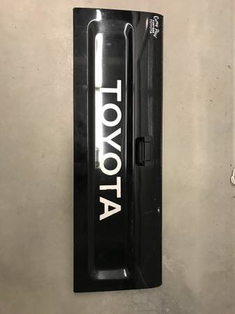

    I was wondering if the earlier models 1st gen tail gates fit models between 2000-2004? Not sure if this matters, but I have a DC. I was looking to replace my tailgate.

    That looks like a Toyota Pickup tailgate, not a Tacoma tailgate.

    Agreed, I think it's pre-95.5 - 89-95 if I were to bet.

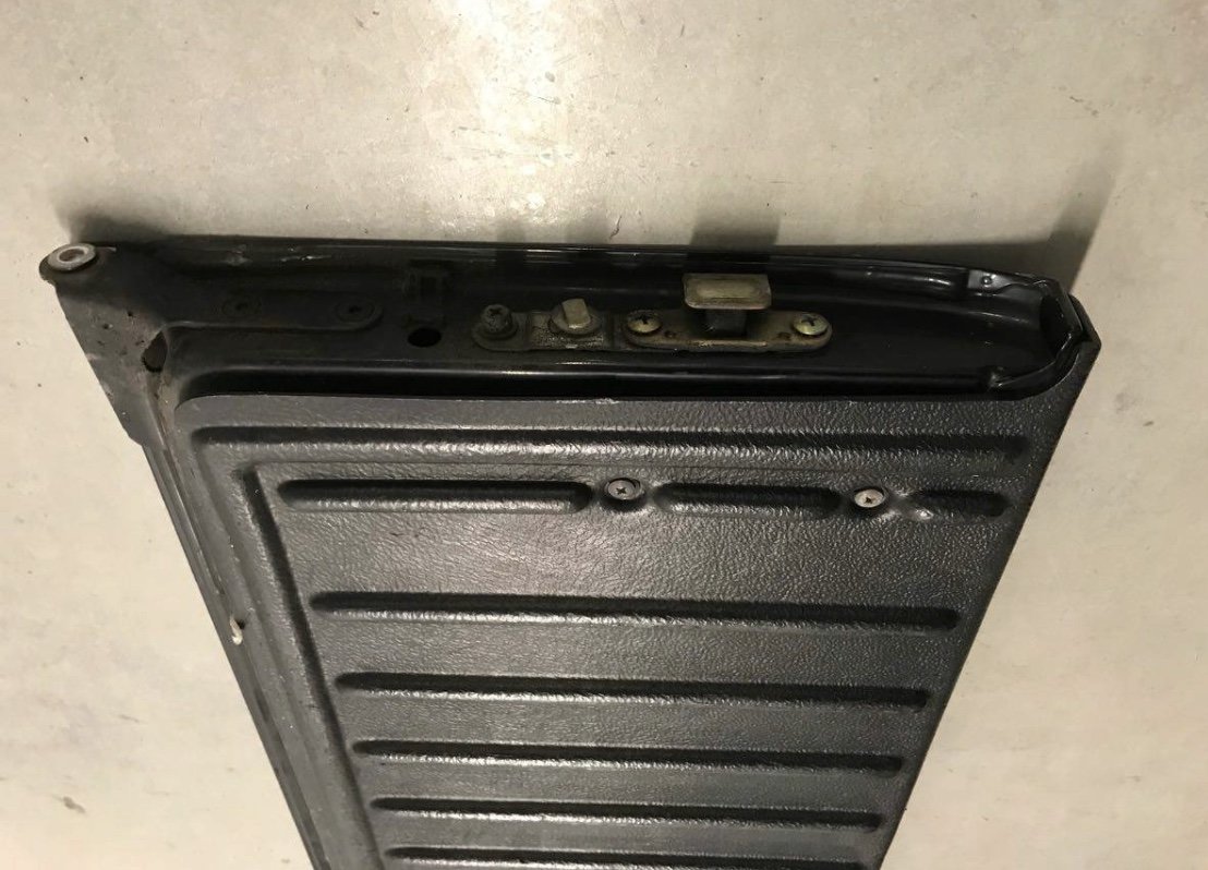

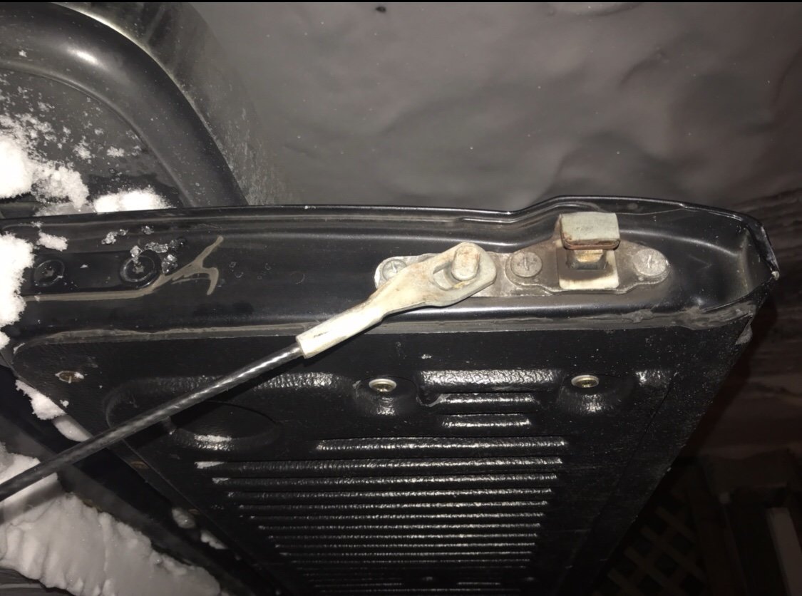

    AEEE418F-B1A6-4BC4-B7E3-A9C5153A8F8D.jpg BB711885-576F-451C-A492-A7B56C8DE863.jpg
    That’s correct 89-95. It’s on top
    I just did some homework.... though the width is the same the latch won’t line up. Also, there’s no swapping the latch because the cable is aligned with the handle.
    Too bad I was eyeing one... got some rust on my DC tailgate that’s an eye sore.

    So for those interested in this mod all you have to do is get some 96-04 latches and redrill them to the same measurements as the 1st gen tacomas basically a bit higher up. Everything else swaps over and tailgates are the same dimensions.
