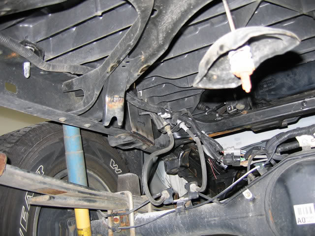

    For reference, this is a non-TSB leaf pack:
  10. Feb 8, 2008 at 10:38 AM

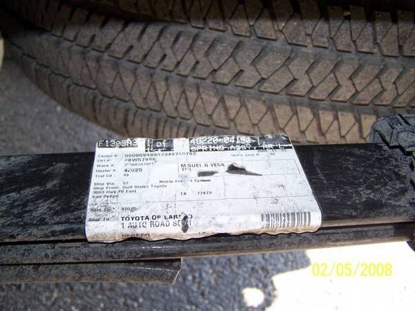

    And this the same rear spring leaf (3) part... but new... installed by the dealer in an '08... just a replacement

    yeah, mine looks like your replacement, but dealer said they'ed only replace it if VIN matches...they havent got back to me yet, im gonna call today
