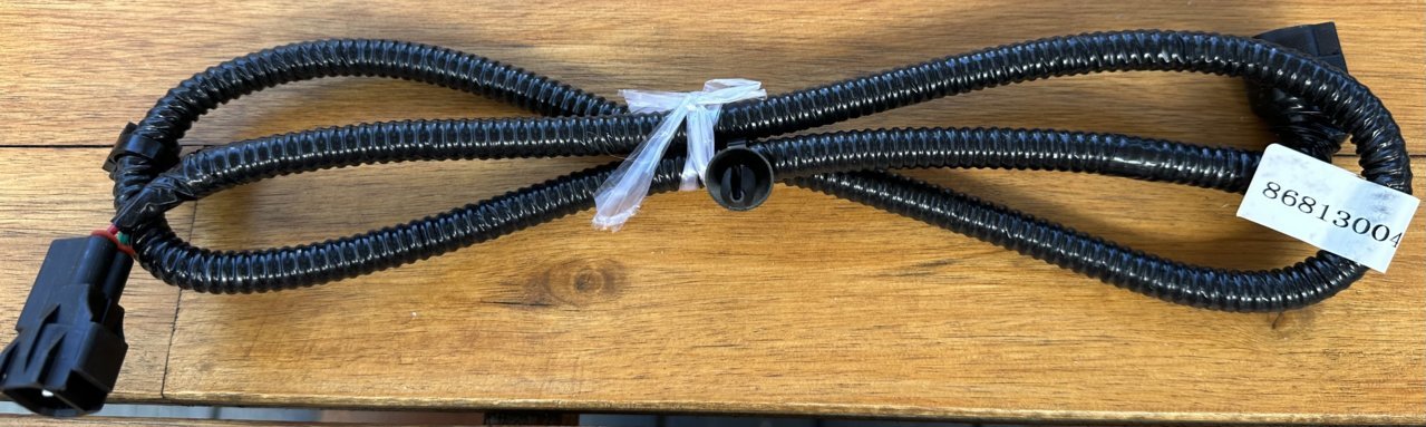

    There is no difference in the tailgate but there is a difference in the length of wiring from the passenger side wiring harness to the tailgate. The one I got is of course longer for the LB so if you have a SB it would work but there will be extra wiring to deal with and the SB wouldn't work with a LB

    And to update all, the part I ordered worked perfectly! Although nobody guaranteed it, it worked for the 2023 and has been great ever since I got it. Install was easy, minus cutting the metal zip ties in certain places but oh well worked great otherwise.
