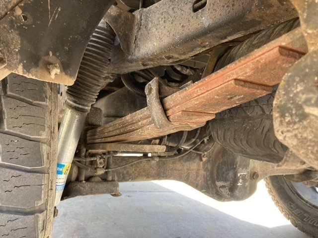

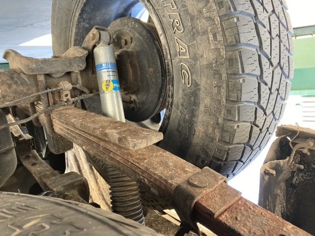

    Just bought my first Tacoma and received a notice about a recall for the rear leafs. It said 3packs and 4 packs. I have 5.
    Is there any way to tell if these are the factory springs that need replaced with an add a leaf?
    The only thing written that I can find on them is a MX.
    Thanks for any help!

    Can you get a more full picture of the leaf pack. Looks either an AAL or aftermarket leaf pack has been put on.

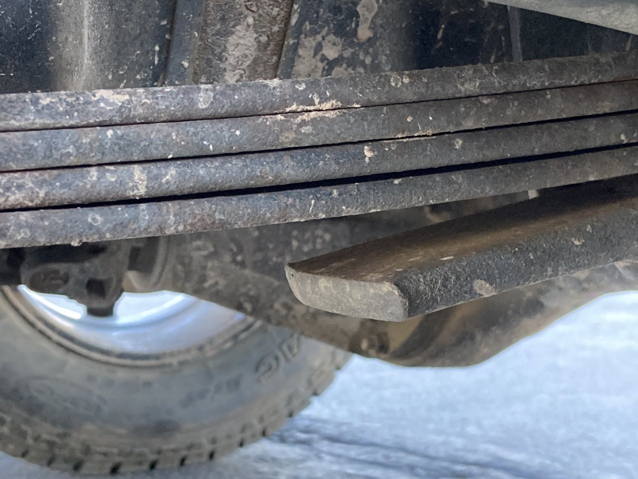

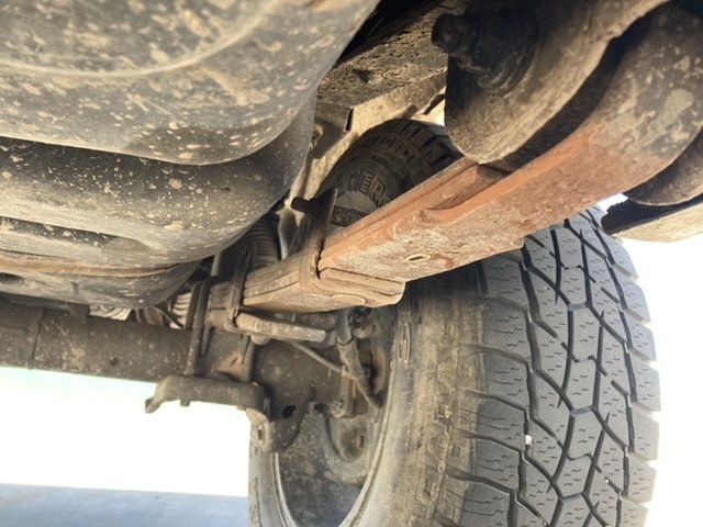

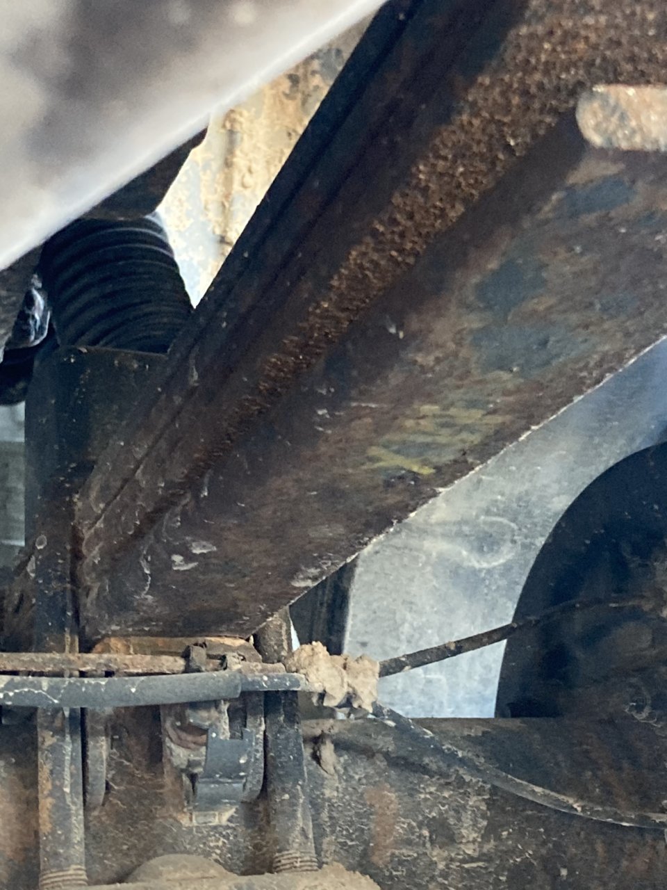

  4. Jul 7, 2020 at 10:58 AM

    Looks like someone put an extra leaf in below the main leaf, or its some aftermarket replacement leaf pack.

    Best thing you can do is just take it into a dealership for their assessment. If your Taco is still eligible and the previous owner didn't bungle something up with the AAL, then bonus - you get a new leaf pack. If that ship has passed, at least Toyota will close out the TSB for your specific VIN. I just had mine replaced and was elated... 11+ years and 140k miles, new leaf pack. Can't go wrong with that.
    Edit: [more info] My stock leaf pack was a 2+1, and the new is a 3+1. Further evidence that someone threw an AAL in there.
