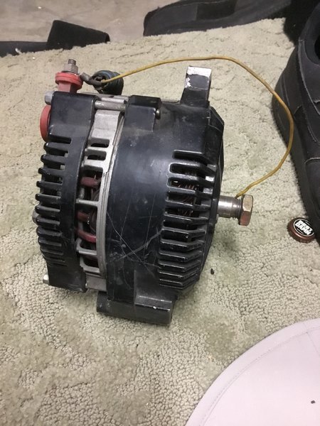

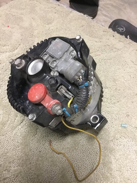

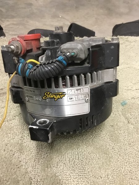

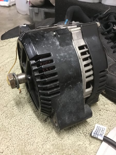

    I have a stinger . It's made in Tampa. Had it in my Toyota van 4y engine. It's was good. It was 100 at idle. Still have it it just sits on the shelf now . Got rid of the van . When I bought the taco. It was a 1 wire hookup . (Just ignition wire,then a ground from alt to frame).had to use 1/0ga. Wire though.

    Go
    Got some pics of it for reference?

    B ill y
    B ill y Well-Known Member
    Jul 29, 2015
    #160546
    306
    Billy
    Sarasota County, Florida
    2018 4Runner Trd OR, 1997 FZJ80,1985 FJ60
  16. Aug 11, 2016 at 6:17 PM
