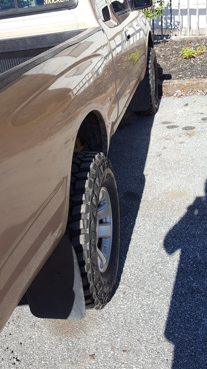

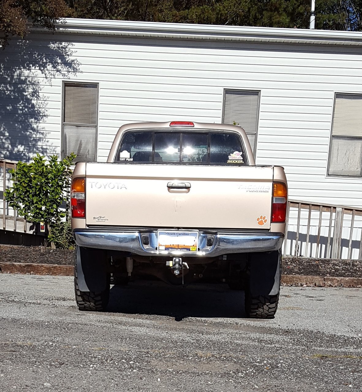

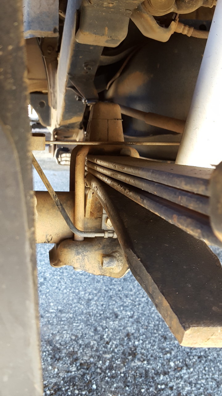

    Don't know how much these help, but here they are. Yes, the ground is level and that's how much the truck actually leans.
    AK, the truck itself has only 77.5K miles on it. The newer leaf has maybe 20K? I'm not 100%. Budget is roughly $500. I don't do serious off roading, just the occasional drive through fields/woods and a rough red-clay area near a local dam, that kind of thing. It's my DD. I only want to stay minimal on the lift because I really don't want an impossible to align truck nor to buy UCA's. I can handle wheel bearing and ball joint wear, maintenance is no issue but i can't justify 600+ on UCA's for a mostly street 2WD non-TRD truck..
    I don't mind spending money to get the truck as close to the condition it should have been without the wreck, as I've had it since 35K miles and there isn't another around this low, but if I hate anything it's disappointment after modding something. I went cheap about a year ago and attempted a 3" spacer/block lift and couldnt get my strut back in with the spacer...ended up taking the rear lift back off and sending it all back. Man was i bummed. Looking to do it a little more appropriately this time around.

    Yeah you've got negative arch on the driver's side leaf and neutral on the pax side... Without weight in the bed ...that's says old and tired.
    It also seems that there is some bend in the frame, cause your bump stop is Def not aligned with frame... But that could be the angle of the picture?
    If you just want stock, I don't see an issue with a new set of OEM springs

    Yes, detailed pic's of the driver side would be nice, front to back.
    I don't think leaf springs are suppose to be flat like that right?

    Not when there's no weight in the back!
  15. Nov 17, 2017 at 1:36 PM
    tony2018
    tony2018 Well-Known Member
    Feb 24, 2014
    #123866
    5,288
    Damn, no weight on mine but those leaf springs are flat. Yeah def not a good sign about PO doing any maintenance or not following the max capacity limit of the truck.
