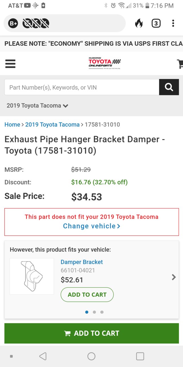

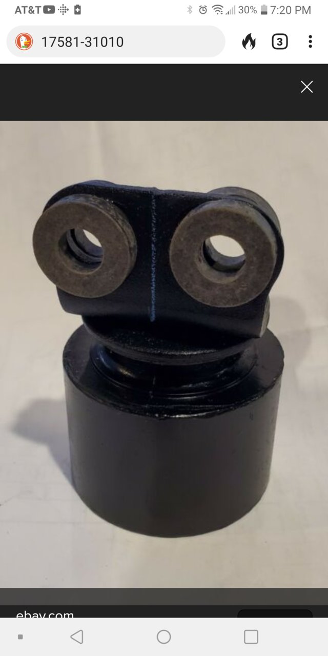

    I have a 2020 tacoma auto 4x4. I have had the steering wheel,gas pedal and floorbosrd vibration (elec toothbrush feeling)caused by exhaust. I added 3 exhaust dampers and it took 80% of it away.i also suffered from shuddering while braking..if I use the brakes really hard it seems smoother.or if i wait until after 20 mph it seems smoother basically normal even if I lightly hit the brakes .i have 17,000 miles on my truck so the brakes are def worn in by now and I have gone through spats of using them hard and bedding them in and still it comes back so I go back to using the brakes hard and its better but not normal .im about to redo the rear shoes and drums and see if that helps.im also gonna measure the axle flange and make sure its to spec since there was a tsb on then a little bit ago about them being under jist a hair...i also have vines on decal. If I slow down around 20 mph to qt mph no brakes just letting ir coast it sounds rough and vibes ...atleast im getting somewhete tho.... Screenshot_20211020-191605.jpg Screenshot_20211020-192040.jpg

    Most other toyotas with this engine use these dampers .ours tho has that fuck with the valves and call it atikson bullshit so im sure that makes it worse...im telling ya get this damper ...i placed one righr infront or behind the cat on the drivers side,one after it crossed under the t.c. and one before the muffler ..made a huge difference ...almost feels like a normal vehicle .best 160 bucks I ever spent . I may get the maganflow overland series exhaust with helmholt resonator and see if its even better . pop the hood and look how close the down pipe is to the steering shaft and floorboard...

    I has to trade mine in 8 months and 4 dealers disnt care enough to help me figure the issues out...tge 3 exhaust dampers I put on almost took the buzz totally away but between 50-60mph light theottle i still got a little repetative drone .ermmm ermmm ermmm evwry 1.5 seconds .on top of the shuddering when braking(brakes already redone made no difference)and the decel vibration with no foot on brake pedal I just couldn't do it anymorem..gave me anxiety wondering wtf is going on..is it gonna be sonething major that breaks down the road but for now i just have to pucker my asshole evwrytime I brake and be annoyed every drive I take??? I needed to be able to drive and have things be normal .i am a very sensitive driver .i cant help it.. Im kinda upset about my experience I really wanted to keep and enjoy that truck but luckily I got a hell of a deal on the new truck and got about 6 grand more theb what I paid for the tacoma so i made out like a bandit ...maybe one day ill go back to a tacoma but ill def be doing a long test drive this time.last time I didnt have time to even get in the truck before signing papers .if your one of the lucky ones that has no issues I envy you . I was about to take some diff tacos for a drive and possible trade it in on one that didnt jave these issues but this deal.popped up and couldnt pass it up
