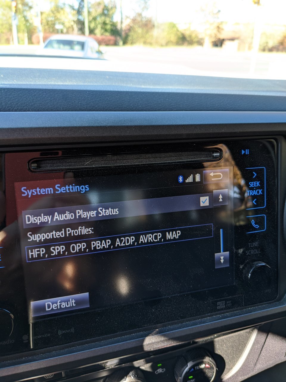

    There are some strange issues with the reception of the pixel 4 showing "no signal" even when the phone shows one. I contacted Google about it. They did offer some help but ultimately said that I should contact Toyota about it.
    Here is a list of all the Bluetooth profiles. You can look up those referenced in the attached picture.
    https://en.wikipedia.org/wiki/List_of_Bluetooth_profiles
    https://www.tacomaworld.com/threads/pixel-4-issue-on-3rd-gen.639272/
