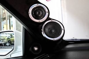

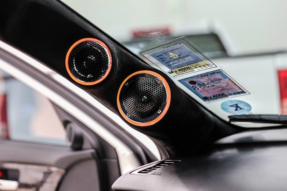

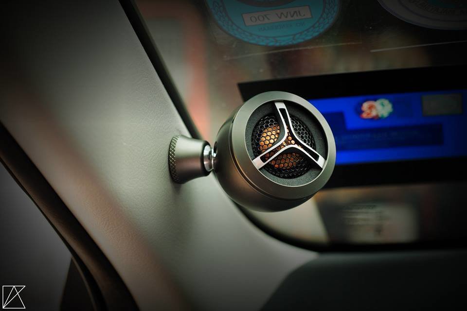

    Nope, but unless your in a rush for pillars i can most likely make some for you in a month or so when i do a clients here....
    IM trying to convince him to go with the K63 and do the full range and tweeter in the pillars

    Well then , I think " YOU " just came up with a nice idea . Build me up some nice looking right and left pillars that will accommodate the tweeters . I will install them and pop all kinds of pictures of my install and you can sell them as part of your Tacoma package hehehe . I think you walked into this one o_O.

    Nope, but once i make them they will be specific for the K62 tweeter with the driver side A-pillar most likely housing either a boost gauge or a digital volt meter

    I really like the look . How can we get past the air bags ? I believe 2010 and up all have air bags in the pillars . With this said , there may be a safety concern adding tweeters to pillars . I know guys are adding pod gauges to their pillars but I would hate to see what happens when the air bags deploy .
    There has got to be a work around for this ?

    Next time I work on my clients setup I'll take a look what's behind IT.

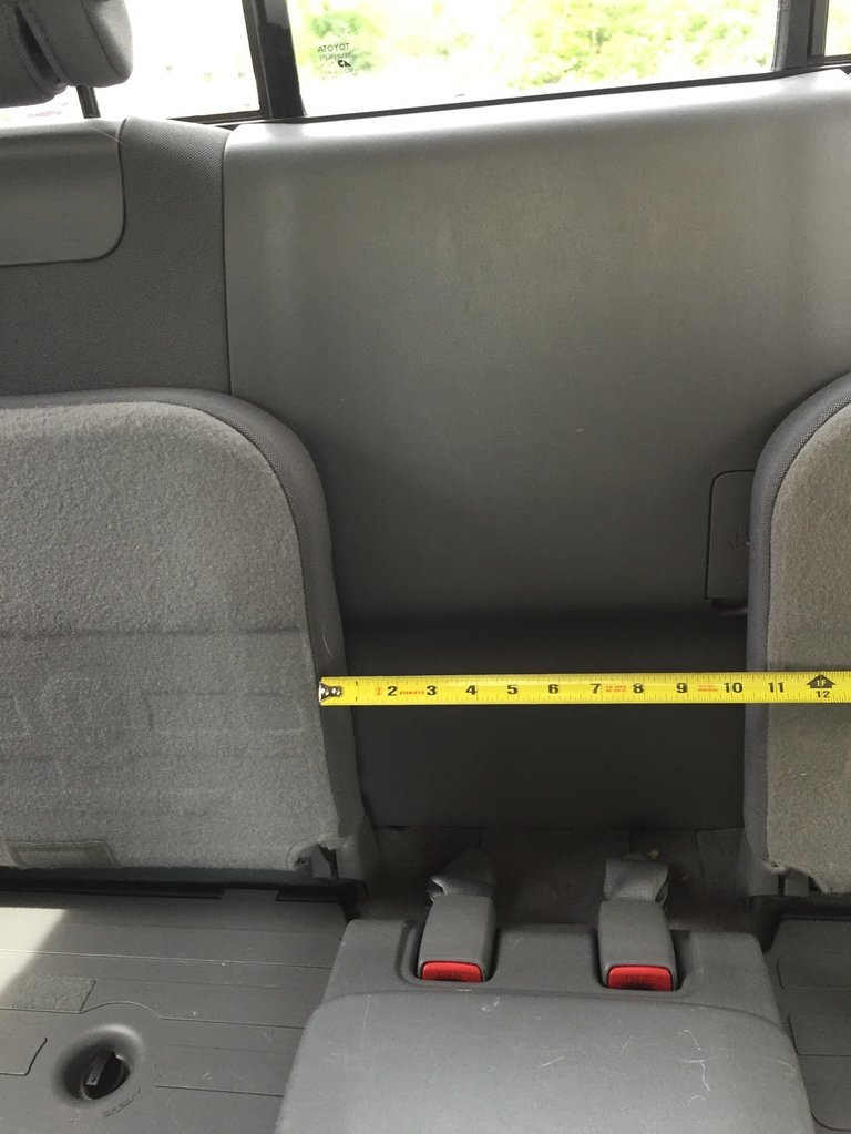

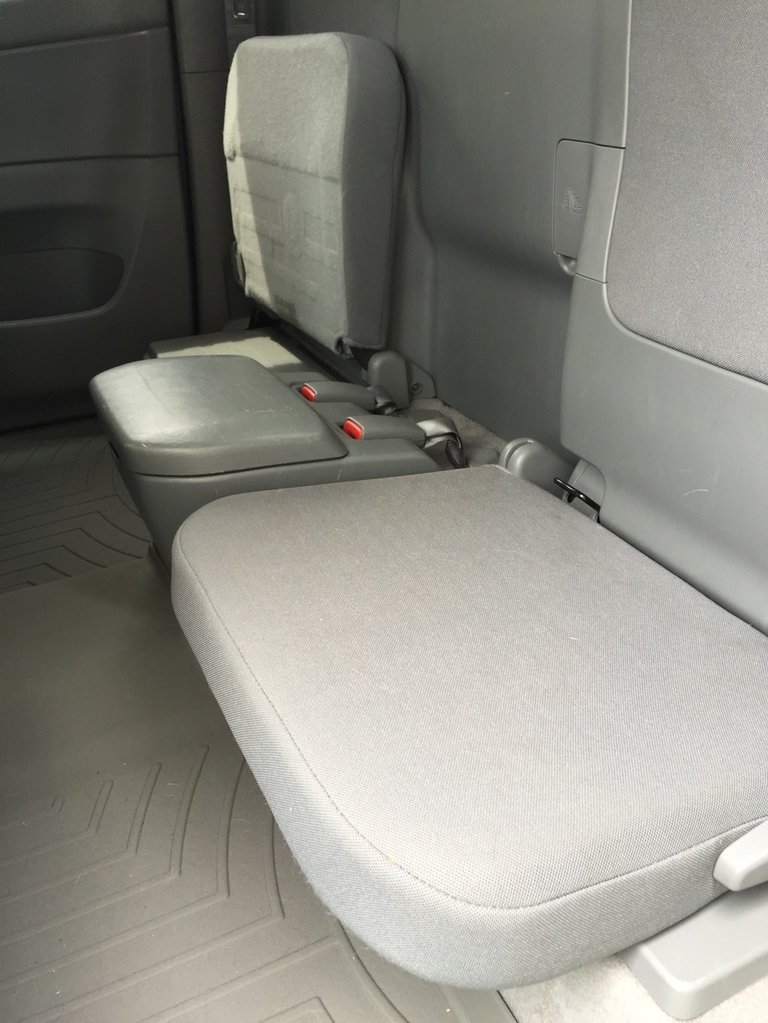

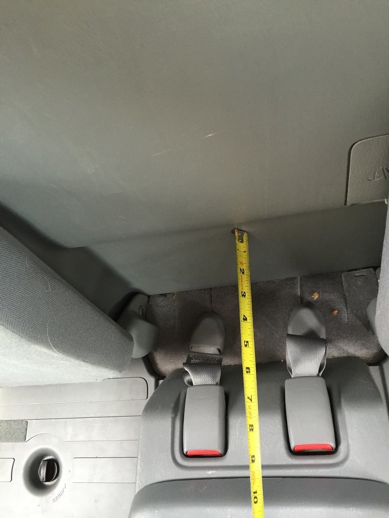

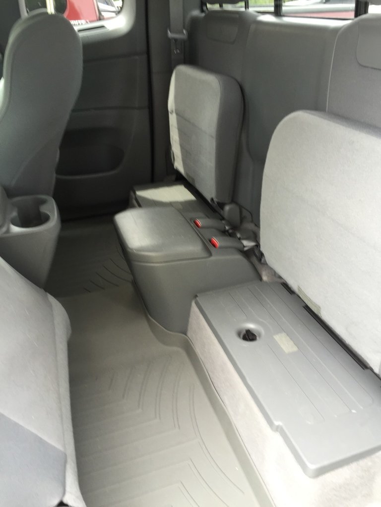

    I agree with Mr. Cruncher. I think those square units could be just the thing. For my AC I'm imagining mounting it on the rear wall between the jump seats. Away from feet and moisture.

    I'd wait to do it right once, and be done. Would the on board amp power the sub exclusively? (sorry a bit ignorant on the fine points of this gear.)

    Yes the internal amp would only be powering the sub. I have small 4 channels available with varying price ranges and power specs.
    For the space you have there if you were to remove that centre console you can easily get a nice box in there for a single 10 inch and wouldn't be that hard to build, A basic function box is all you need.

    I think for the AC's a super strong contender is exactly what The op is doing
    H500, ether 8-10-12 inch sub depending on how much space they want to use up and their choice of mids. Easy, not messy and superb performance.
    Kidsmoke, another option is to remove that rear centre console thingy,
    Build a box or use a big round pvc pipe and cap one end off and mount the sub to the other.
    You will need either a 8 inch or 10 inch or 12 inch pvc pipe to do this and fit it between the 2.
    IF your skilled you can do an octagon shape box by kelfing the panel at the right spots and bringing it it to make an octagon. Again, sub faces up and should be enough space for the 8 or 10

    Cool idea manethon. How deep should the tube be to provide the "right" cu. in. behind the cone?
