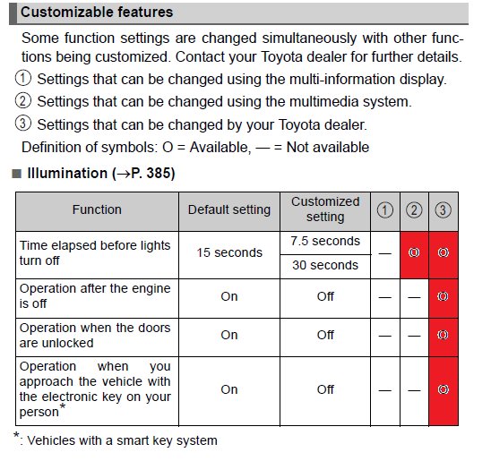

    Problem solved. The "2019 Tacoma Owners Manual" does not contain info on how to set the entry lights ON/OFF times for trucks with the "EnTune Premium Audio" option...which I have. That info is only in "2019 Tacoma Multimedia & Navigation Manual". With EnTune, under Setup, there is a 2nd page of options. The one needed is "Vehicle". If you have Entune...configure the entry light times here:
    Apps/Setup/Vehicle/Vehicle Customization/Lights Settings/Interior Lights Off Timer/7.5 sec, 15 sec, 30 sec, Off
    Mine was set to "Off".

    yes, use the arrow at the bottom of the window to access the 2nd page
