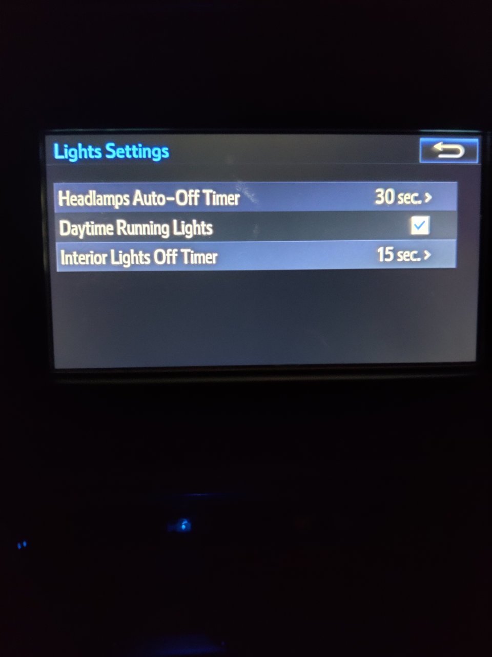

    Update:
    I was driving around last night, and while at a stop light, I checked the Apps menu and I was able to view the "vehicle" settings:
    I toggled around the Interior lights OFF timer from 7.5 seconds through 30 seconds, it made no difference, when the car is parked, or turned off when I open the car doors the interior lights don't turn on.

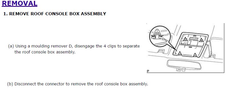

    Do you know how to remove the overhead console?
  7. Mar 23, 2022 at 2:27 PM
    #27
    hotsaucejunkie
    hotsaucejunkie Member
    Mar 21, 2022
    #393121
    16
    San Antonio
    2017 Tacoma

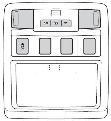

    I haven't, but I'm not afraid of trying, however, my truck doesn't have a console really, just 2 "map" lights upfront where the light switch and traction control button is, and the dome light chingas in the middle, but no console in between those 2 lights just headliner.
  8. Mar 23, 2022 at 2:30 PM
    #28
    caribe makaira
    caribe makaira Well-Known Member
    Feb 13, 2011
    #51121
    11,733
    Caribbean, Puerto Rico
    05 PreRunner TRD Offroad AutoTrans
    Hood Struts, My version Fogs always ON, Map & Overhead Light Mod,
    Like this?:
  9. Mar 23, 2022 at 2:37 PM
    #29
    hotsaucejunkie
    Mar 21, 2022
    #393121
    16
    San Antonio
    2017 Tacoma
    Yup, that's what my truck has

    It just pulls down. Easier with a panel removal tool. (plastic)
    hotsaucejunkie likes this.
  11. Mar 23, 2022 at 2:46 PM
    #31
    GrizzledBastard
    GrizzledBastard OH NO! I've built a Faux Pro!
    Jul 8, 2021
    #370781
    1,597
    Tim
    Central Coast, CA
    '21 TRD OR 4x4 DCLB Super White
    Not enough bandwidth on the internet to list.
    It pulls out quite easily.

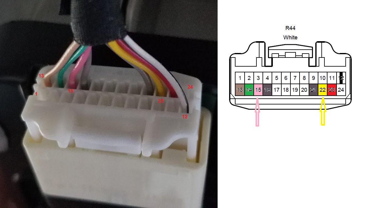

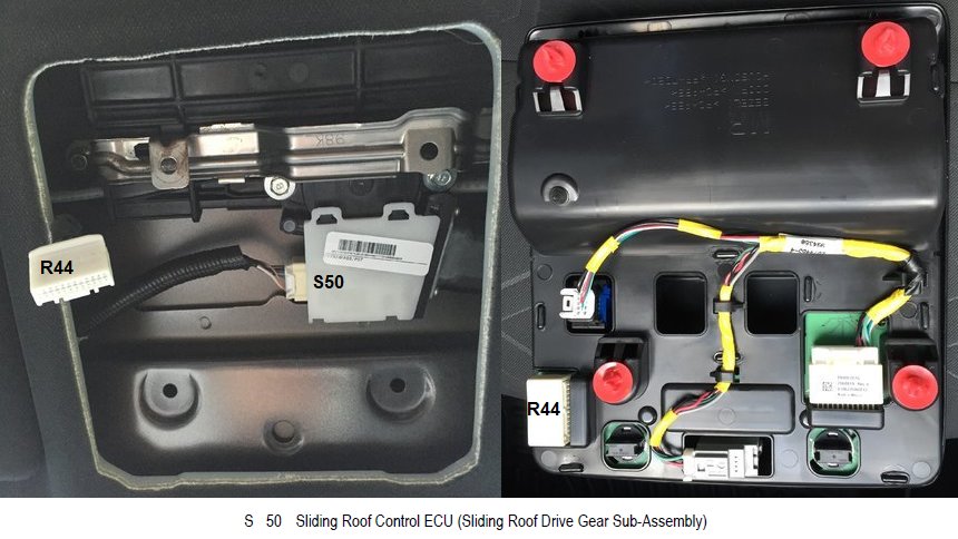

    Disregard the S50, your Taco doesn't have it.
    Removed a Map Light bulb, tape some stripped wires to each contact of the bulb. On connector R44 of the vehicle, place the other ends of the wires (stripped) to 15 (+) & 22 (-). Place wires on the back where you see the wires NOT where they connect to the console.
    Test the function by closing the door.
