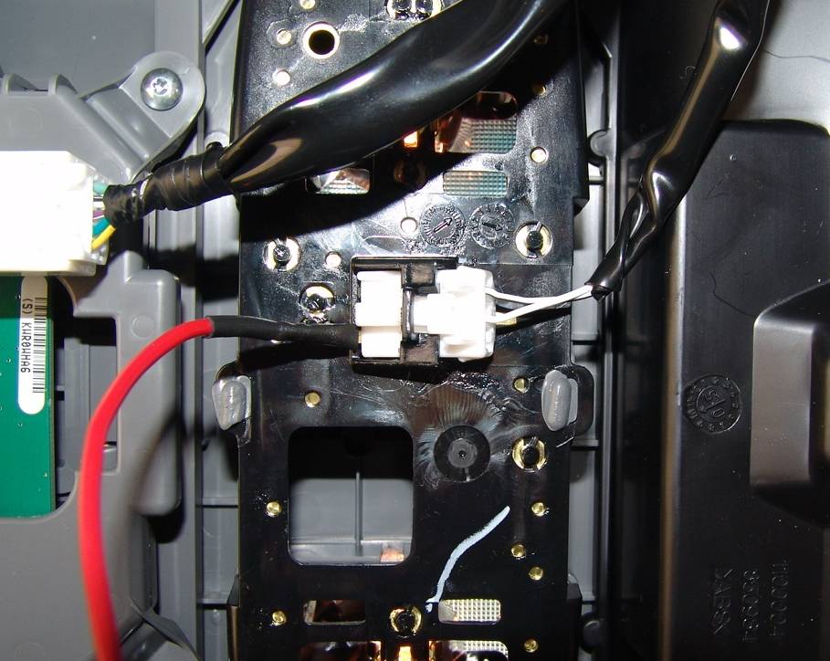

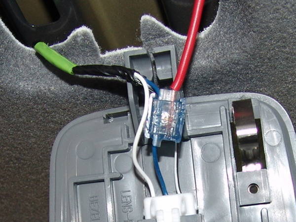

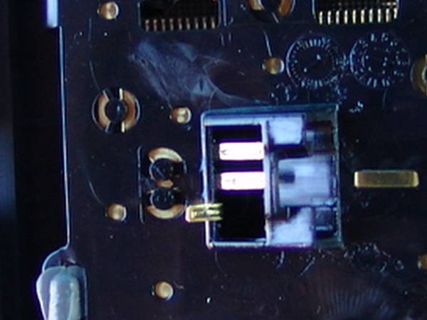

    I know this is a super old thread, but I just tried this and am hoping that someone could help me out, because I am stumped. :(
    First. My truck is a 2007 Sport 4x4 Access Cab.
    I used this method:
    I fallowed the directions above. swapped the wires in the plug at the map lights, ran a single wire to the dome light and tapped the middle (blue) wire.
    Here's my problem. When I open the doors the Dome and the Maps light up just like this mod should. However my Map lights DO NOT work independently. When the doors are shut and a click the map light nothing happens. While the doors are open, if I click the map light it shuts off that map light. Dome stays on as well as the opposite map light.
    I am not sure what I am doing wrong? :confused: My wiring looks the same as the pictures above.
    Any thoughts? I appreciate it.

    Possibly since the wires in the above pics are white and the other threads show yellow :notsure:

    Well I figured it out. I am not sure how the "single wire" version of this works, but I will confirm that it does not entirely work on my 07' Sport AC.
    Fallowing the directions swapping the wires at the map light plug, then using a single wire without a diode, yields the dome and map lights working in sync when the truck is unlocked via remote or the doors are opened. However, using the single wire method without a diode meant for me the map lights DID NOT work independently.
    I grabbed a 3 amp diode from RadioShack and soldered it in line, so that the band was on the dome light side. of the wire.
    Like so:
    The wire going down is to the dome light and you can see the silver band of the diode on that side.
    Not sure why the wiring is a little bit different, but the diode method seems to work just like advertised. Both the dome and maps come on when the doors are unlocked via remote or the doors are open and the map lights work independently when the doors are shut or the doors are locked.
    Hope this helps anyone looking to do this mod. Good luck.
