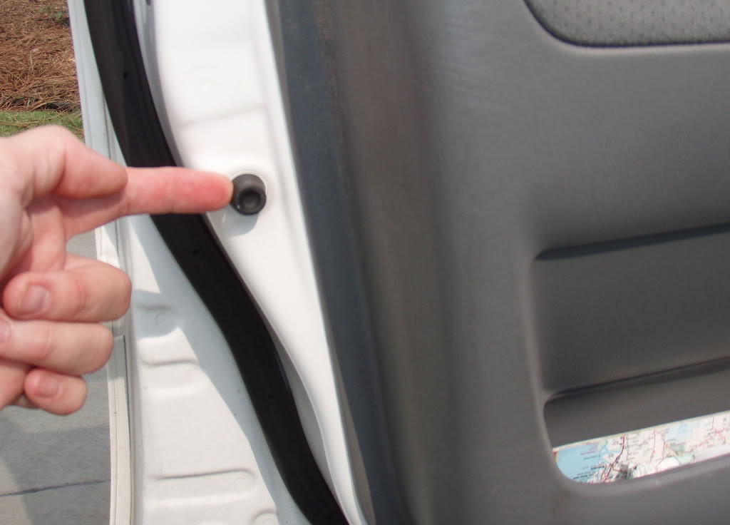

    Not the switch on the dome light. But the switch on the door sill. When you close the door there is a switch that is activated to turn off the light.
    Door light switch:
    Nub on door that pushes switch in:
    Either your switch may be bad or the nub could be missing. Or they are not lining up.
    I hope this helps.
