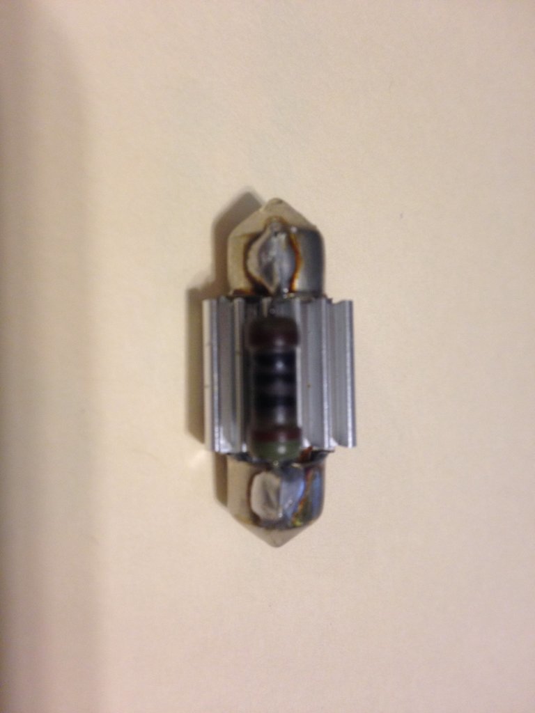

    Does anyone have a picture of one of those resistors soldered into place on the dome light? I'd like to see one before i do it. Thanks!
    -Cody

    You don't solder the resistor to the light fixture, you merely solder it to the two ends of the bulb. the ones that I used were very fine wire and the resistor itself was about the size of a grain of rice. you put it on the back side, away from the LED.
    Here is image of mine:
