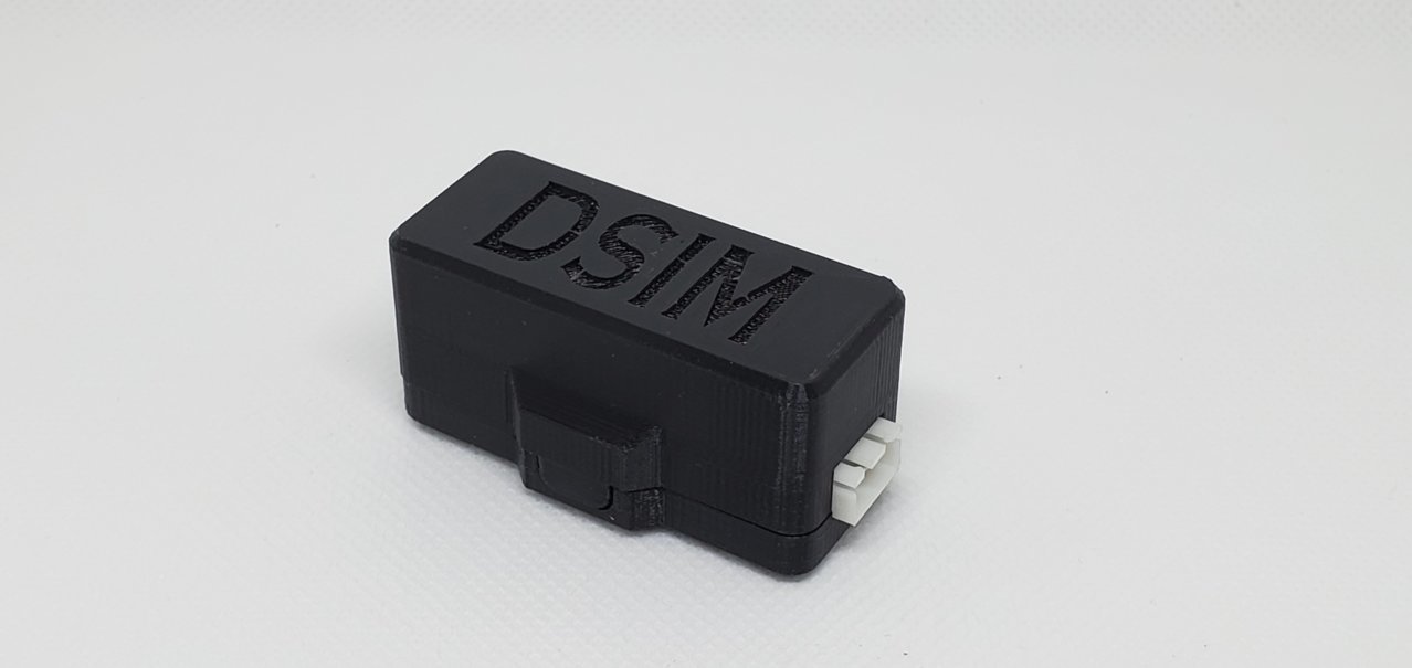

    DSIMs DomeRock Module for Courtesy Rock Lights
    How To Order
    All orders are placed via my website, and this link will bring you right to the bundles: https://dsimsolutions.com/pages/domerock-v4-bundles.
    All proceeds go directly into my rig and subsequent posts here on TacomaWorld. Thanks for looking!
    Product Description
    Add on module to automatically turn on your rock lights in sync with the dome lights on your rig. Upgrade your existing rock lights to be able use your existing switch for anytime activation (great for night trail riding!) as well as activation from the dome lights. With this add-on the rock-lights will illuminate as triggered by the dome light. Unlocking the vehicle, approaching the vehicle (with key-less entry), opening the doors, will all trigger the lights on. Locking the doors, leaving the vehicle for a period of time, etc will turn them off.
    Your dome lights are on a negatively switched circuit. Meaning it is not so simple to wire up in order to utilize both your switch (for anytime activation) AND turn on/off with the dome light. Utilizing a relay in the correct configuration and a few other electrical components allows this module to function properly. If you currently have a rock lights setup with a typical CH4x4 switch or SwitchPro setup this is all you need to be able to add the ability to trigger off of the dome light.

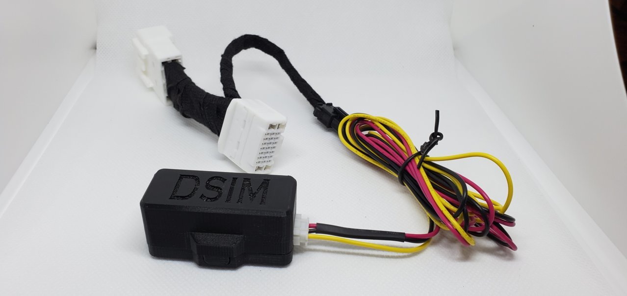

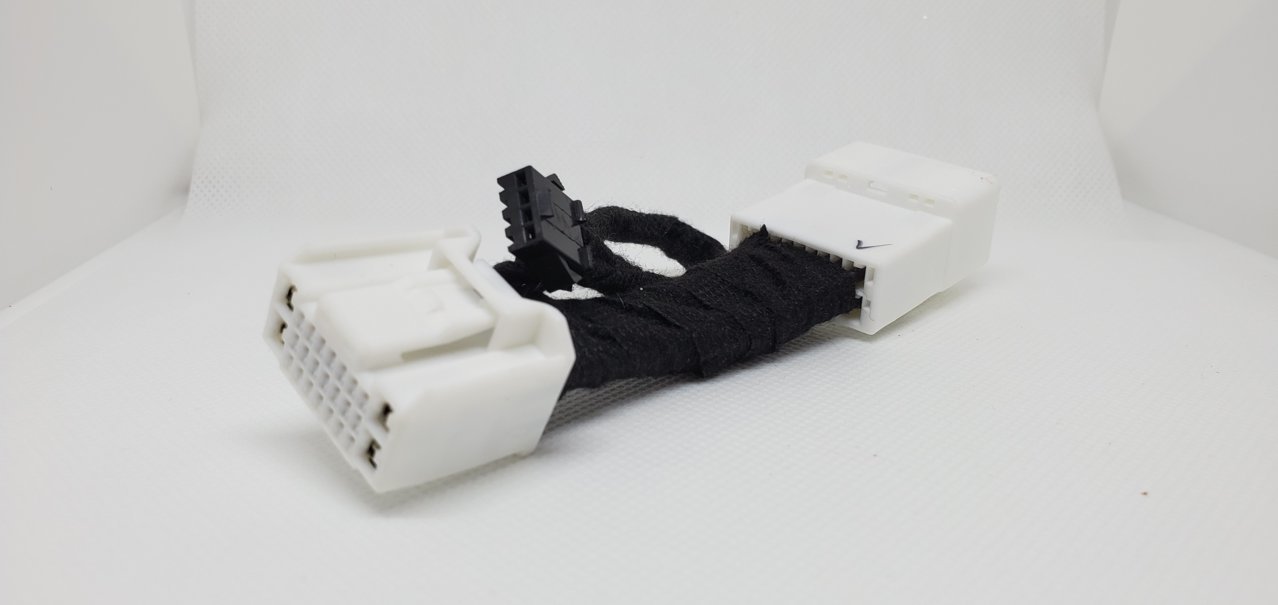

    In V4 there are options for full plug n play harnesses that includes a T-Harness that connects into OEM wiring located in the A-Pillar. The only splice required is into the existing Rock Light Setup!

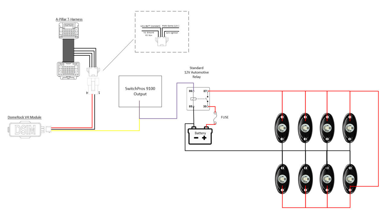

    Installation Information

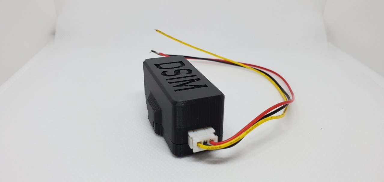

    Harness wires
    Yellow Wire - Output to Rock Lights
    Black Wire - Dome Light Ground Trigger (PWM)
    Red Wire - Fused Battery Connection
    Description
    T-Harness added for Plug N Play Installation. The only wire you will have to tap is your Rock Lights relay activation wire (86).
    Warning
    For both SwitchPros and CH4x4 setups it is strongly recommended that you run an external relay. Depending on the current draw of your rock lights if you hook DomeRock V4 output directly to rock lights without a relay it is possible that the DomeRock V4 module will become very hot when lights are on for extended periods of time. Please follow the diagrams below to avoid any issues.
    Install Video - Hooking up DomeRock V4
    DomeRock V4 Inputs/Outputs
    Wiring Diagrams (Connection to Rock Lights)
    CH4x4 Switch Setup
    SwitchPro Setup

    I have updated post #2 with a wiring diagram. Will be updating that post with the installation instructions.
    But there are only 3 output wires that you need to tap into your existing CH4x4 Wiring.
    1) 12V+ Constant
    2) 12V+ Output (To Lights)
    3) Dome Light Trigger Wire (Yellow Wire in A-Pillar Harness)
