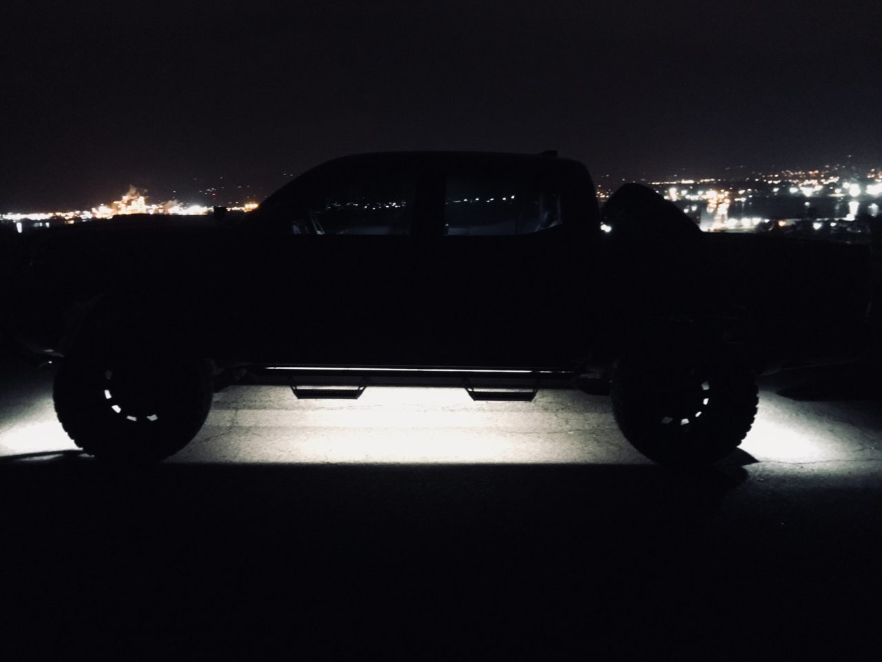

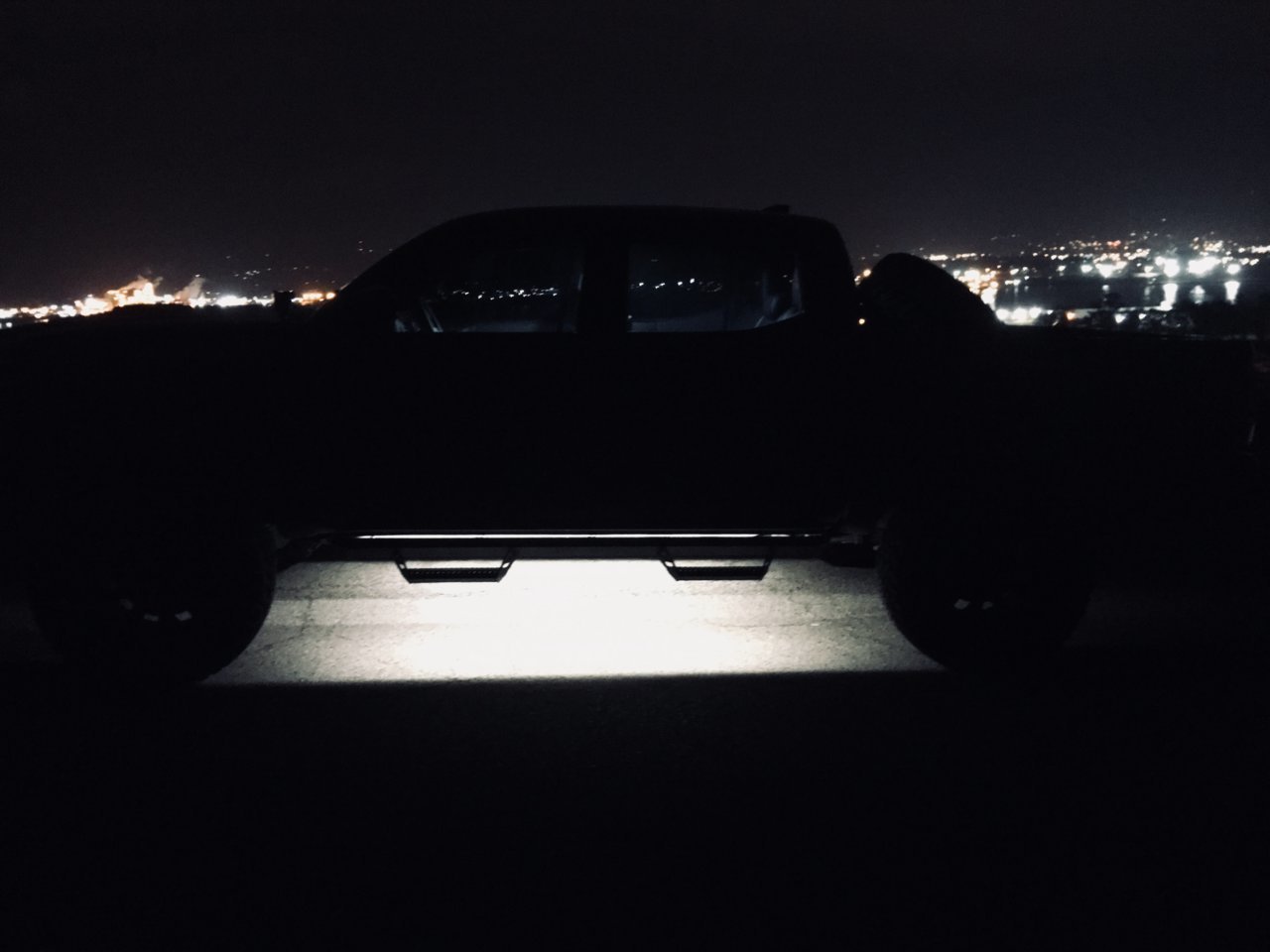

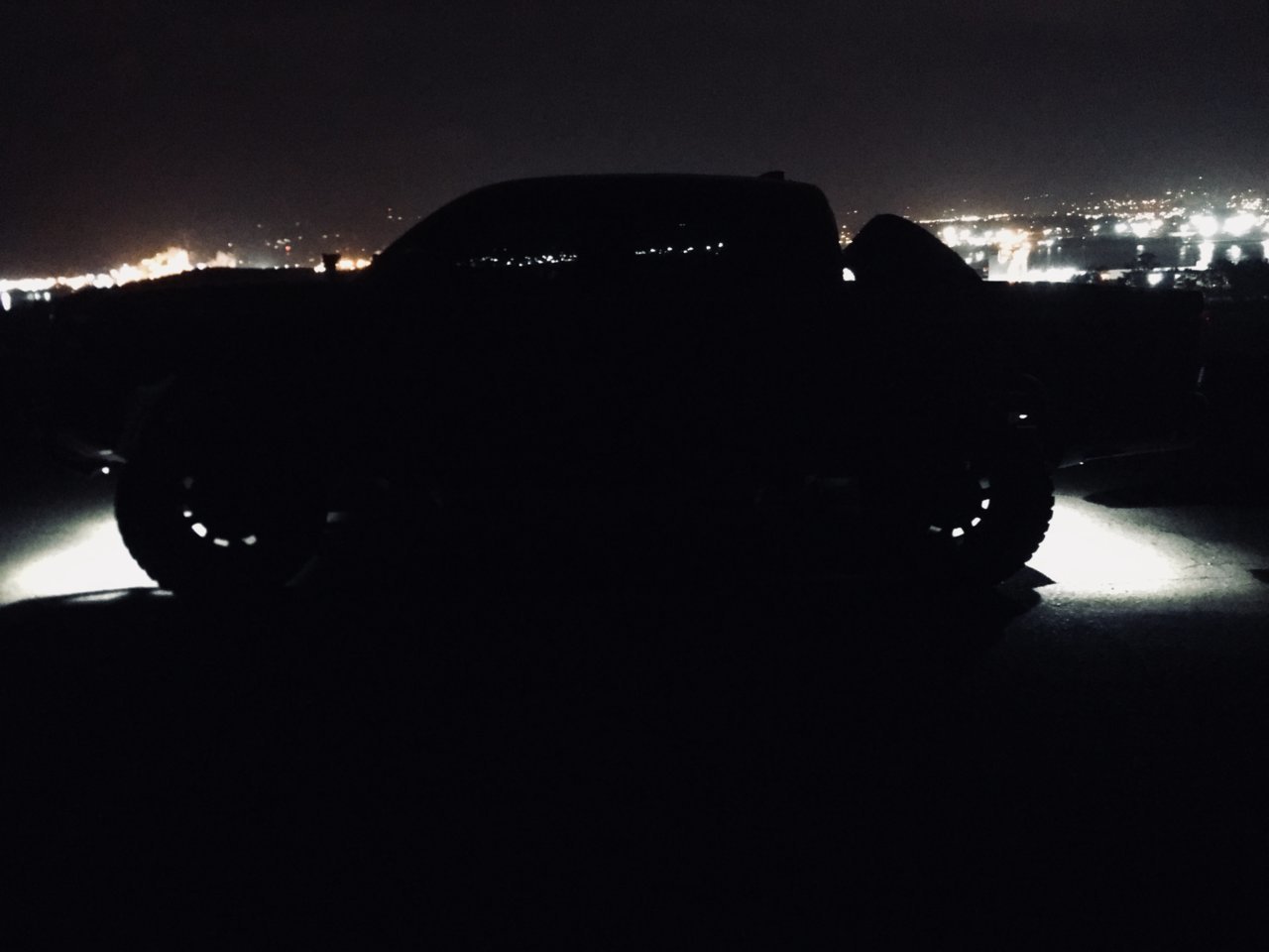

    The only bad thing about the switch pro is that you have to have your accessories plugged into the SwitchPro to use the trigger wires. Not a bad thing at all if that is your plan. However, I have my own switch in my upper console for my Rock Lights/Courtesy Lights. Therefore, I was unable to use my SwitchPro Trigger for the Dome Light function. Instead, I used my trigger wires for my Reverse function and Highbeam Function. Some use the one trigger for the Dimming function of the SwitchPro to be triggered with the Lowbeams. If I were to get another SwitchPro, I suppose I could use the trigger wire on the new SwitchPro for the Dome Light and switch all of my wiring. However, then I would have an empty spot where my current switch is located. I currently have the fade with the Dome Lights now, but if you don’t get this Harness or you want to be able to turn your rock lights on anytime while being tapped into the dome light, this is the only way possible. Otherwise, you have to choose. I could keep my setup the way I currently have it: Rock Lights in the Front and Back on my Switch CH4x4 and my Side LED Strips fading on/of with my Dome Lights. Keeping them separate. Or forget about the fading portion, get this harness, and just have them turn on/off like my other accessories with no fading due to the relay. I chose option 2 bc I want to be able to do both. I want the Side LED strips to come on/off with my Dome, as well as, I want my Side LED Strip Lights to come on/off by my anytime CH4x4 Switch with my Front and Rear Rock Lights.
    Current Pictures with how my setup is now prior to getting my harness to change it.
    Dome Lights/Courtesy Lights (aka Side LED Lights)
    https://youtu.be/YjhyWohjzJs
    Front and Rear Rock Lights By CH4x4 Switch
    How I want it by CH4x4 Switch: Rock/Courtesy Lights
    Walk Around Video
    https://youtu.be/PNEBPSeo8Lc
    In the video you will notice the LED Light Strips fade in and out with the Dome, but in order to have it this way, I cannot have what my ultimate goal is which is my Rock/Courtesy Lights together.
    I hope this helps clear up any confusion and why this harness is needed. I have not played around with my SwitchPro trigger wires as they are already taken and I have a separate Switch in my overhead console already for this mod. I wanted my Hood Lights, Bed Lights, Rock/Courtesy Lights, and Anytime Front and BackUp Camera Switches all together and not on my SwitchPro.
