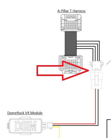

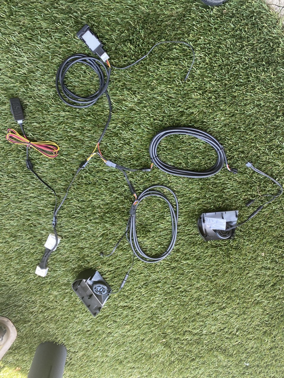

    @DSIM
    about to to the install including the Meso puddle lights on a switch.
    does this look correct to where the module and rock lights Should be in line?

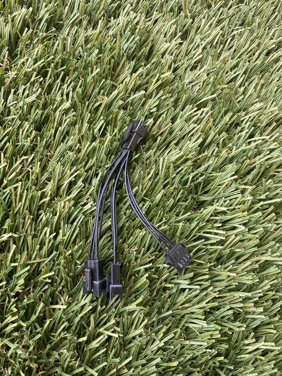

    also I have this extra 3 way connector I can’t figure out where that needs to go

    I believe it goes here... then the puddle pods take the other two dongles, but @DSIM can confirm.

    Ya I agree but I think having the switch changes stuff.
    Now that I’m looking at it maybe the 3 way split is for no Meso switch.

    The three way is in place of the two way splitter, if you didn't have the switch for the puddle pods, since the two would connect directly to the T harness.

    Exactly

    Confirmed. Replaces the 2 way split in mesos kit.
    Thanks for fielding that one gents!
