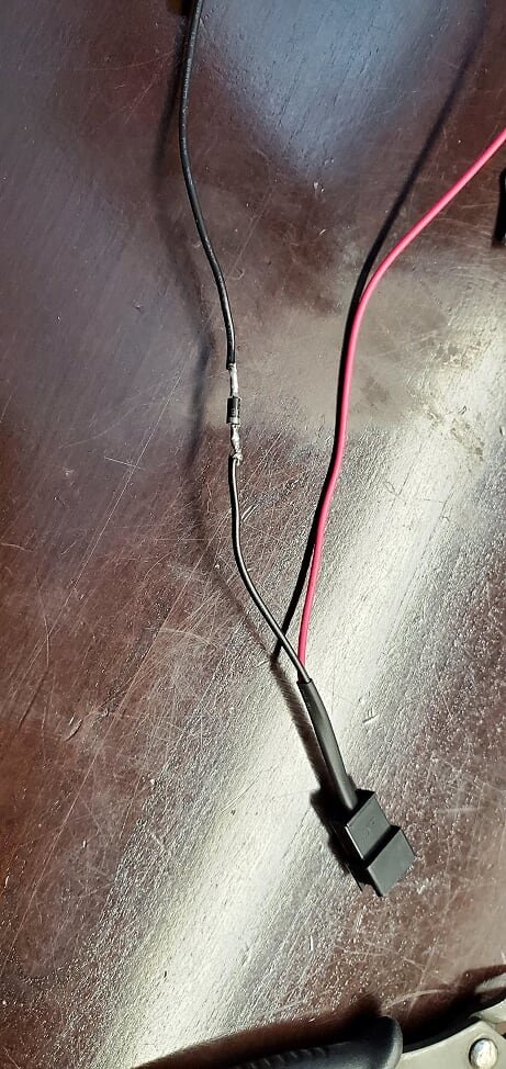

    This is the solution. Diode on the ground (black) wire of the "main harness" pointing toward the black connector that plugs into the t-harness. The capacitor on board must be supplying ground and therefore deleting the fade on the dome light. On V1 I used to diode this wire, but shifted away from it once I went plug n play as it was less of a concern of someone hooking it up incorrectly. Which is why the V1 video you notice the fade :). I tell you as long as I have been making this mod I have never noticed this lol. Great eye to whoever caught this first.
    The two diodes on the board protect against two things mainly. Back-feed into the module from the output wire, and preventing people from reversing polarity (+ to - and - to +) by mistake and blowing up the capacitor (learned that one the hard way). Later on Ill add a third for this. For now temp fix for retaining dome fade is below, just confirmed it on my rig. And I hope it goes without saying but make sure you shrink or tape the wires after adding the diode inline.

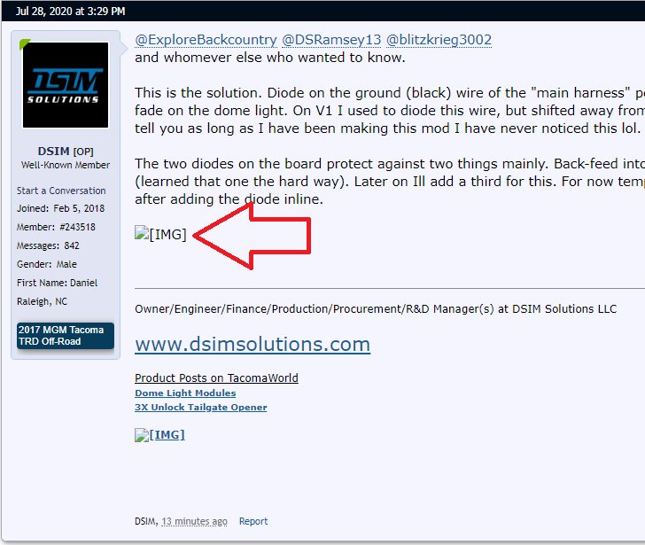

    Is it just me or does the image not load?

    I don't see it as well. @DSIM could you reload your image?

    ps your image is not loading

    Strange. Was showing for me...
    Try it now? I reloaded the image.
