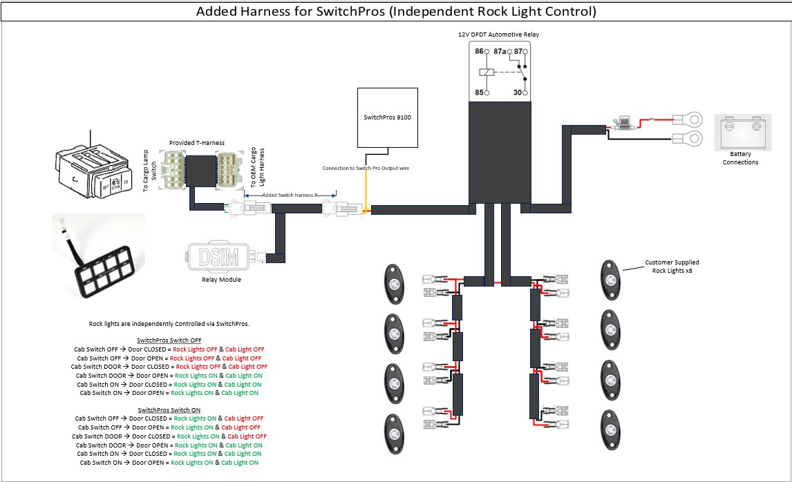

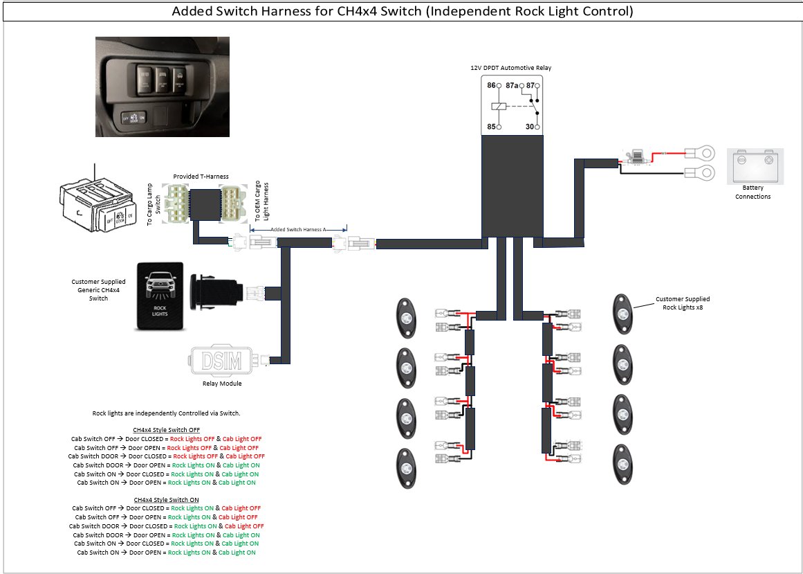

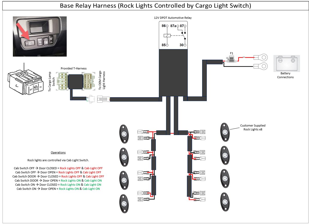

    Been awhile since I posted here.
    But worth mentioning. I am totally wiped out of my T-Harnesses. So only option still available is the universal option.
    However.
    I am working on a full rock light harness with a t-harness off of the Cab Light Switch. The cab light has the same courtesy ground, without the PWM. It will be fully plug n play with the cab light as the switch. There will be an add on harness to run the rock lights independently off of a separate switch. But the harness will be nice, set up for 8 rock lights. No need to build a harness on your own. And the courtesy light mode will be there. Looking to more than just an adder to an existing setup, but also offer the whole thing PNP.
    I think probably another month or so before I have the first batch released. Here's a preview for now. These diagrams are still a work in progress but will give you an idea. Can't decide if I will just add on to this existing thread or create a new one. Will figure that out in the coming weeks.

    Saw the suggested wiring of the V4 module and a Switch Pros 9100.
    I'd like to run my rock lights directly off the switch pros as it's designed (rather than a relay). Can I connect the yellow DSIM wire to the Pink Trigger 1 wire of the Switch Pros in order to get a dome light switched trigger? It looks like I'd have to setup whichever switch to be "battery controlled" per the Switch Pros manual.
    Any reason this wouldn't work?
    This would also give the option of switching whatever else (I think up to 4 inputs) off the domes.
    Thanks!

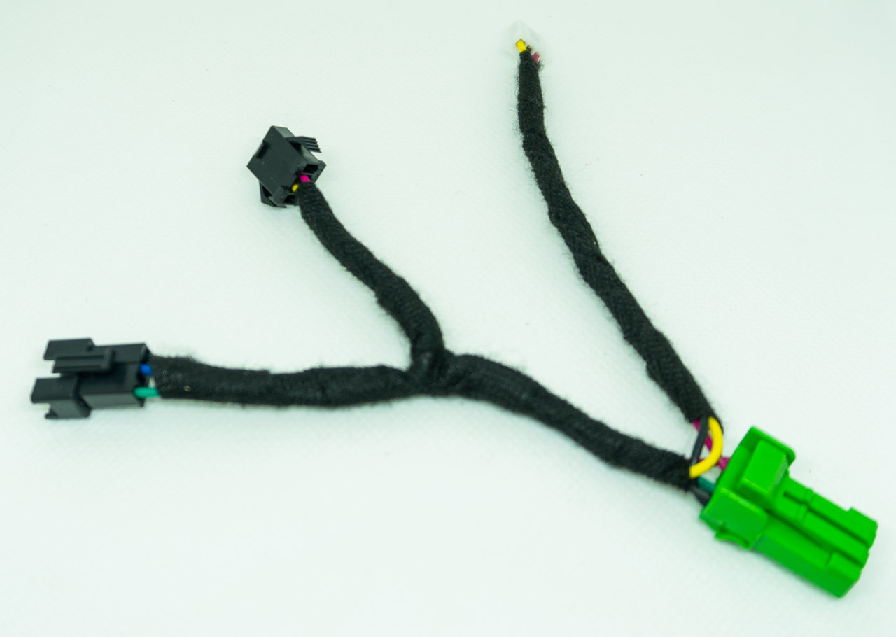

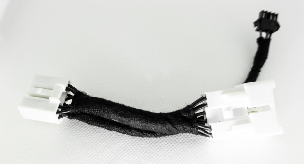

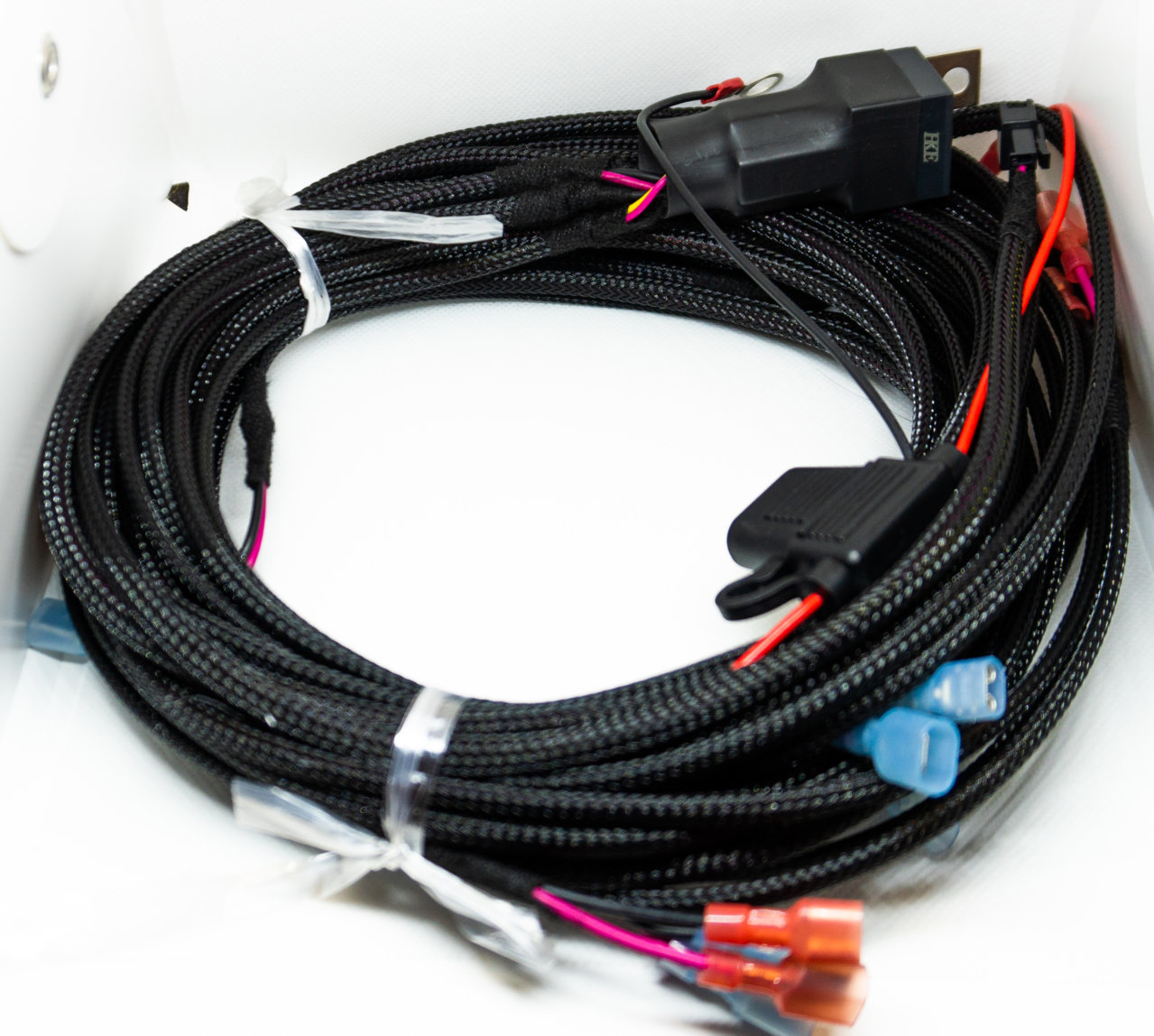

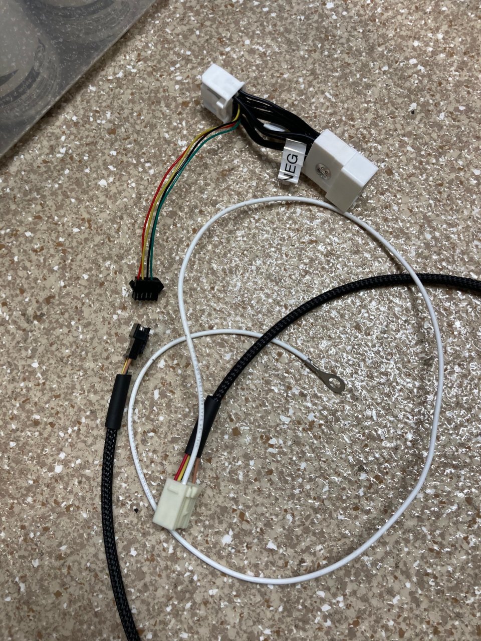

    Hey folks,
    Sorry been hard at work on this next mod.
    To post an update. I have got the prototypes in and installed in my truck. All seems to be working well. I am doing one more test install on a long bed tacoma over the next week or so to confirm the wire lengths. I'll use that time to edit up a video install instruction. Once confirmed on long bed I'll have the first batch start production. Also the pcb boards for the relay module (required for the switch harness / ch4x4 switch) should be in this week and I'll need to model up an enclosure for that. Also need to update the website. So still more steps but getting closer.
    I think I am still a few more weeks out for the first batch. I'll likely create a new thread on it as it is a different product so keep an eye out for that, will post a link when it is up. After the first batch is released depending on how quickly they go I'll put in a larger order for a second round of harnesses!
    Here's some photos.
