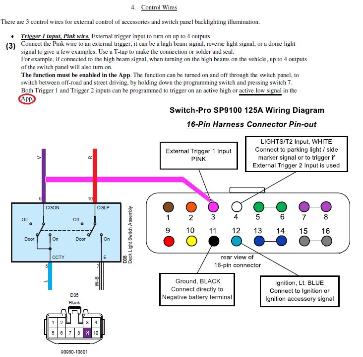

    To emulate this, wire up a relay like so? 12V+ output would trigger the rock lights and the (-) Trigger would come from a fuse tap on the dome fuse. I'd still need an always-hot 12V+ near the cabin fuse block.

    Not sure what your image is of, but I think I've seen @caribe makaira post schematics of what needs to be tapped into. He likely has detailed images to get you started.

    First of all, my hat's off to you and @daveeasa. I encountered your posts in almost every SwitchPro or wiring thread I searched for. I appreciate the expertise you lend on TW.
    I poked through @caribe makaira 's history (saludos!) and came across this post recommending to tap into the jellyfish launcher switch AND set the SwitchPro trigger to active low input. I already have a trigger wire tapped into the [also negative switch] dome fuse so I'll try changing my SwitchPro settings to trigger on an active low signal first. If the dome light fade in/out messes with the trigger, I'll petition @kmorgan3 for their cargo switch intercept harness.

    While appreciated, my posts are nothing compared to theirs. I'm not sure how the trigger works with the SP, but I imagine fading does not work. It will likely turn on and off as desired though. I'm personally a fan of the fading myself.
