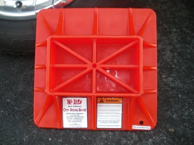

    I hear ya man... My 3 ton floor jack won't lift my truck at the frame, only under the diff. My highlift is useless until my sliders get here, but that thing is a widow-maker last resort, and I even know how to use it properly. I have the highlift base too and I think that might work with the oem bottle jack, on the street maybe, but I tried to cover all bases.

    I've seen those work well to stack rocks for traction. For changing a flat, you'd need to carry a jack stand and 2 highlift bases, in case you are on soft ground, to be safe.

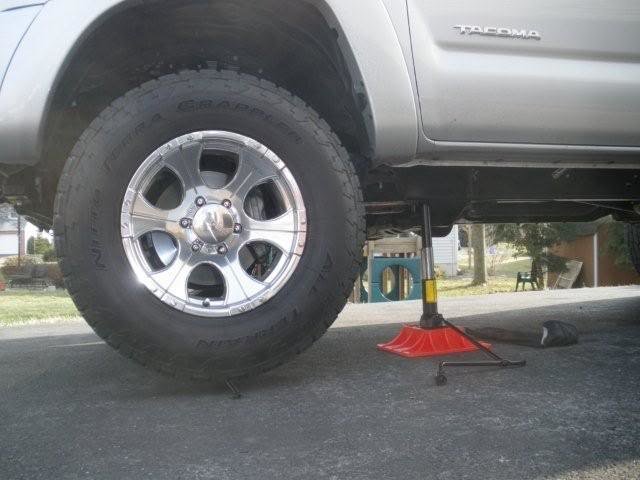

    The high lift base works great with the Oem bottle jack. I thought it would which is why I bought it, just never went out and did it. The rear is easy too because you lift under the axle, plenty of height available out of the bottle jack. I probably could have gone higher in the front so I think it would work well on the trail.

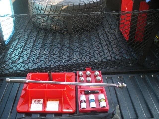

    If you don't have a Full Size aftermarket spare and rely on the Oem spare under the bed, but have switched to aftermarket wheels, grab 6 of your old lugs plus sockets for both the Oem lugs and your new lugs. Don't forget your lug key if you have it. A breaker bar is very helpful.
