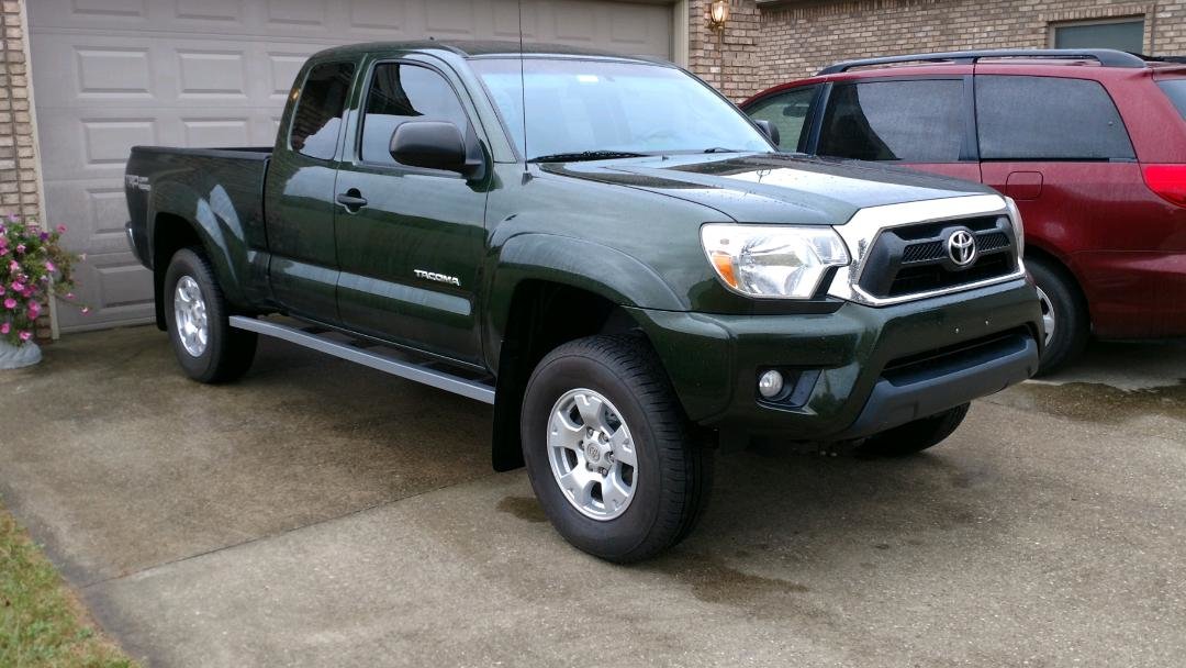

    2014 Spruce Mica, TRD Off-Road, 6 Spd Manual
    Sliders, Tailgate Liner
    2014. Yes, it has a manual transmission.
    Armed in Utah and BassAckwards like this.

  12. Nov 13, 2020 at 5:03 PM
    eon_blue
    Mar 4, 2016
    #180213
    69,632
    Azusa, CA
    Best color too
    winkel[QUOTED] likes this.
