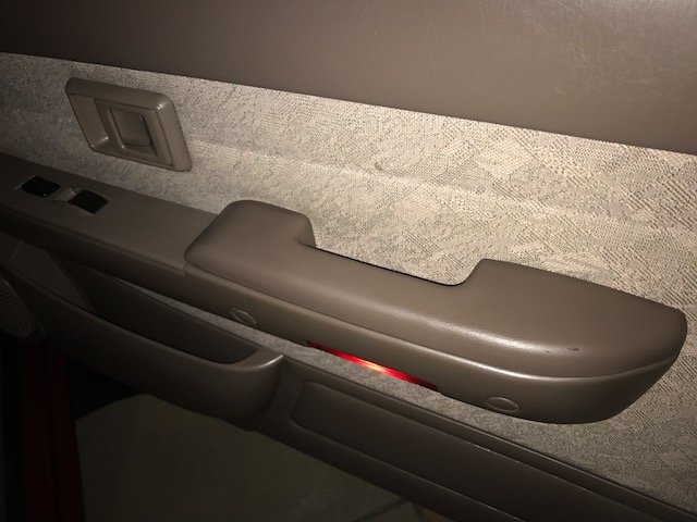

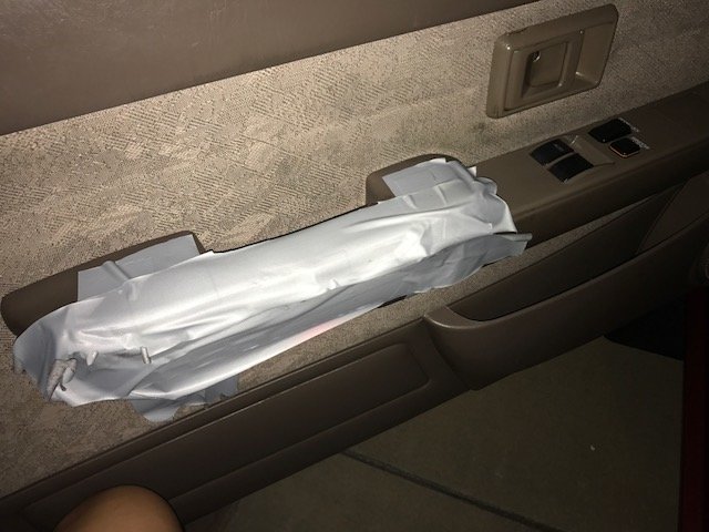

    Bringing this back from the past. I need a replacement/repair for my driver side arm rest pad. Any help/suggestions? Have the same exact color w/ power windows as TacoBill35 has with the same damage. Any help is greatly appreciated. Including pics of my my good one on passenger side, and my damaged one. IMG_1223.jpgIMG_1222.jpg

    I just replaced my door panels with ones from an 01-04 to solve that issue.

    Can't seem to find one.....been looking for 4-5 weeks EVERYWHERE. Will the 01-04 ones w/ power windows swap right in??

    The window switches are different, so you would need those as well. Also the speaker size is different so depending on your setup you might need to trim the backside. They do mount the same way with the push in tabs though.
    I found some on car-part.com in illinois and got them shipped to me for a total of about $130.

    I believe this is the part number you need..
    74220-35010-E0

    Interior door panels come up all the time on Craigslist for $50 or so. You can sometimes get a whole door for $150 and sell the rest of it if you need to.

    Pull the panel.
    Remove the entire armrest.
    Drop off at local upholstery shop for repair.
