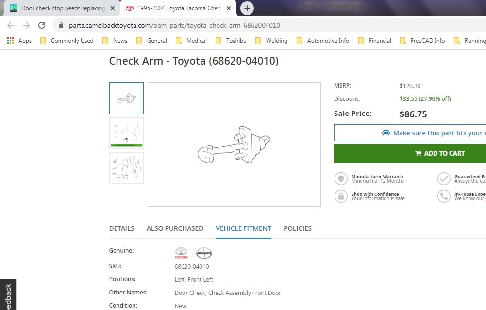

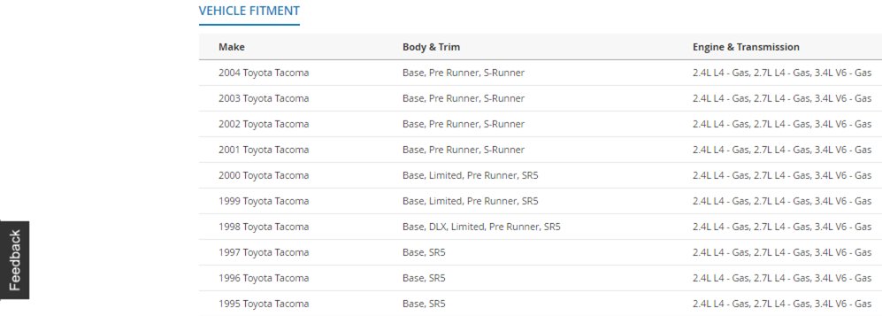

    The Manufacturers part number in the Amazon add has been replaced by a newer number. If you look at the Camelback page for that number and scroll down to the "Vehicle Fitment" section it does not list 1st gen trucks. I don't think that is the correct part number.
    https://parts.camelbacktoyota.com/oem-parts/toyota-door-check-686200c023?c=cT02ODYyMC0wQzAyMQ==
    I think it is:
    https://parts.camelbacktoyota.com/oem-parts/toyota-check-arm-6862004010

    When I click your second link, at the bottom of the page is a link that says "5 more fitments". It links to "javascript:;". Looks like a broken link to me. Can you confirm this for me? It'd be nice to see what else the door check fits...

    Tried to link again, but below is the info copied and pasted:
