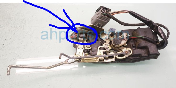

    After many many handle replacements on both my tacomas I kept thinking there must be a better solution. After my most recent handle replacement I decided to take everything out of the truck, clean and lube and re-install hoping that would prolong the life of my 3rd Dorman drivers side exterior handle.
    As I studied the mechanism and the many moving parts that make our doors work this little spring caught my eye. I realized it "assisted" with opening the door lock once you pulled up on the exterior handle. So I went to Lowes, picked up a spring slightly larger but similar in size (had to modify and shorten to make it fit) and now when I open the door I swear it could be done with half a finger! its crazy how different the door feels. No more feeling of bending plastic when i pull on the exterior door handle.
    This mod cost me $3 and about 45 minutes of my time and I am very confident I wont have to replace any more handles in the future. If you keep breaking handles.....the next time you replace one, do this!!

    Does the posted picture show a door handle for power locks/key less entry?
    I don't have power anything in my truck so my door handle is much less complex. Wondering if the same could be done for mine with the spring....

    Should be the same

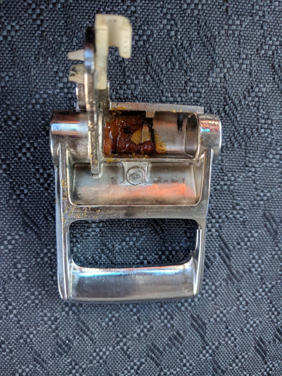

    The best mod I've found for the interior handles are old 80's/90's camry handles. They are metal and it's a simple swap. Just remove the plastic handle grip from the surround and replace with the newer metal one.

    I just wish I could retro the older metal exteriors in place of the plastic ones.

    You have a part# for that spring?

    New spring is stronger than original?
