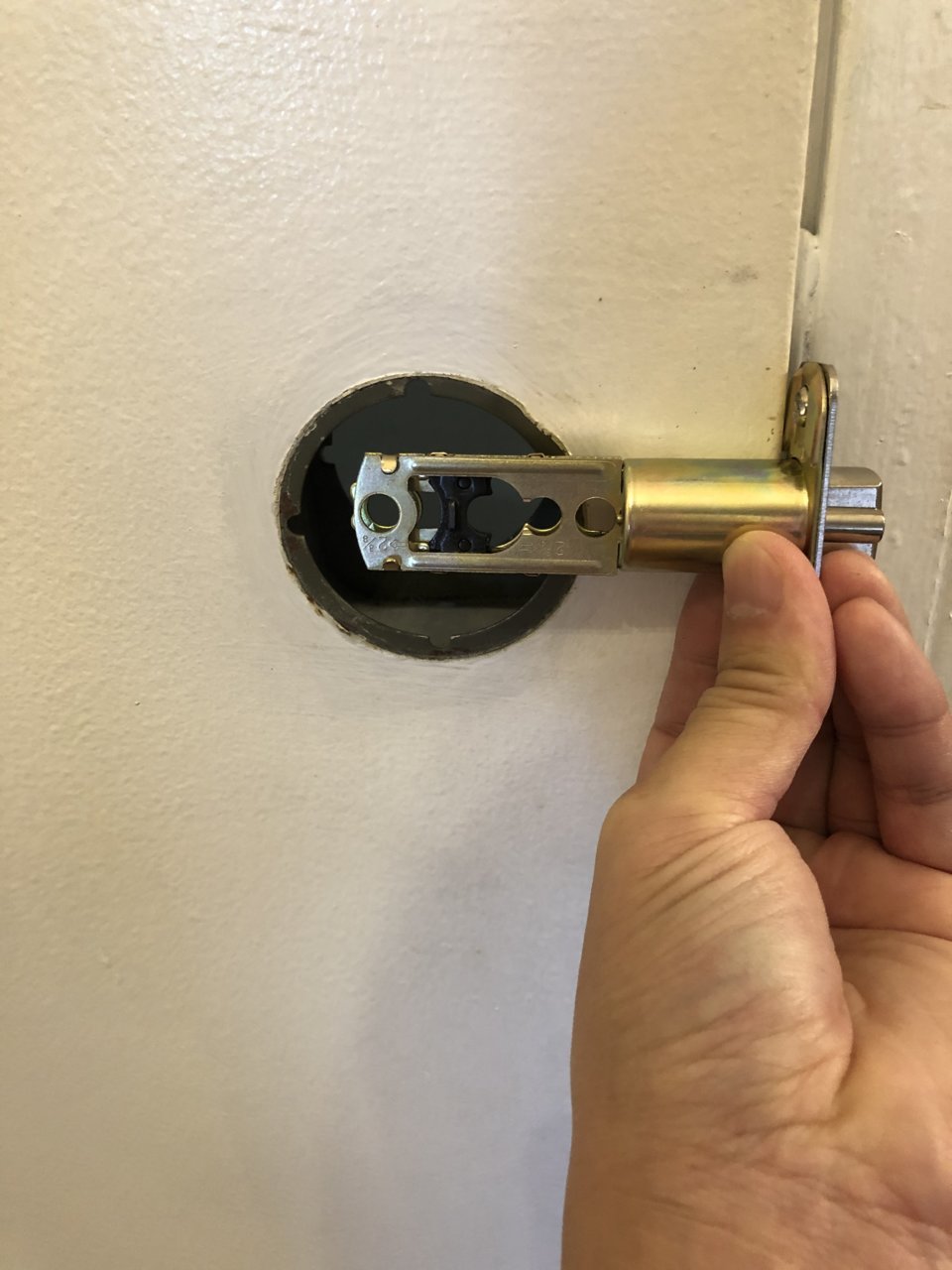

    Sounds like someone didn't prep the door correctly. I have seen like a 5" backset on a door knob (like way old school) and we have ordered some ~3" extensions to make a standard latch work. If it is in fact 3" instead of 2 3/4" you should probably buy a jig and redrill the hole, then get a wrap-around or some kind of beauty plate to cover the gap.... I'm a locksmith btw...
    Oh you may also be able to mortise/chisel out 1/4" on the door face where the latch goes so it will line up, and then just build up your strike (maybe stack 2 strikes on top of each other) on the door jam so the latch still engages

    Not sure what prep is involved but here’s a pic with a standard dead latch
    as you see it’s off and measured center of hole to edge of door and it’s 3 inches

    5,148
    '06 4.0L Tacoma TRD Sport
    Stock, 4WD, Access Cab, White,
    Sounds like a new door.
    Where is the previous latch??

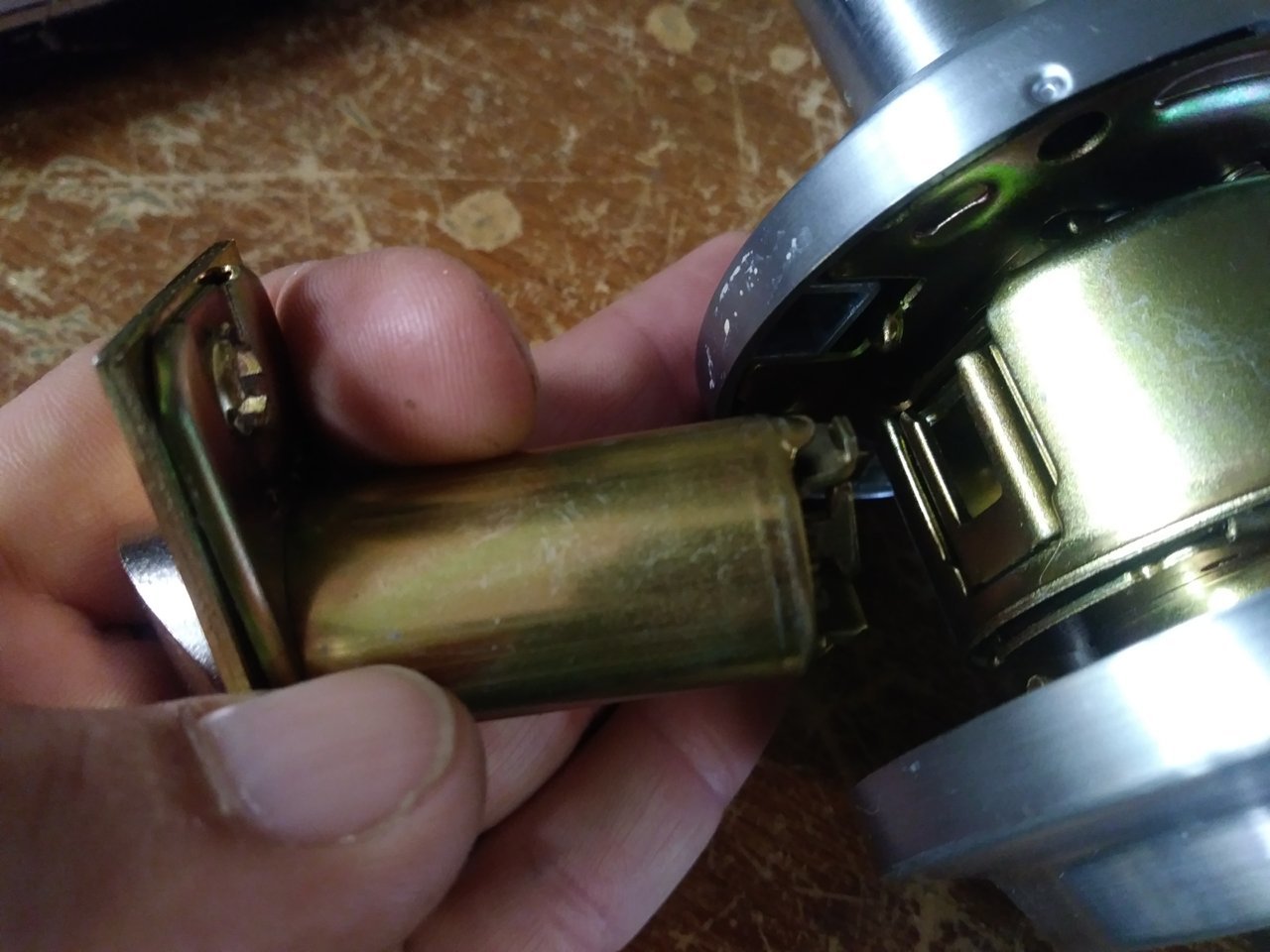

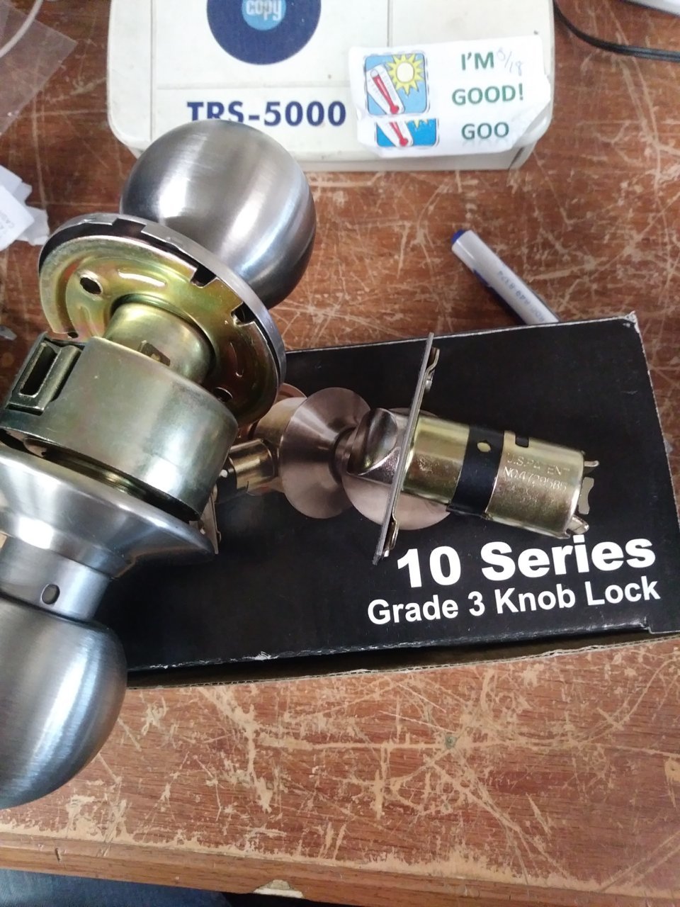

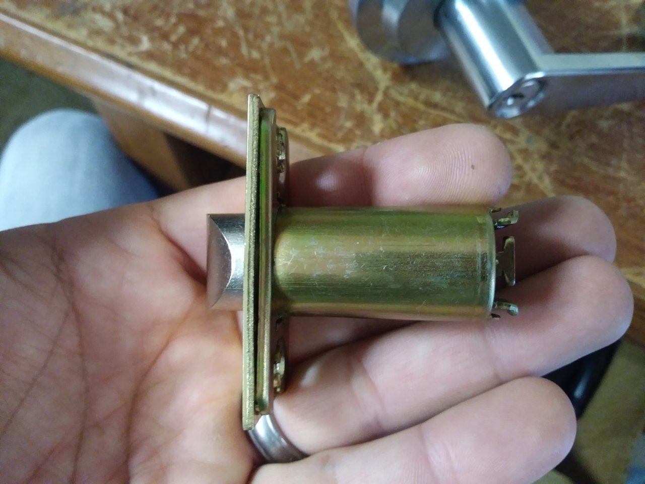

    I feel like that was a commercial door and most likely had a latch system like this. The knob or lever engages the end of the latch instead of going through it like a residential knob.

    bingo thats what it looked like.....any suggestions?

    Find a local locksmith and get a grade 2 knob or lever... There actually is a grade 3 (residential) set... LSDA called it a "10 series" and it works the same way
