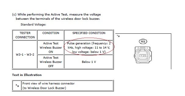

    Thinking about it...you might want a shorter sound, so there's no overlap on a double beep(unlock).
    You might have to monitor the different frequencies it might be receiving, to assign seperate sounds to them; if it's capable of that.
