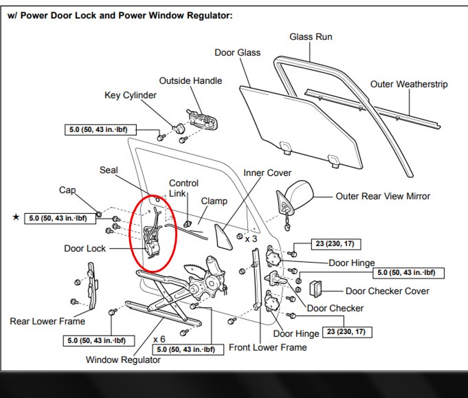

    Not sure this is the route you want to go but it’s pretty expensive. I’d take it apart and see if it’s something you can fix yourself. My 2nd option would be is to call a local pick and pull and see what they would charge you. There is an online pick and pull exclusive to Toyota’s in Northern Cali. They’re fairly priced.
    Genuine Toyota 69040-04010 Door Lock Assembly https://www.amazon.com/dp/B00G0LZJEU/ref=cm_sw_r_cp_api_i_nPCIDb11JP4MW

    The lock actuator is an expensive part. Better to properly diagnose the issue before diving that far in. Do you get a grinding noise when locking with the fob/remote? Does lubricating the keyhole improve the stickiness?
    Pain in the ass getting all the rods on the actuator disconnected and reconnected, but otherwise straightforward. You might also consider getting some plastic trim removal tools and replacement plastic clips for when you remove the door card. You'll be less likely to break the clips if you use the tool.
