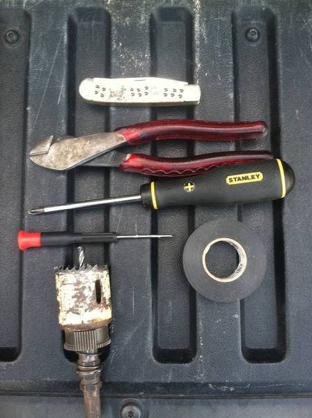

    Tools: drill, hole saw, wire cutters, screw driver
    Supplies: tweeters, zip-ties, glue, electrical tape, (beer?)

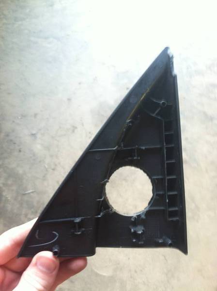

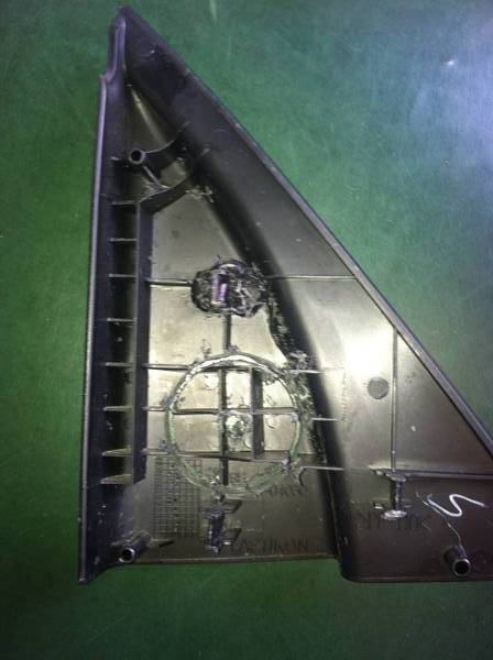

    I then got a 1 and 3/4" hole saw and cut a hole in it:
    I cut the center of the hole here:

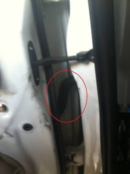

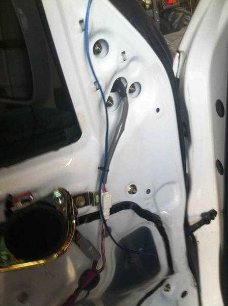

    Since I already had a wire ran up to the top of the windshield, where the tweeters were, i used the same wire to pull through the door up to the tweeter. i removed the kick panels and door panels (the directions to remove the door panel are on here somewhere) I ran the wire through this rubber hose with the factory wires to the mirrors, window switches, etc. :

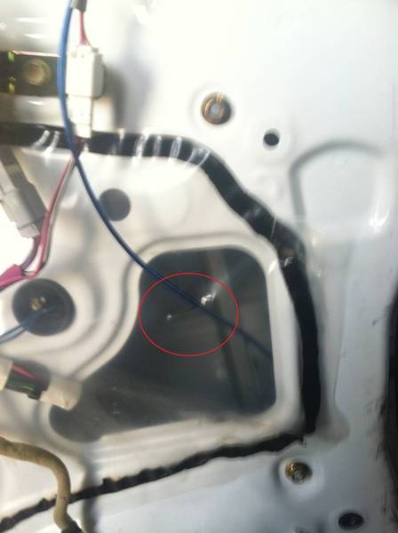

    I then cut a slit in the thin plastic on the door and pulled the wire through it:

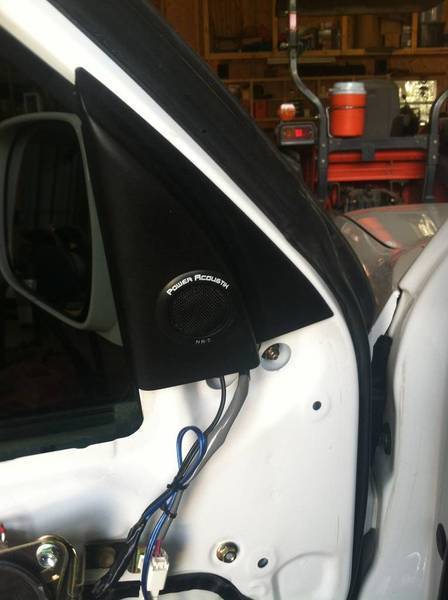

    Then I secured the wire to the power mirror wires with zip ties:
    Then I hooked up the tweeter and test fit it:

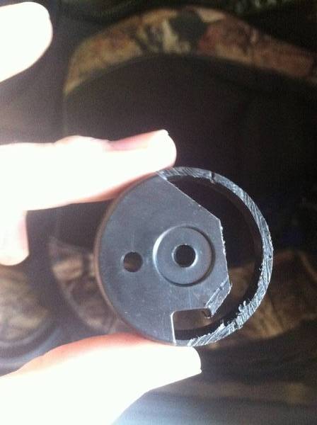

    I did have to trim the back of the tweeter mount for clearance:
    Another test fit and it was perfect.
    Be sure when putting the panels back in place to not pinch any wires.
    Then I replaced all the panels popped everything back in place. and I was done. Much better i think.

    A picture of the things i used:
