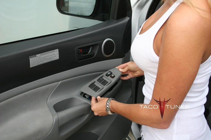

    I was able to fix the issue in about 10 mins. Its really simple! Just pop off the plastic piece that holds the door lock and window controls, and youll see plainly a bunch of white powder where the plastic rubs (thanks again @GPsevinSixx) and from there just stick on the felt.

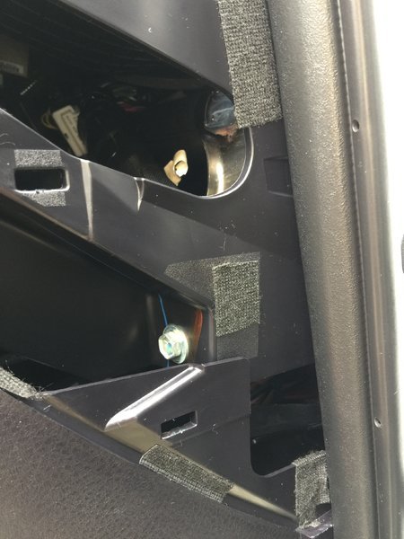

    Good to hear you got it off. That stuff might work temporarily as they're much thicker. Try this stuff on Amazon:
    https://www.amazon.com/Tesa-Fleece-...88298631&sr=8-2-fkmr1&keywords=tesa+felt+tape
    There's this JVCC stuff also for single roll, but I'm not sure about the details on this since I haven't used it. But it is a polyester felt tape.
    https://www.amazon.com/JVCC-FELT-06...88298631&sr=8-1-fkmr2&keywords=tesa+felt+tape
    Cut to size and place this directly over the parts where you see the contact points to isolate future rattles and buzzing of the panels. I use the same stuff on my interior panels from my dash rattle thread.

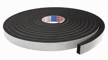

    tacomaspeakerinstall_IMG_398003.jpg tape.jpg I used 1/4" thick 3M Foam Tape around the bottom edge of the panel and it worked killer...:cheers:
