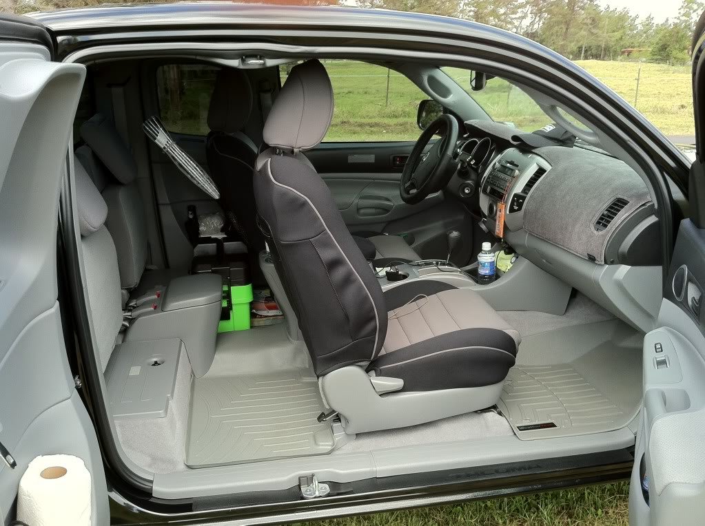

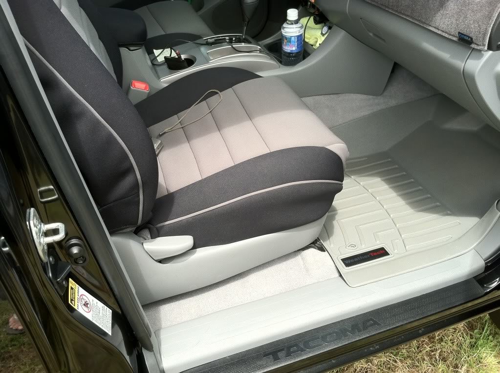

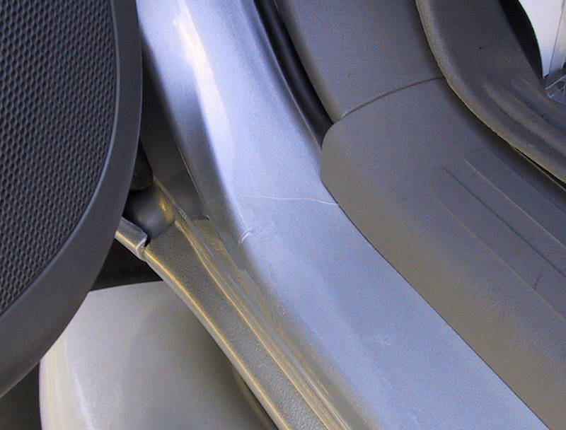

    I'm going with something a little different for door sill scratch protection. I'm running a long strip of clear vinyl along the entire door sill, front to back and from under the trim to about an inch down the rocker (ie outside the door). For the most part you can't see a damn thing...which is the point, but it makes for bad pictures. In the picture I posted above you can see I had the factory door sill protectors, I've peeled those off to put down the clear vinyl but may apply new adhesive to them and put them back down on top of the vinyl.....not sure yet. Here's a picture of most of the drivers side, at the very front you can see the edge of the vinyl:
    A close up of the front edge:
    And a close up of the rear edge:
    This stuff is not easy to work with, you need patience, a willingness to scrap it and start over, more patience and a heat gun. But I think it's well worth it.

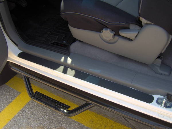

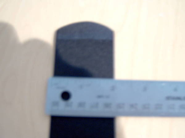

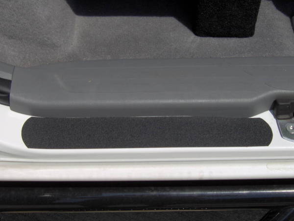

    After reading this thread, I decided to do a home-made type mod for this to prevent scratches on the door sill. I did not want to pay a lot and figured it would give me something to do.
    I searched all over for "vinyl grip tape": Wal-Mart, Northern Tool, Home Depot, Lowes, etc... All I found was the sandpaper like type grip tape, like on skateboards. This would be good, but I didn't want it rubbing on the rubber door seal over time. I wanted something less abrasive...
    Then i got the bright idea :D- a boating supply store!! Lo and behold, I found a vinyl type grip tape that has a textured surface, but not sandpaper like which would do the trick. West Marine had it in a roll 2" wide and for like $16. It is enough to do 2 access cab trucks...

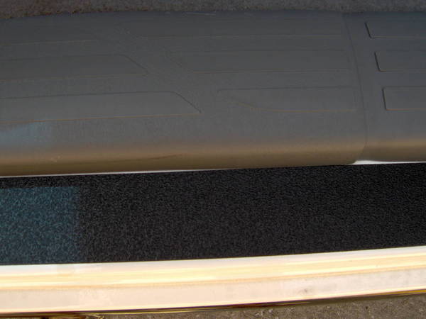

    I measured and cut to strips for each side as shown in the picture. Then I used the pictured can can to round the edges and cut. Alcohol prep and dry and stuck it on. Of course, I did this right before the pictures that show how to remove the sill were posted so i put mine on without removing the plastic sill and there are small gaps that show as you can see in the pic. Not enough for me to redo now, but before I trade the truck in for a 3rd gen in 5-6 years I will redo.
    See the minor gap

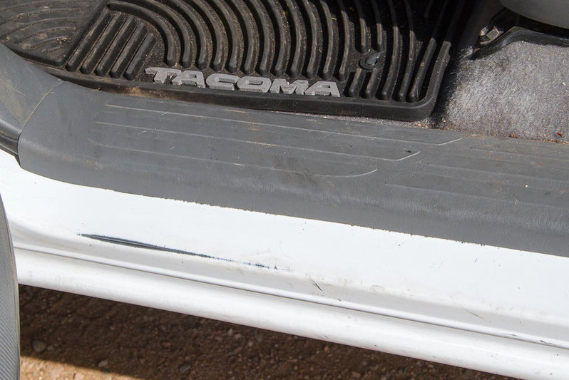

    Here is what you are trying to avoid. My 2006 door sill at 297k miles today. After this pic I hit it with some primer and will hit it with Duplicolor after the body shop wanted $250 to spray it.
    I am going to apply the Toyota sill protectors going forward.
