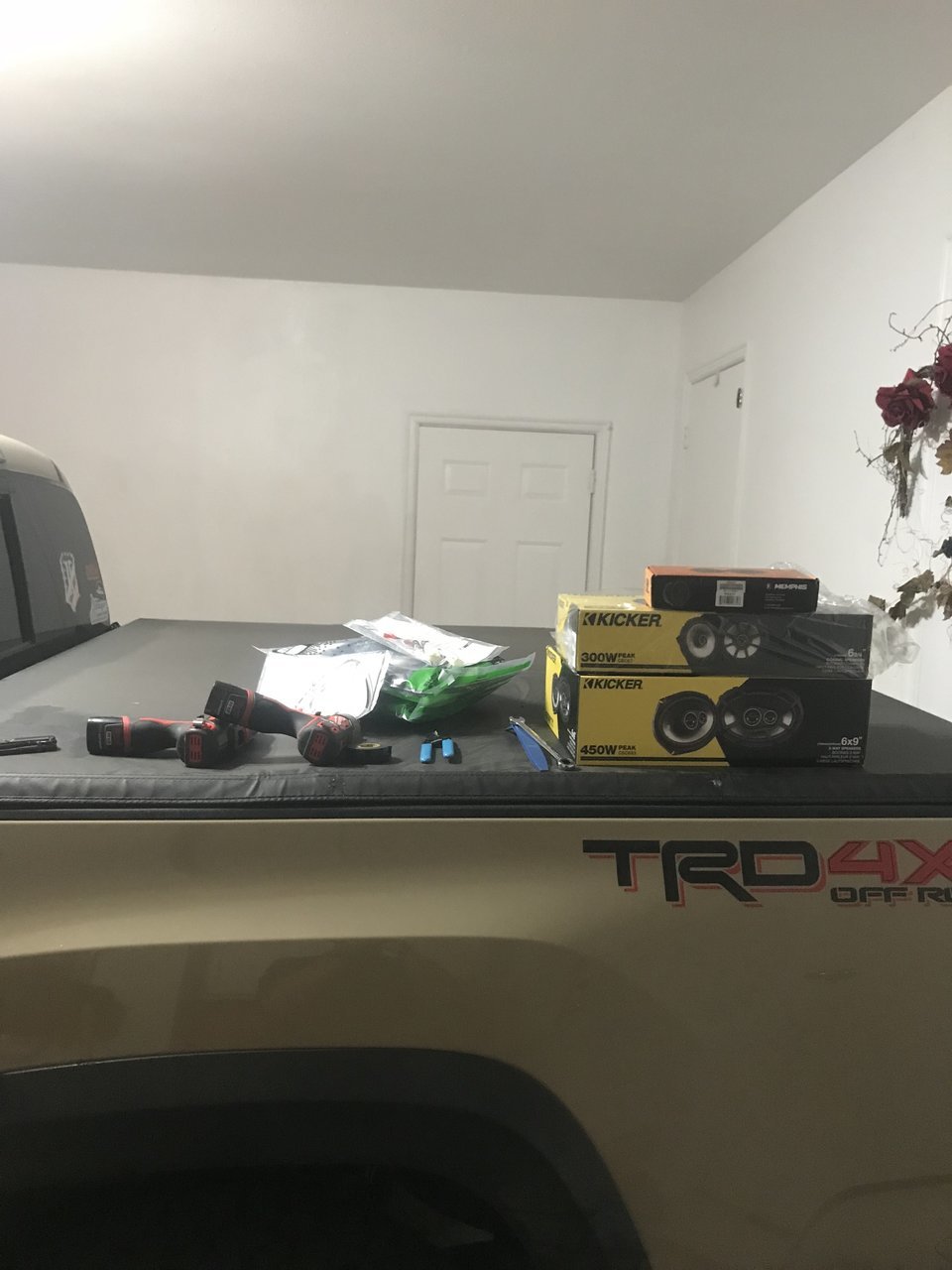

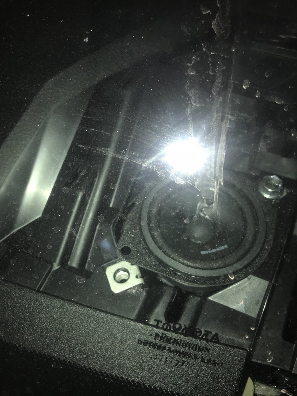

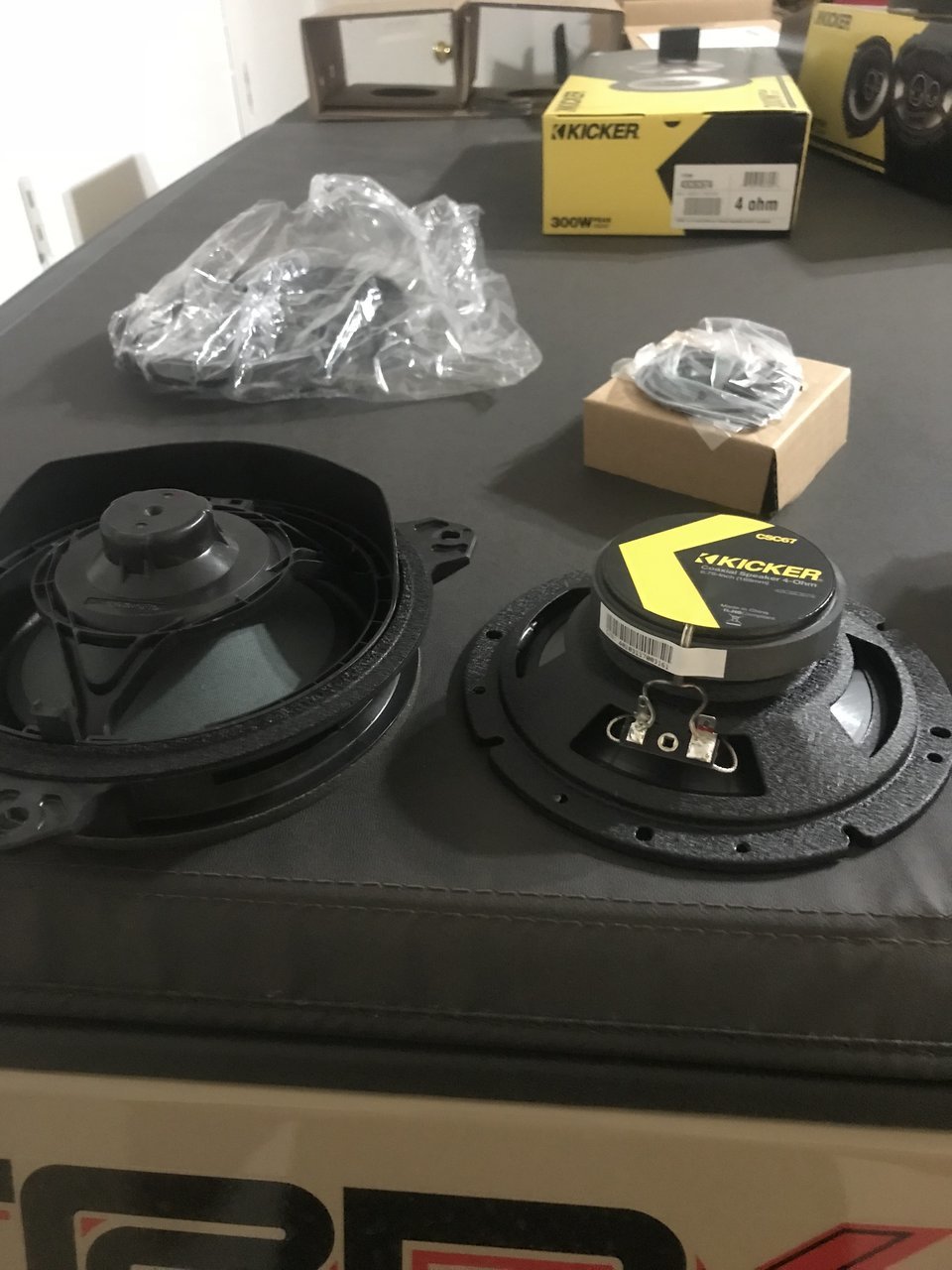

    So I finally bit the bullet and replaced my stock speakers with some Kicker CS series 6x9's up front and 6.5's in the rear. For such a simple upgrade it is defiantly worth it. However I ordered all of my stuff from Crutchfield and for some reason I am not really impresses with the adapters I got. I realize I got them for free but they are just not near the quality I have seen in the past, none of the holes lined up for the door bolts or to mount the speakers to the adapters. But besides that everything minus the tweeters went smooth, they are just plum the wrong size and they didn't send me an adapter so I had to butcher the driver side together and there isn't nearly enough slack on the passenger side to cut and splice wires so its still stock for now. But here are some pictures if how the aftermarket compares to stock! The only thing I need to do is order an adapter for the tweeters and take my front passenger door off and try and find whats rattling but it was 65* yesterday and now its 20* so it can wait a few days if needed. I am in no means a pro at audio stuff but this only took me an hour with the exception of screwing with the tweeter which I'm still not sure I wired it correctly so if someone knows how it is suppose too be done please let me know!

  4. Feb 10, 2018 at 2:54 PM
    tnel12
    tnel12 [OP] Well-Known Member
    Oct 30, 2017
    #234610
    294
    Oklahoma
    2017 QS TRDOR SB
    icon stage 2, icon rebound, wildpeak at3 285/70/17, rago fab light bar, Cali raised led fogs
  5. Feb 10, 2018 at 2:59 PM
    shakerhood
    shakerhood Well-Known Member
    Aug 9, 2015
    #161370
    37,079
    Southern Ohio
    2017 MGM DCSB Off Road, 6 Speed MT, P&T
    Thats what is so nice about the Subaru Tweeters, they are a direct swap.

    I 100% agree with you that the adapters are an absolute joke.
  17. Feb 10, 2018 at 5:50 PM
    #17
    shakerhood
    Aug 9, 2015
    #161370
    37,079
    Southern Ohio
    No kidding, the magnet is like the size of a Quarter, it's amazing any sound came out of them at all.
