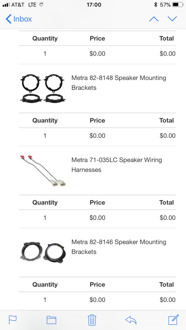

    I got kicker 6x9’s up front and 6.5’s in the rear. They both required an adapter to fit in the absolutely massive factory holes. I also got adaptors to make them plug and play with the factory speaker connections. Very simple install all in all. My kicker tweeters are on the way and should be in tomorrow which are a 100% plug and play install.

    I ordered the tweeters on Amazon which are on the way. It just amazes me to need adaptors and the such. Last speakers I put in my Dodge were complete plug and play. I guess I will need to do some reviewing before I replace my door speakers in my 17' OR.

    That’s what you need if you go with the sizes I did. Regardless you will need 4 if the wire adapters.
