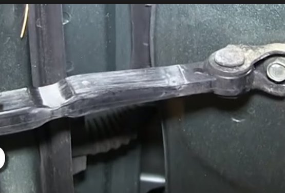

    It could be that the door stay, or door stop limiter - whatever - is broken. There is an image of it in today's postings. The door stay is the little arm between the door and the door jamb. It's screwed to the jam and goes inside the door. On the end is a spring mechanism and (I guess) a cam with a detent. When it is working properly, the cam and detent work to hold the door open in an "open" position and if you open the door more, the cam will hold the door in the "wide open" position.
    That's how it worked with my 1998 TRD until one day a wind gust caught the driver side door while I was getting out, blowing the door wide open and breaking the cam mechanism. Since then I have to be very careful 'cause the damn door closes with every tiny little breeze.

    Agree with all comments above. I told someone who rode with me it was a Toyota Option...... Automatic Door Closer.
    This is the offender. The bump in the door check becomes wore down and won't hold the door open anymore.

    I wonder if they're side specific. My passenger door stays open better than the driver side door.
    I think I saw a thread where someone built it up with JB weld and then very gradually took off a little at a time until it worked again.
    What I do is stick the socket I carry around for the big hub nut you have to remove to replace the CV axle into the space between the door and the truck. For some reason I bought a 3/4" drive socket so it has a 1/2" to 3/4" adapter in it which makes the whole thing a little bit longer.
