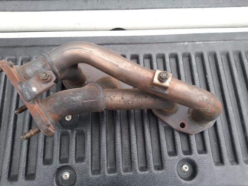

    just buy a stock oem mini header manifold, its heavy duty steel and isn't cast crap and it will NEVER fail again.
    the 01-04 trucks use these mini header manifolds and they will bolt right onto your engine and the lower collector pipe as exact replacement.
    don't waste time bringing it to the shop for another cast crap manifold that will just crack again in a few years as they all do.
    this is what you want to put on it:
    try here if you cant find one local: http://www.car-part.com/cgi-bin/search.cgi?userSearch=int&userPID=1000&userLocation=All+States&userIMS=&userInterchange=BF>@C&userSide=&userDate=2002&userDate2=2002&dbModel=73.26.1.1&userModel=Toyota Tacoma&dbPart=327.1&userPart=Exhaust Manifold&sessionID=200000000000000000865586305&userPreference=price&userZip=70068&userLat=30.1499&userLong=-90.4621&userIntSelect=1622006&userUID=0&userBroker=&userPage=1&iKey=
    and I wouldn't pay over $100 for one personally, when I had my 99 with the 2.4 I bought mine for $60 shipped from someone here in the for sale forum. I think they only cost about $150 new from the dealer
    if I were you I would put your old one back on to use until you found one of these mini headers to put on it. another note is look for the header from 2.7 engines since I think the 2.4 engines all used the cast ones but the headers are exactly the same and are exact swap outs

    Yip take keakars advice on this one!! Any of those cast ones would likely just fail again and prolly sooner than the stock one... the oem miniheader is the only way to go and it would have cut down massively on the curse words!
