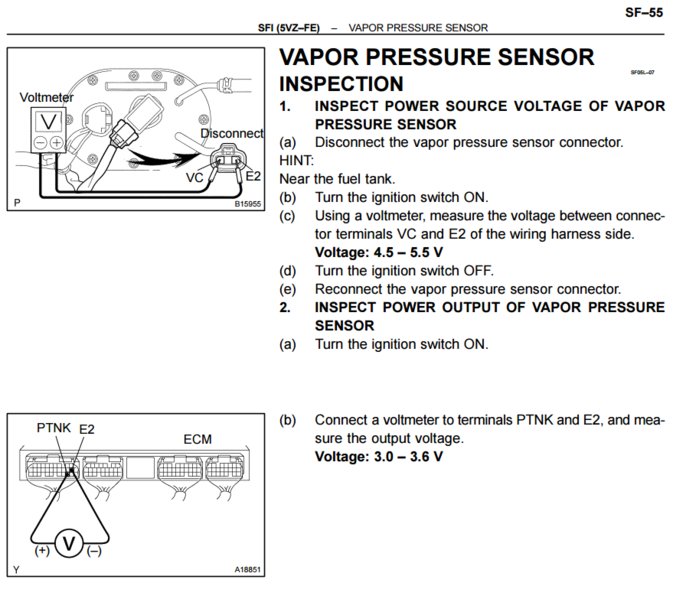

    Sorry, bud. I would need to see your truck to figure out what's wrong with it. If you want, you can test the 2 valves on your own. Get a piece of 1/8th inch vacuum line, a 9 volt battery, and . take off the 2 valves and give power to each valve. they only have 2 connections and it doesn't really matter what polarity you use, a 9 volt wont damage it. at the same time ,you blow air through the vacuum tube and see if the: 1) purge valve is allowing air to pass through when given power. 2) switching ports on the vacuum switching valve. So long as those 2 are doing their job, the issue is not p0446 or probably even p0442.
    I order to test for 0441, you have to open the glove box and remove the lining to access the computer and test 2 wires for voltage with a multimeter.

    p0441 is a circuit malfunction. I just had it. essentially your pressure sensor may be going haywire and the only way to test the connection is to test 2 wires connected to the computer. is it auto or manual?

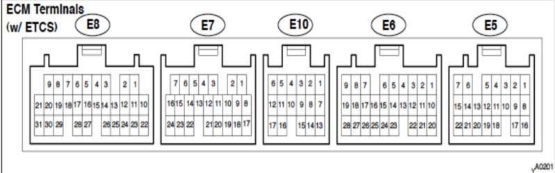

    ok so pin out E8 #11 and 24 are the ones you want to test. this will tell you if, with ignition on and engine off, the pressure sensor is operating at nominal voltages. mine was 0 when I tested these pins on mine and when i disconnected the sensor the 2 pins jumped to 5v. so I ordered a used part, cause I couldn't find a new one, replaced it, got the 3.4 or so volts and 3 10 minute drives later my check engine turned off.
    the codes are still there btw.. but since everything is checking out theyre still in a sort of self test phase and will disappear on their own. if they don't disappear after a few weeks, clear the codes and re-run the emission rediness tests. . i did this about 3 weeks ago but i drive maybe 7 miles a week.
