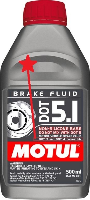

    Check out the picture - claims DOT 3 & DOT 4 Compatible.
    I'm currently installing Brembo Rotors, Hawk Pads, and SS Goodrich Lines. :thumbsup:

    It is indeed compatible just like it says on the bottle and does provide a higher boiling point like DOT 5 while maintaining the ability to absorb water like DOT 4 and DOT 3. I would use it if you believe that you are likely to experience higher fluid temps due to towing especially if you are towing heavy loads or in hilly regions. Why would that be overkill?
