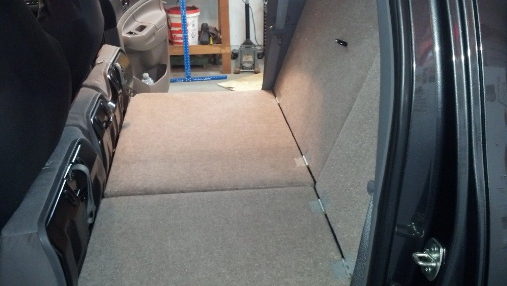

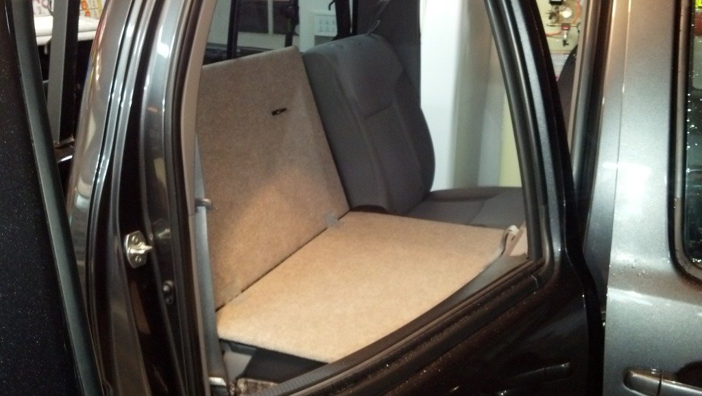

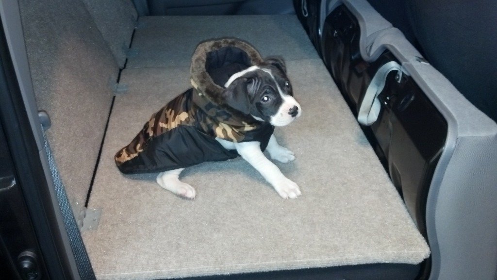

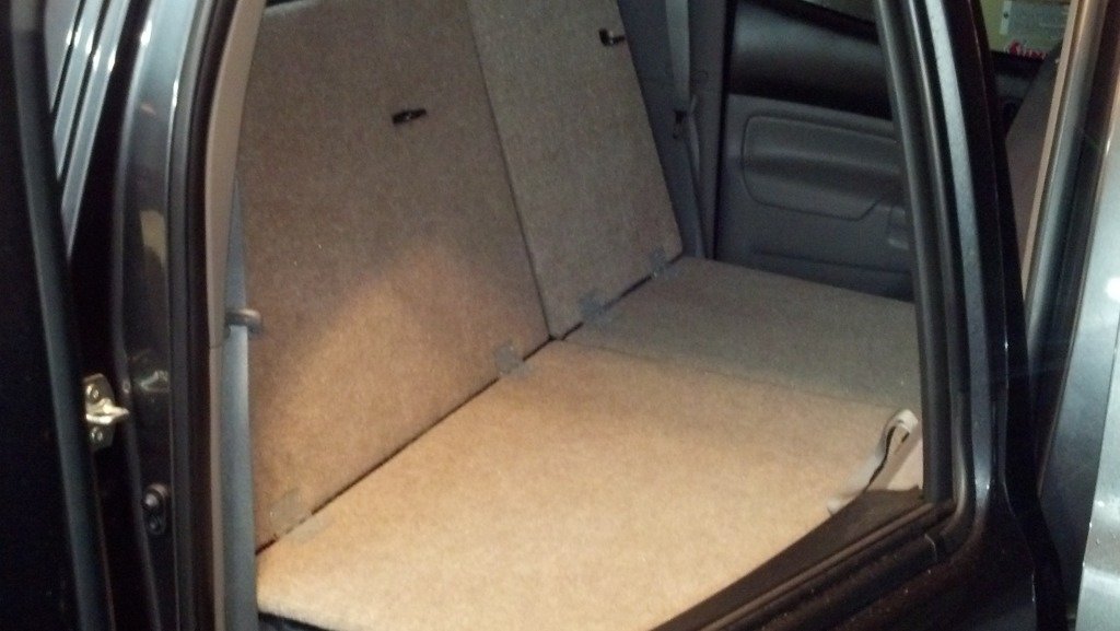

    The OP made his one piece that covered the entire back seat. Here's my take on his original idea:
    I started with the OP's measurements and the tweaked the design to fit my needs. Basically just a two piece set up.
    This way I can use either the big or the small side and have room for my Boy and my pooch.
    He'll grow into it...

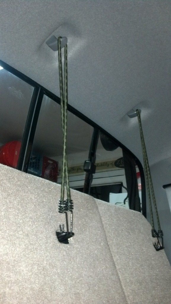

    Here's my low budget solution to keep the back from falling. Ran out of time today. I'm going to come up with something better before I actually use this...

    Do you have any suggestions on how your gonna keep the backs from falling forward aside from the bungess?

    I'm thinking of cutting out and carpeting a another square of plywood. Maybe 4"x4", with a slot just big enough for the seat bracket. Then, just clipping a spring hook through the protruding seat bracket.
    Make sense? I think it'll work well. Honestly though, just dropping a big screw driver, or something similar, down through would work too I guess.
    EDIT: Actually, now that I think about it, finding the right, safe, thing to just drop through the seat catch is probably the best route.

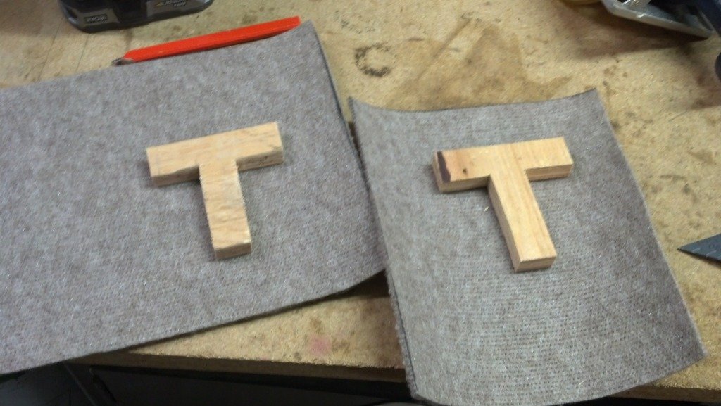

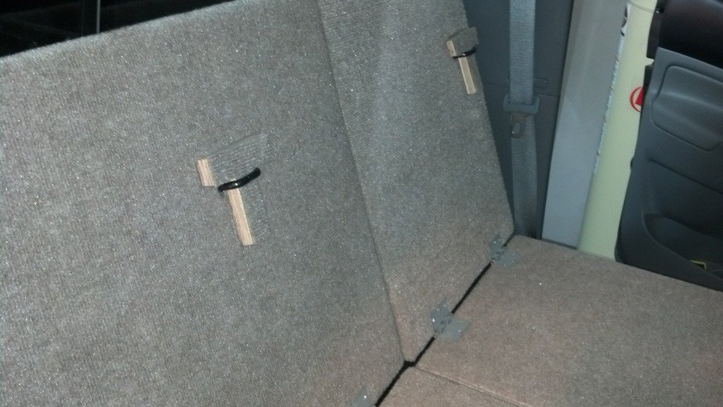

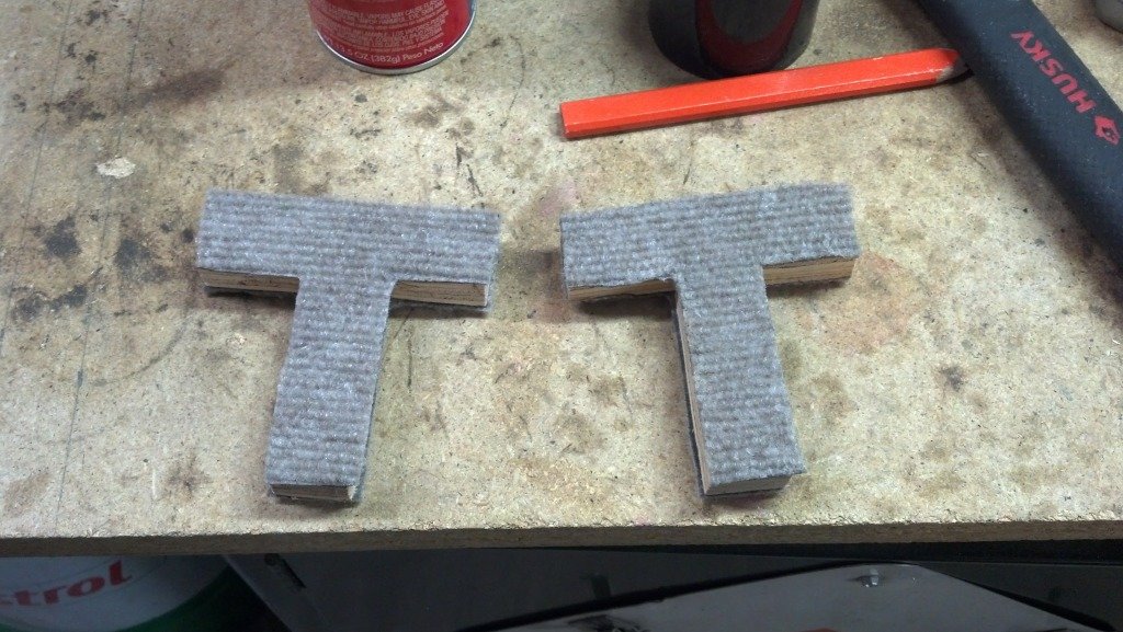

    OK, so, I was WAY overthinking how to keep the backs from falling...
    I used some scrap 3/4" plywood for the T's. That, and the carpet on both sides, made them just the right width to slide in easily while still being thick enough to keep the back panels from rattling.

    I just used a padlock to keep my back from falling forward. The added security is nice.

    I cut he holes too big. I would've had to use (buy) two BIG padlocks... Otherwise, I would've gone that route as we'll. I'm glad I did it the way that I did now though. The T's are thick enough to push the back up against the truck. I can't stand rattling... :D
    Ha! My Fiancé picked it up at Petco. I told her he's going to be too big for it in a couple of weeks! It is cold here though. Poor little guy shivers when we take him out to pee.
    Unfortunately, no. The OP to the link I posted in the first thread wrote that he extended his seat brackets so he could leave the back in place though. Then he put carpet on the back of his seats.

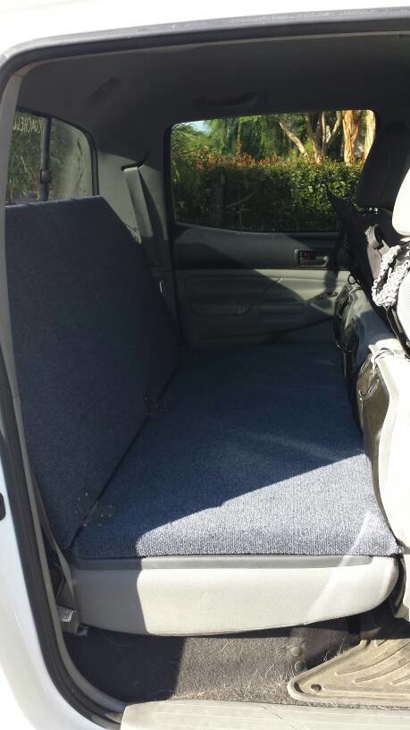

    Finally got around to making one of these platforms. It turned out great. I didn't want the seat brackets coming through the back since my dog is huge and he likes to lean. To keep the back from folding forward I used a carabiner and some 550 cord and made a small leash that attaches the back board to the seat bracket. But I might change the leash out for a pair of gate latches
