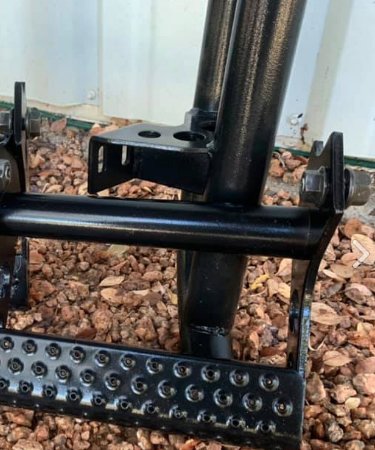

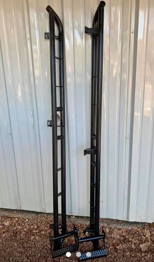

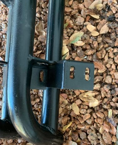

    I'm looking to buy a pair of step bars for my truck, but the local seller said the mounting brackets did not fit their 2nd Gen and believes that they are made for the 3rd Gen. I have read that the 2nd and 3rd gen are for the most part cross-compatible, so I want to make sure that it will fit my truck before driving out and buying it.
    That being said, the seller asked for some dimensions on my truck, namely the location of the mounting hole locations. They have told me that their steps are 69" from the front to back hole centerline. On any day I would crawl under my truck to measure it myself, but I have to work late today... So if anyone knows off the top of their head whether 69" is the actual dimension or can measure the distance between each mounting hole, it would be greatly appreciated!
    I will attach some pictures of the steps if it will help! I have asked for the brand, so hopefully when I hear back I can look them up myself for fitment.
    Screen Shot 2019-12-03 at 10.34.20 AM.jpg Screen Shot 2019-12-03 at 10.34.28 AM.jpg Screen Shot 2019-12-03 at 10.34.34 AM.jpg

    Front hole to middle hole is 30",front to rear is 69 1/4".I got a cheap set of boards delivered yesterday,installed by 3pm..took them off this morning.easy to measure them on the garage floor..lol...oh yeah,this if for a 2020 Double cab.

    Great, thanks! I crawled under last night and got the same measurements.
