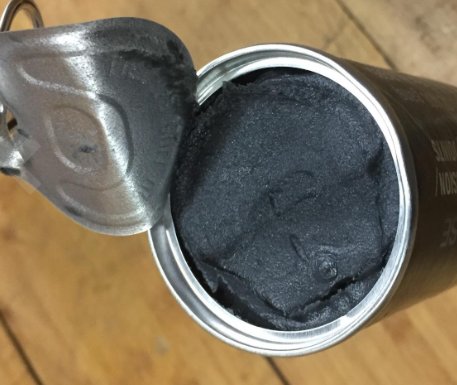

    the ting you describe (often called a ping) is something I have had been dealing with for a long time. Eventually what fixed it for me was using the proper molybdenum grease in the slip yoke, as the manual calls for. I had previously been putting whatever grease I had into it (red n tacky, green grease, etc), none of which contained moly. After I put moly grease into it, the ting eventually went away. I think the grease I purchased was some sort of valvoline brand moly grease.

    Could be it, all I know is it's a very dark grey color.

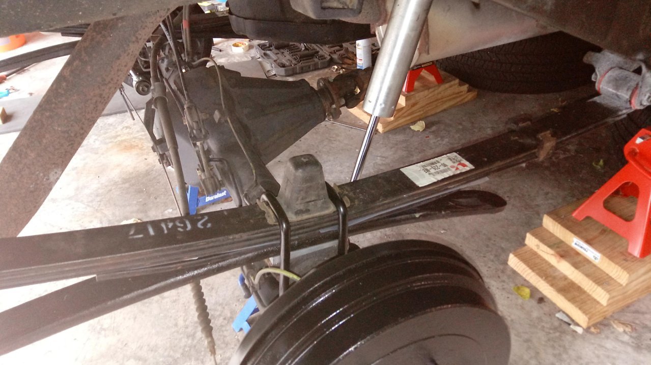

    Throw a $20 set of 3 degree pinion shims under your leafs. May need new Ubolts too. This is the cheapest way to fix a pinion angle issue, and it usually works for most.

    Anytime you lift, you change your pinion angle. Doesnt matter if its 1",2",5" etc. Axle shims are the proper way of correcting this. The ones I have bolt together with the leaf pack, perfectly safe and like theyre meant to be there. 1016180935a.jpg
    Only way to go around it is to revert back to an oem spring pack.

    You should always shim your axle whenever lifting. I got some really nice ones made to spec from 4crawler, but their website is very "early-2000s", good luck navigating it. I had to email back and forth to figure out what I needed.
