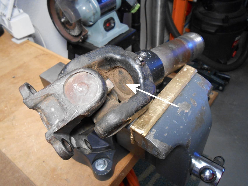

    The good news is if it's a drive line "ping" it can only come from the companion flanges (3), the u-joints (4), the Double Cardan "ball" and or the slip joint. Unfortunately any of those items can produce the exact same sound and that sound likes to "telegraph" along the entire shaft.

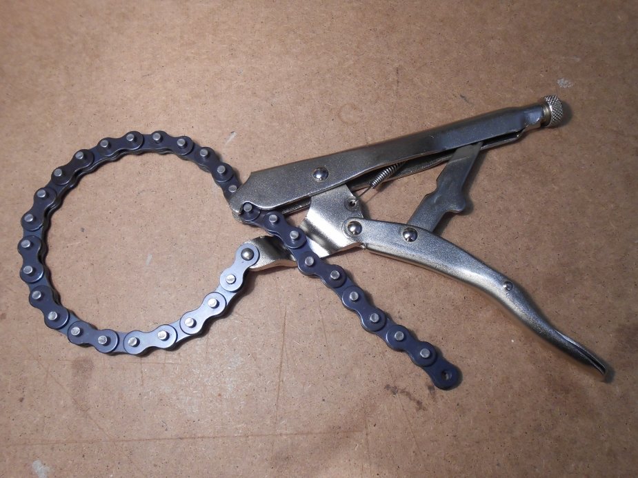

    To get enough speed and leverage to bring out the ping, have a helper rotate a tire back and forth while you snoop. A vise grip chain wrench is very handy to provide the needed leverage and speed when rotating various individual shaft components back and forth.

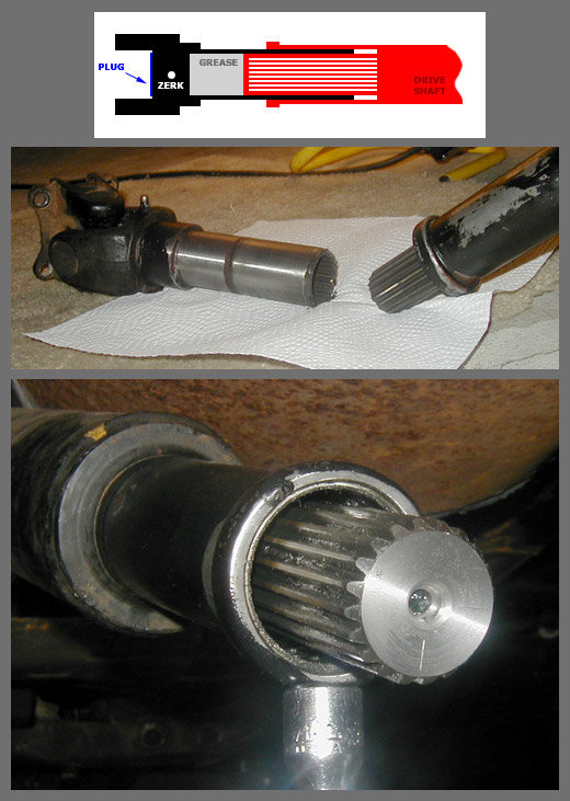

    The slip joint can be tough to lube, or get enough lube into. It's essentially a closed chamber and will hold a bunch of lube, sometimes too much. To get grease from the zerk, to and passed the splines and out the seal (provided it is not sealing too well) means that the entire end of the shaft is filled with grease. Now hit a bump and you may hydraulically pop a plug out the back of the joint.
    Study the diagram and trace the path the grease must take to fully lube the splines. There may be some special super sticky/stringy lube that will quiet better for longer.
    The plug, been there.

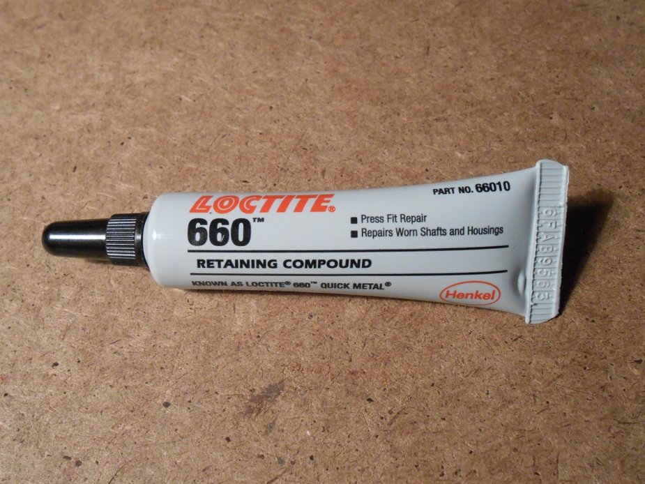

    I had a fellow lined up to come in with a ping he swore was the transfer case flange. I bought a tube of "Loctite 660", "repairs splines, shafts and press fits" but the fellow never showed. So the jury is still out on that. It seems a bit hoaky but there has been a fair bit of success with loose Volvo axle splines using it. Google will return plenty about the Volvo issue and use of 660.
