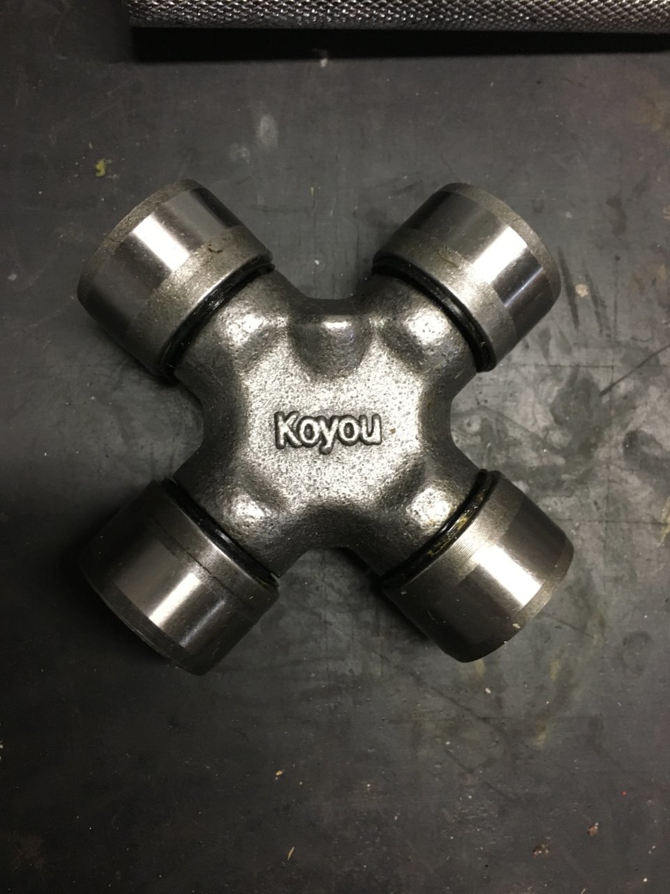

    I talked a fellow thru one. He was the fellow who found the Rockford #2540 joint. Same procedure as the inside clip style only the caps don't need to be pushed as far making it a tad easier.
    Good deal, I had heard some talk of another source/brand a while back but no solid info.
    I looked up Powertrain Industries and low and behold they have a location right here in town. Moderate coincidence right there. I'll have to check them out.
    I'll put a link to your post in the write if you can confirm fit.
    Did they list it as a Tacoma application or did you find it thru a "dimensional" chart/list? Not going to comment on the "KOYOU" name till more is known.
    Let us know how it goes.
    EDIT.......So a little later I ran the 1351-25 part # and it came up as a 1.063" cap diameter not the "reported" 1.065" of the Rockford 2540. The Rockford 1.065" spec came from the fellow that found it. He also said it was not in the catalog and had to ask for it (at Rockford). So I guess we will see.

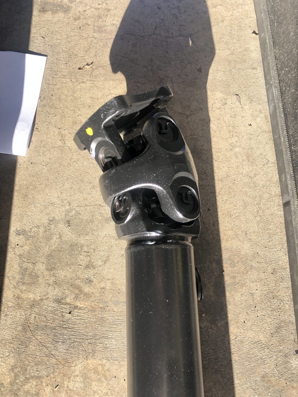

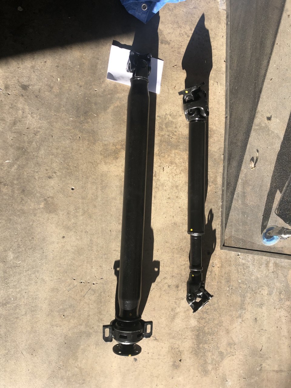

    I just had this happen last week. I have a u-joint thread I started. I had to take it to a driveline shop and pay $400 for them to rebuild. Was it the best option? At the time probably. Is there a better one? Idk. The new cardan they installed is not a Toyota part and has otc parts and 1310 u-joints. But I should get another 100k at least. Shop says they new oartbis better than the stock. He certainly could have been blowing smoke but hey, they had me fixed in a Friday unless than 2 hours. I would say money well spent for a part I’m hoping to get me to 200k miles.

    Not sure if you can tell. It was impossible for me to take apart the Dc joint. I just don’t have a vice or a plethora of pry tools. The tail shaft and axle side with the inside clips are pretty easy but the sizes of the replacements are tricky. I’ve heard Toyota’s are rather tough to size the ujounts properly over the counter.

    My new $400 driveshaft with brand new joints and paint

    That new DC looks exactly like the one offered on the Powertrain Industries web site as a replacement for the Toyota DC joint...bet that is what they put into yours.
    How is it?

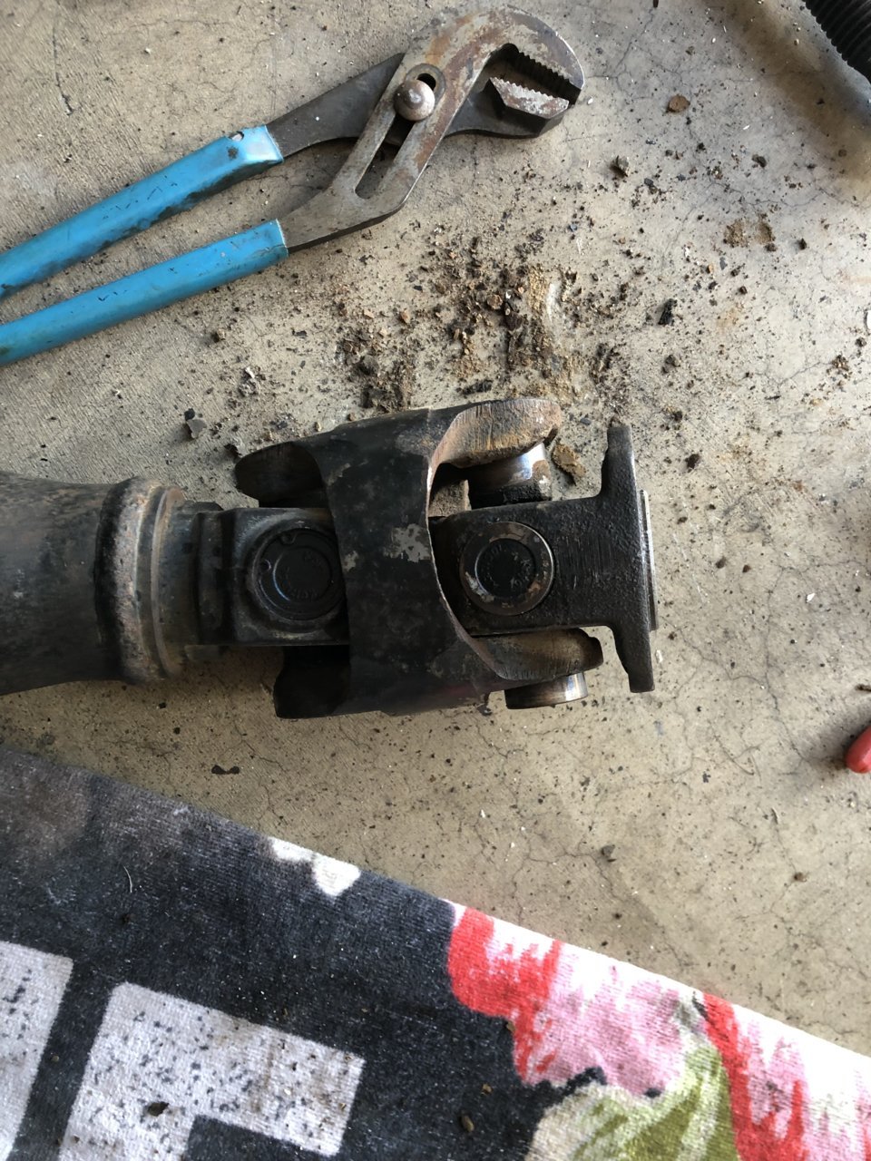

    [/QUOTE] EDIT.......So a little later I ran the 1351-25 part # and it came up as a 1.063" cap diameter not the "reported" 1.065" of the Rockford 2540. The Rockford 1.065" spec came from the fellow that found it. He also said it was not in the catalog and had to ask for it (at Rockford). So I guess we will see.[/QUOTE]
    The ujoints I removed from my outside clip DC measured 1.063" on the caps, they were the original Koyo joints and fun to remove. Had to actually use a metal bladed sawzall
    to get them out!!:eek:..but they did come out. The joint closest to the shaft side came out easy enough, but the flange side one .......agggh. Centering ball and pin appeared in good shape and not damaged or worn much. Rubber seal was also good, so I just greased it up thoroughly with fingers crossed. The Powertrain Industries joints pressed in well with a big jawed vice and I used a 12mm socket to finish the final few thousandths so the snaprings would fit into their grooves. Pumped them full of good quality Valvoline bearing grease and put it back into service. So far, so good, no rumbles or weird vibes of note yet :fingerscrossed:.. As you say, time will tell:rolleyes:. Thanks for your work on this write up and thread!

    Good to here, the fellow that reported the 1.065" could very well have been mistaken. I'll put a note in the write up.
