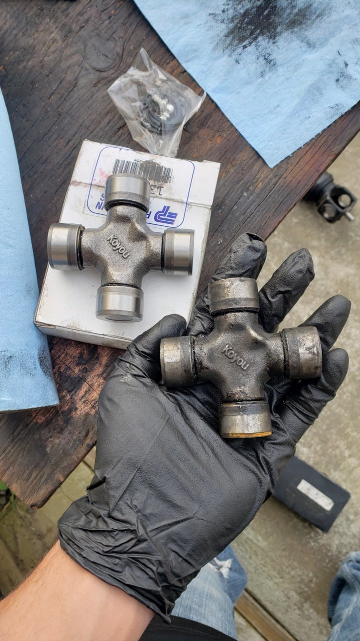

    20190403_174145.jpg 20190403_174145.jpg Alright so theres an update, the ujoints from http://www.theujointstore.com/ work pretty good basically direct fit and looks OEM to me part #1351-25 from powertrain industries.
    Left one is the one I ordered and the right one is what it originally had, looked good for 280k miles
  9. Apr 3, 2019 at 9:53 PM
    #89
    1Fine40
    1Fine40 Well-Known Member
    Dec 24, 2014
    #144873
    134
    Rich
    Great Northwest
    04' Ex.Cab TRD
    Grey wire, deck plate, 2-Lo, Toytec front, All-Pro rear, 4.88's (Hi rpms!)
    Niice! That makes me feel happy:thumbsup:
    What was the condition of your centering ball assembly? Hope it is good!!!
    Whitetaco559 likes this.
