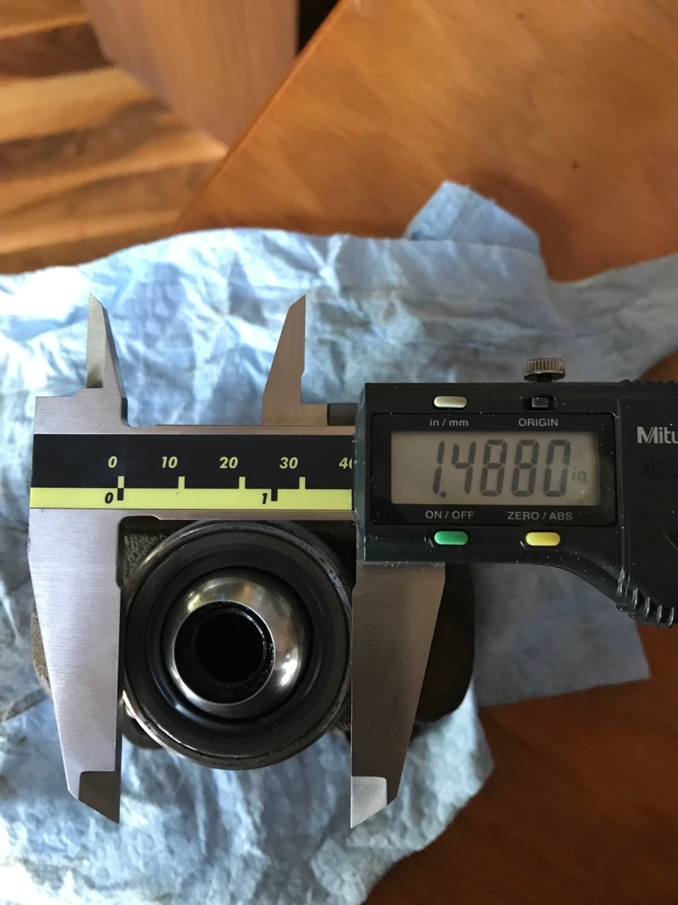

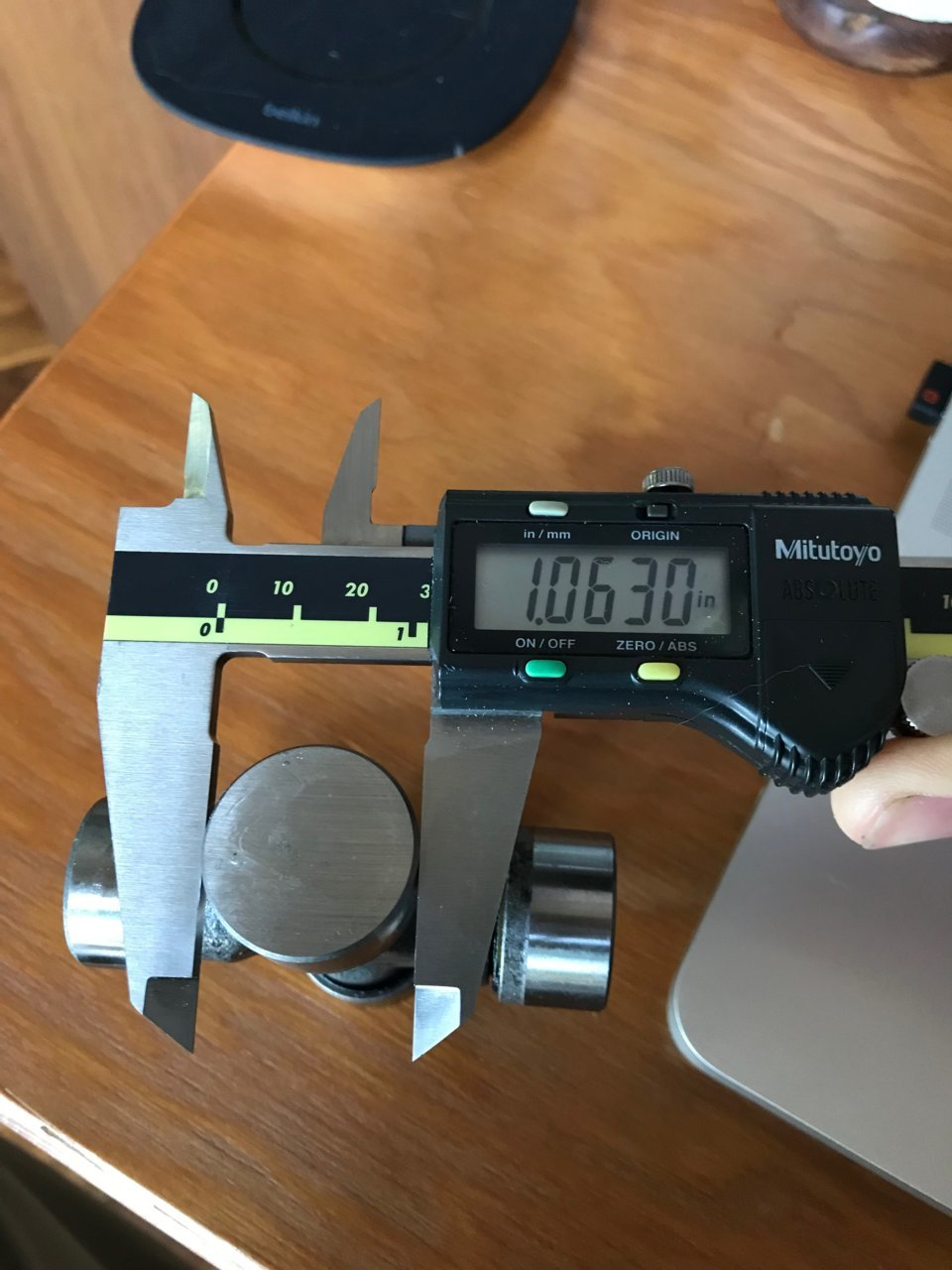

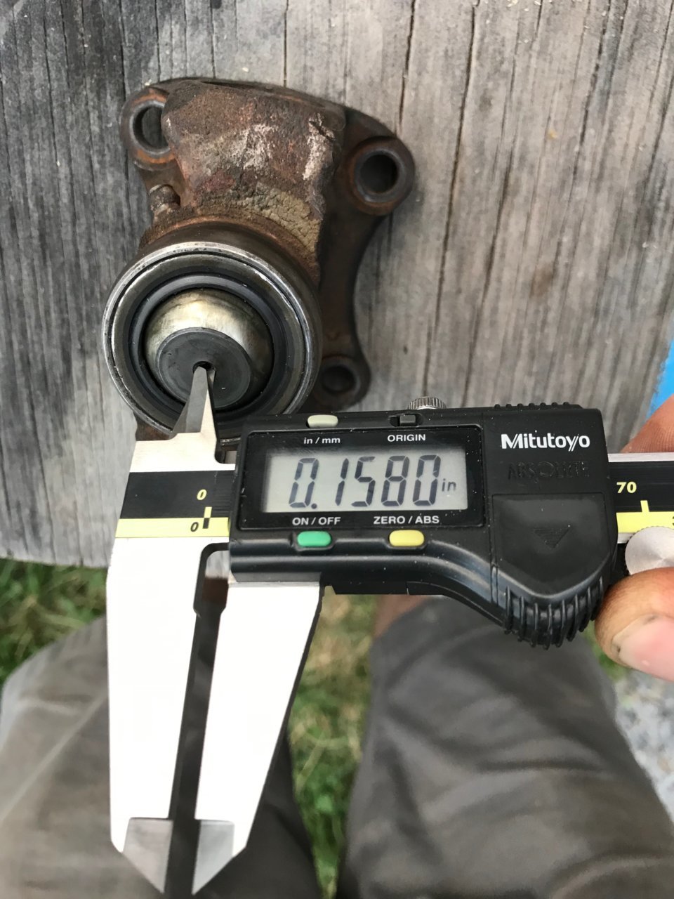

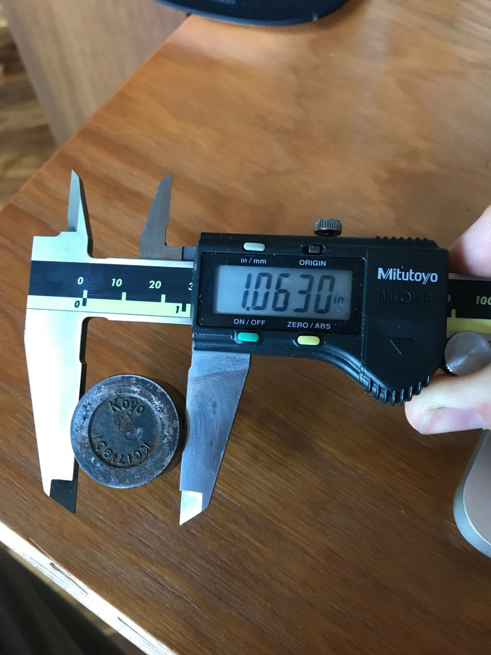

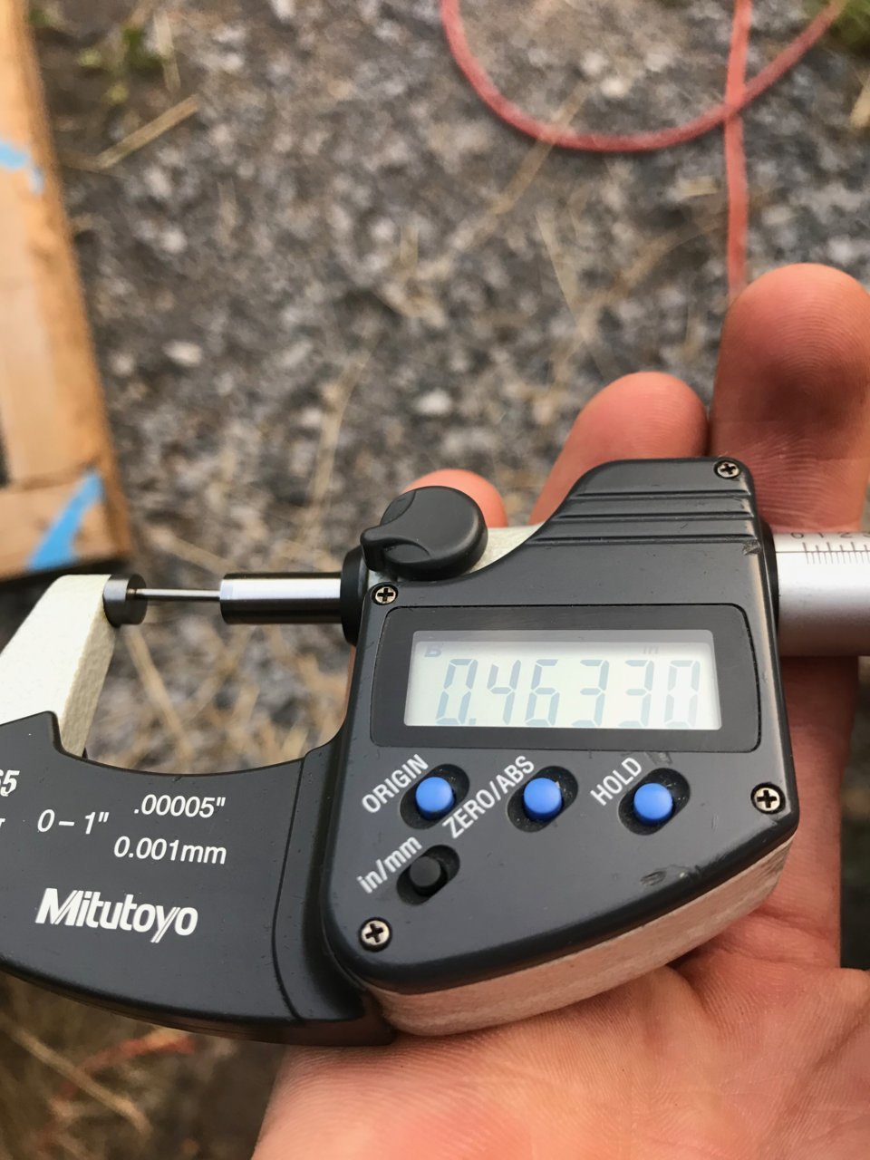

    Alright guys. Here are the measurements of the caps along with my centering ball stud diameter....which is of course a .470" stud. Does this mean I'm screwed if I want to find the proper needle bearing? Anyone have an extra laying around....:help: I also attached a measurement of the needle bearing.
    Old Cap Diameter
    New Cap Diameter
    Stud Diameter
    Centering Ball Needle Bearing Diameter
    Centering Ball Needle Bearing Length

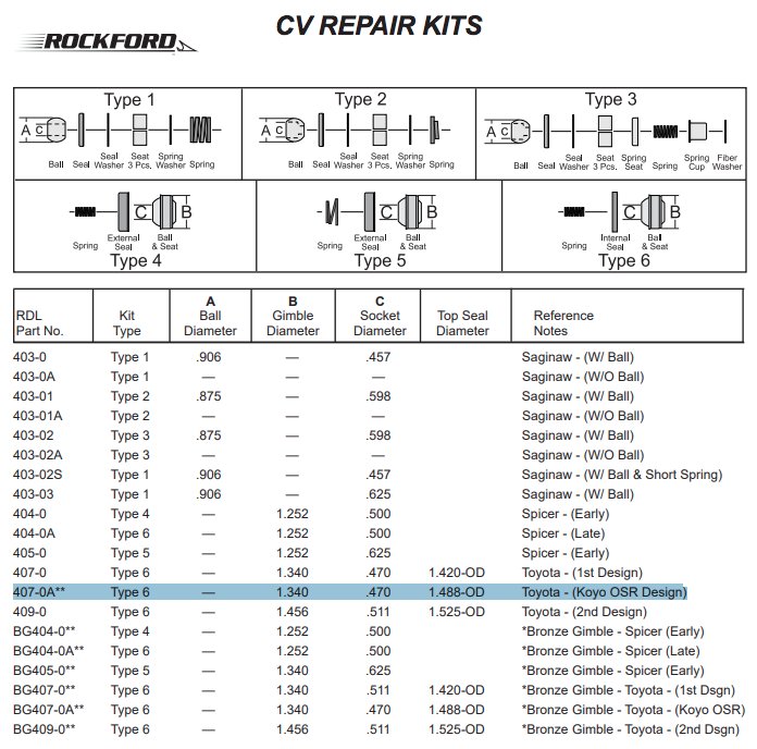

    Thanks for the recommendations Rich! I called Rockford Driveline and it seems like they may have the centering ball for the .470" diameter shaft. I still need to take a couple more measurements to make 100% sure. I attached an image of the CV Centering Assembly Catalog, Page 10. I'm looking at RLD Part No. 407-0A. It's also the Koyo design which was the stock u-joint brand so that's promising.
    Here is the catalog site: http://motormasterpowersports.com/catalogs/Centering Assemblies_1_2018.pdf

    Finding an individual needle or even a bag of them is not something I would spend much time with, see post 28 and 30.
    From page 111 of the Neapco catalog, might want to compare your ball size to be 100%;). I'm sure there are other manufactures.
    Taking a fresh look at the catalog, it's strange that they describe the stud size as "bore dia" when the sizes provided are the actual "stud" diameter. I used/measured the 7-0409 on my 99 inside clip. They must be including the needles.

    Inquire about the "bronze gimble" at the end of the list, that's what mine was from the factory. Everything else being equal, might be the way to go.
    I'll add that these parts seem to be increasing in availability at a pretty good clip compared to a few years ago.

    So the top seal diameter is hard to measure with the ball in place but it looks pretty darn close to the 1.488 dimension they listed. Definitely closer then the 1.420. I entertained the bronze gimble version but my factory one doesn't seem to be bonze. So I went with Part No. 407-0A. It's only $25.66+shipping through Rockford which I thought was a good deal.
    One question I have is if everything dimensionally is correct, including the needle bearing, should I just replace the one needle bearing and re-assemble or should I pull the centering ball out and put the new one in. I know everyone says to not mess with it if you don't have to, and mine seems to be fairly tight with no play. I would bet these needle bearings wear slightly over time so I will make sure they are correct dimensionally before placing the new one in there. I also seem to have a smaller hole on the back side in order to use the bolt thru method as @Dirty Pool used - See photo. I guess I'll just use a smaller bolt to pull it out.:notsure:
    Top Seal Diameter
    Bolt Pass-Thru Hole

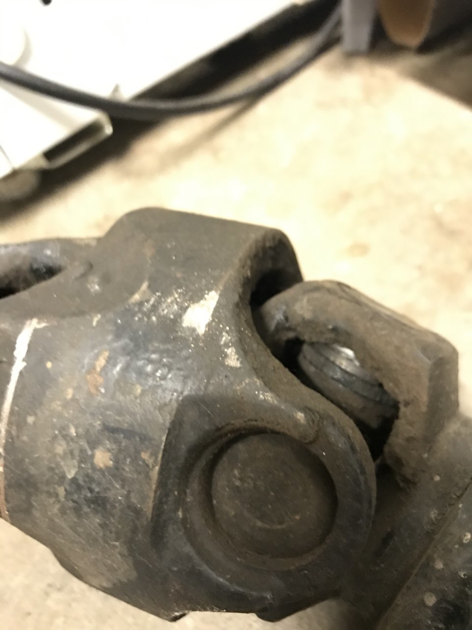

    Looks like I blew the middle ball/spring thing. Ujoints look to be in good shape. I’m debating on taking it back to the place that made the driveline or rebuilding it myself...
    Almost looks like someone did some grinding to get some more clearance. Might have exceeded the balls ability to move?
    I also have two or three ifs toyota double cardon drivelines laying around. Might be worth just mix and matching.
