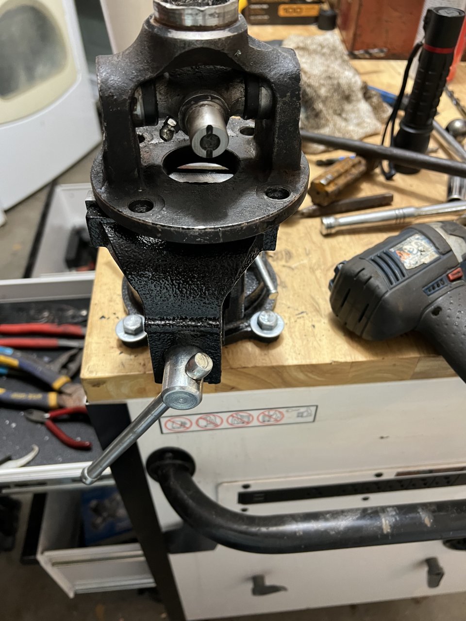

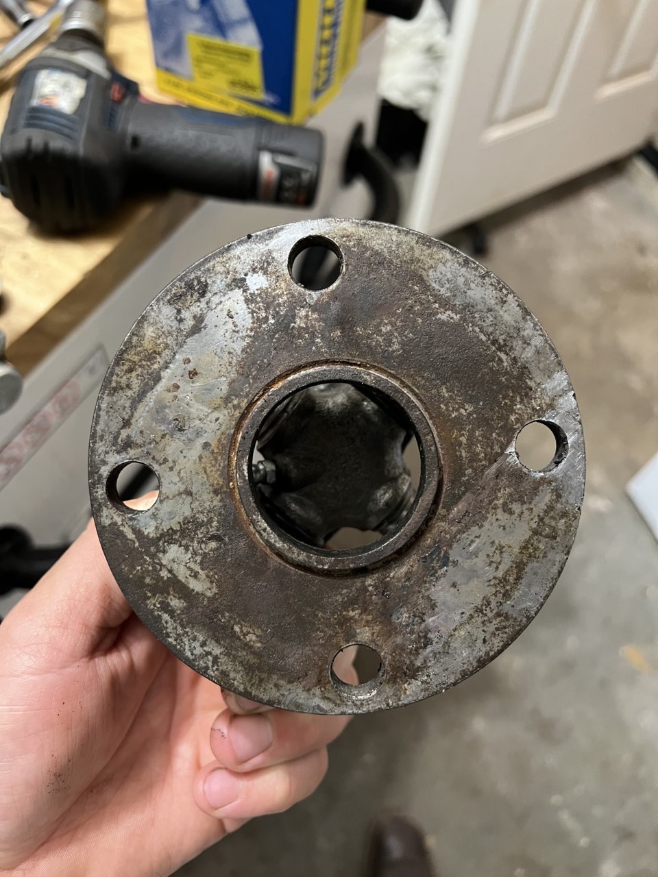

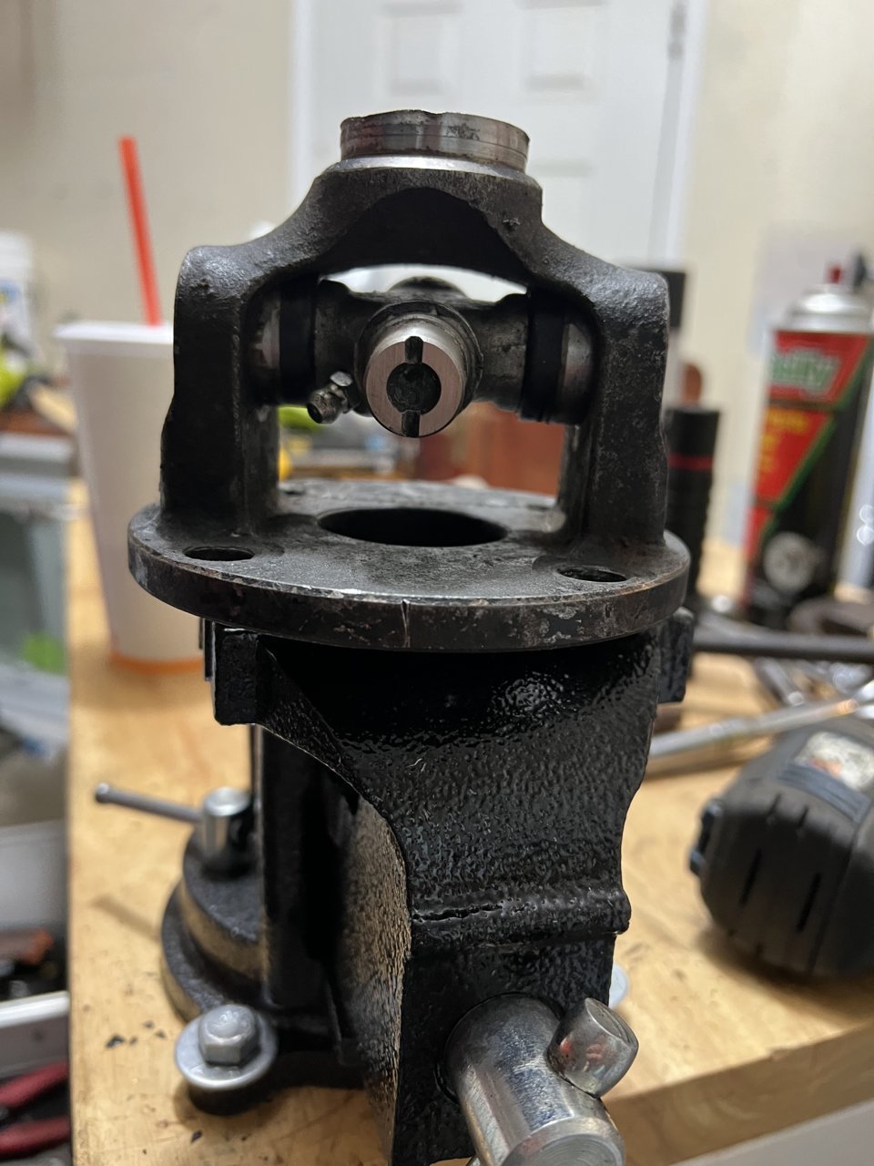

    Hello and welcome to my shit show lol , anyways this thorn here . Where would I acquire that whole set up lol Cardan and all together ? Seams like this set up on the taco I have must have been changed to this because everywhere I look for a 00 Tacoma 4x4 2.7 it shows nothing like this . Some one point me in the direction pleasssseeeee lol
