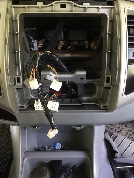

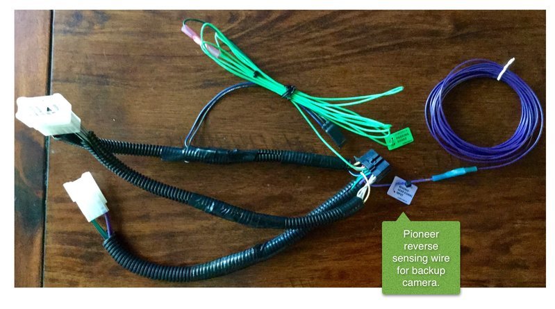

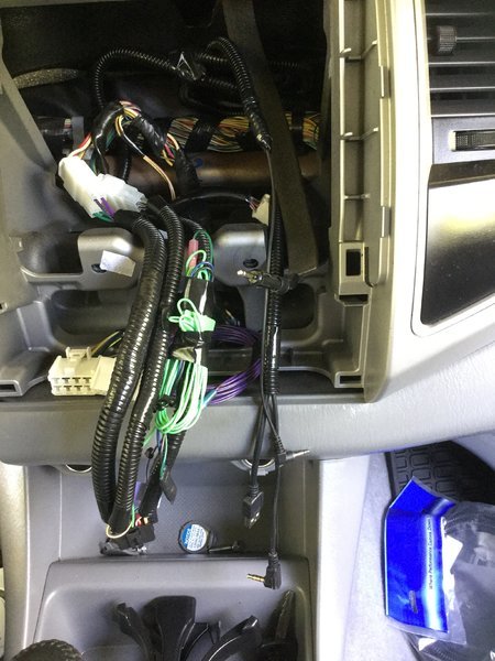

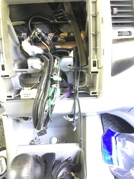

    As mentioned it was pretty darn easy. You can Google it: there's a few videos out there. The harness was straightforward - prep it ahead of time and add the parking brake bypass to it at this stage.
    Making the stereo wire connections to the harness:
    Cleaning it up:
    Factory harness after OEM stereo unplugged:
    New harness plugged into factory connections:

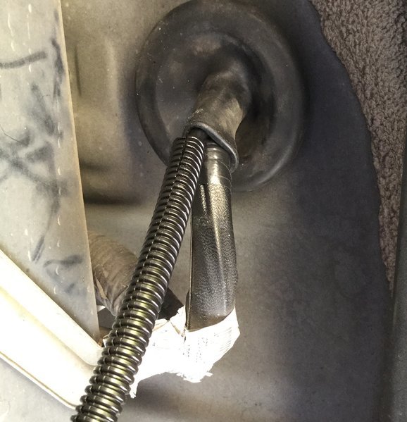

    There is a rubber grommet under the left side of the drivers seat. I used that as an exit to the outside and ran inside the frame to the back of the truck.
    I used splicing tape to seal the grommet.

    I did this. Pic below is that grommet. It's easier if you tape the wires to a philips screwdriver, rub a little liquid soap on it and work it through.

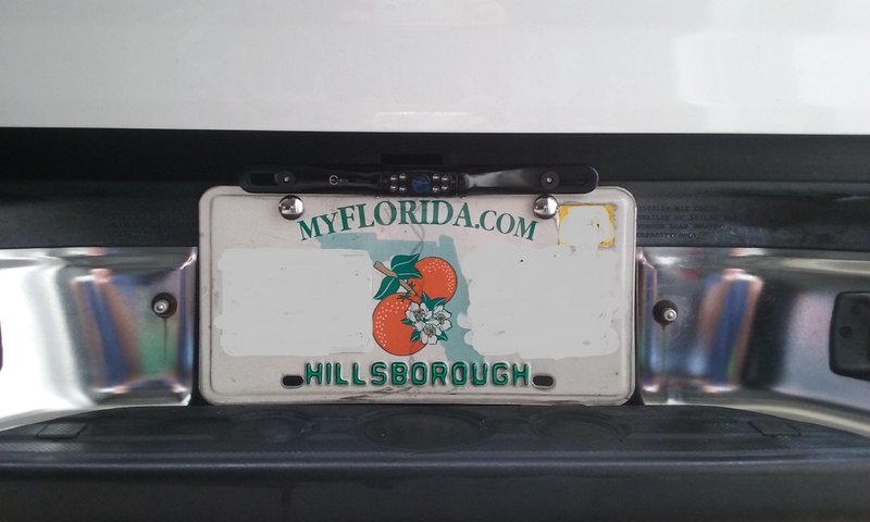

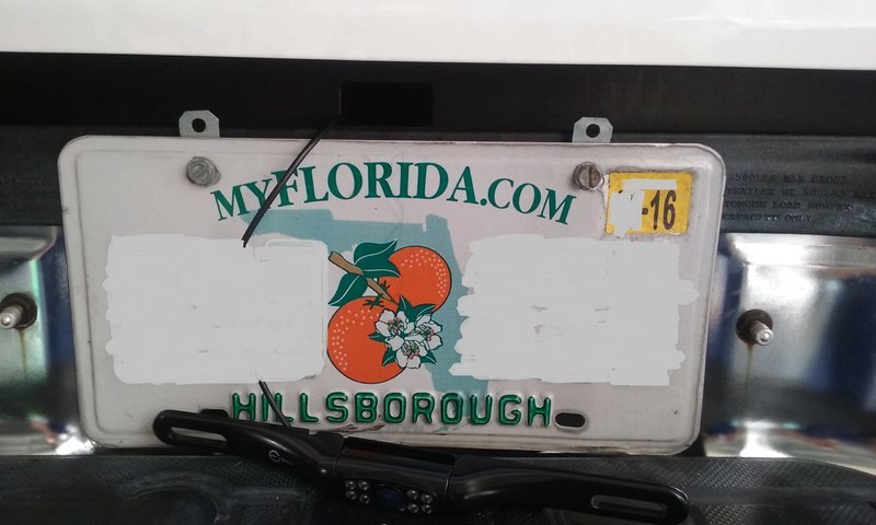

    Here is mine installed. I gave up on the under the bumper install for now.
    made two brackets above the license plate screws.
    finished, the cable made it from the radio to the camera with about a foot of slack.
    And it works great!
