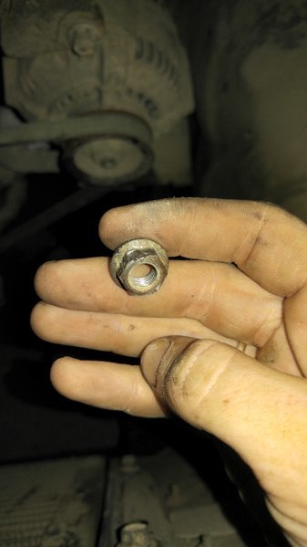

    Got that stripped bastard off the fan clutch

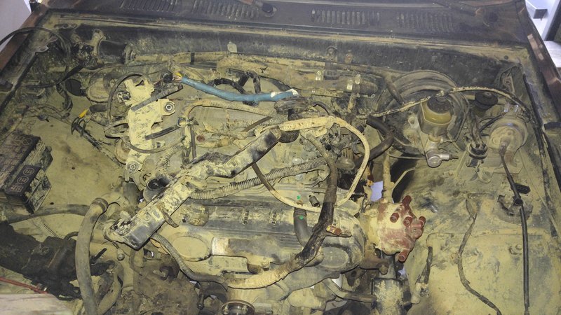

    Stopped taking pics after a while because phone was low on juice. But alt. Is off, power steering is disconnected enough to move to the side, starter is out, lots of shit disconnected. Exhaust has been sprayed so hopefully nothing breaks. :D
    Word to anyone that's gonna rebuild a 2nd gen 4runner, the main harness disconnect is BEHIND the computer, which is mounted against the passenger side fender. I also learned that the 91 has been swamped. 2-3 inches of mud line up the interior when you pull carpet and trim back.

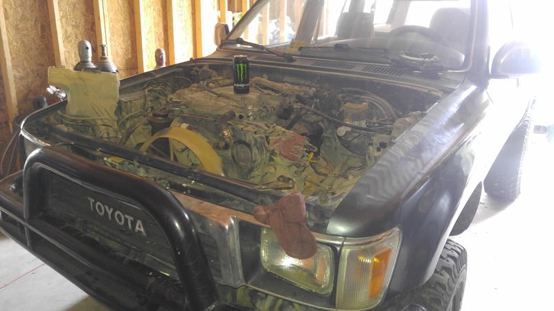

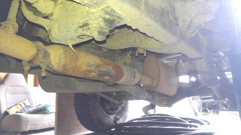

    Bout really to pull. Eating dinner while "the Wizard" is doing the same. Then it's on like Donkey Kong.
    Oh, the exhaust came undone so easy! I was amazed. Must have been apart some time recently, because I didn't even use a cheater pipe. Oh, speaking of exhaust, check out my sweet exhaust system. :rofl:
    There is nothing after the muffler.

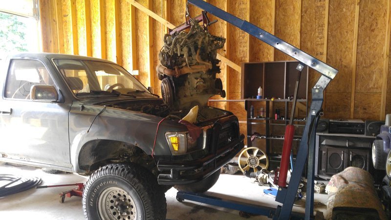

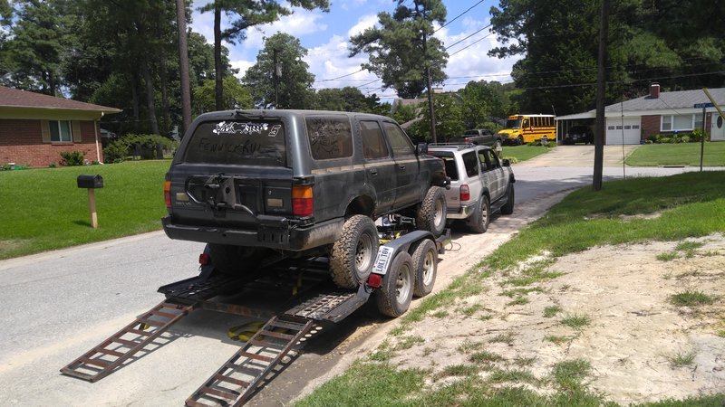

    So a 4runner towing a 4runner. Made me laugh. Got it on the trailer and stuck behind the fence so it is completely out of the way.
    It appears that this valve cover has been off before because if you look closely, you will see that there are two different colors of RTV, blue and black. 20160821_165124.jpg
    Now the 94 is in the garage, awaiting engine removal.

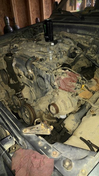

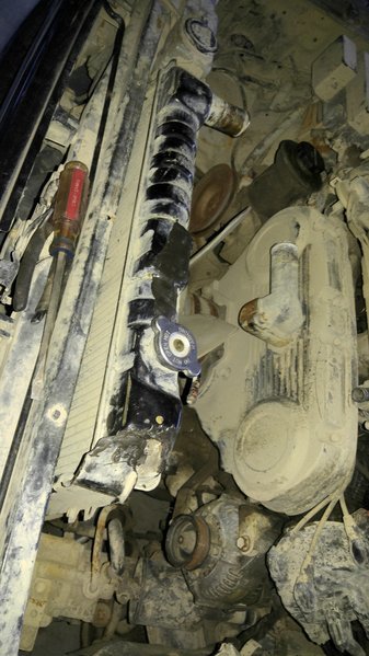

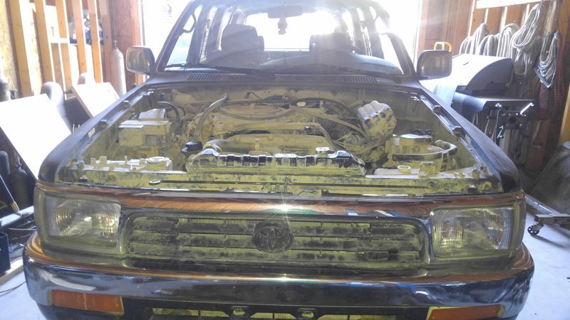

    The 94 is still covered in shit, but not as bad as the 91 was. Found a wasp nest under it and sprayed that bitch with brake parts cleaner.
    Yeah... Radiator is still totally good! :eek:

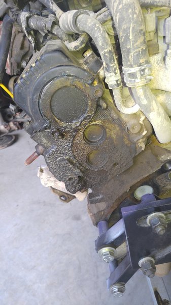

    Kinda figured this one's PCV was never changed either. Yup. But at least the oil from this engine is brown instead of black.20160824_174853.jpg
    Where it stands now. Got the exhaust loose, and punched myself in the face doing it. :rofl:

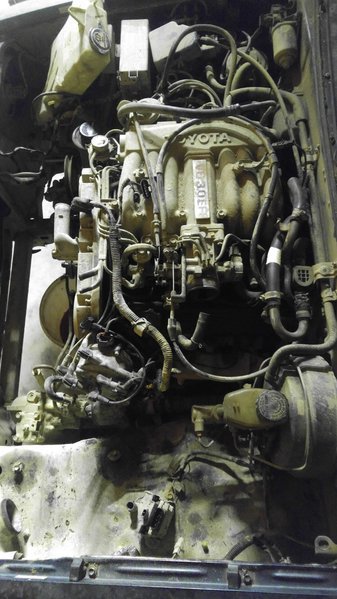

    Well...
    Got the 94's engine out yesterday, spent part of today beginning the teardown.

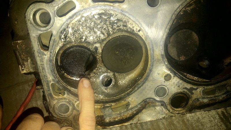

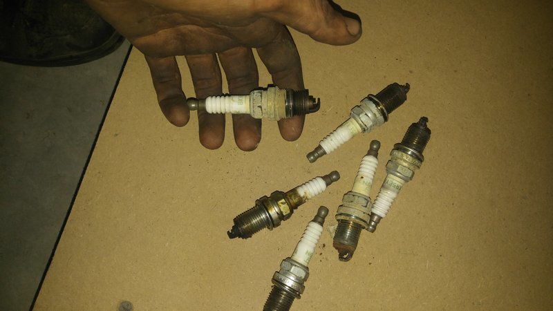

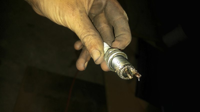

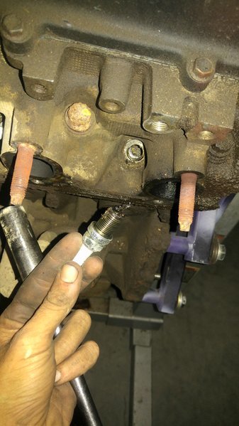

    And then while doing the spark plugs and draining the block on the 91, found this in the cylinder 6 spark plug hole...
    So we shall see exactly what happened here in the coming days, I suppose. The 3.0 is a non-interference engine. Means that timing did not skip and cause this. So looks like either trash/deposits got in the way, or it may have a spun bearing. I guess it is a good thing I have two engines to pick between for parts. :eek:

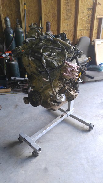

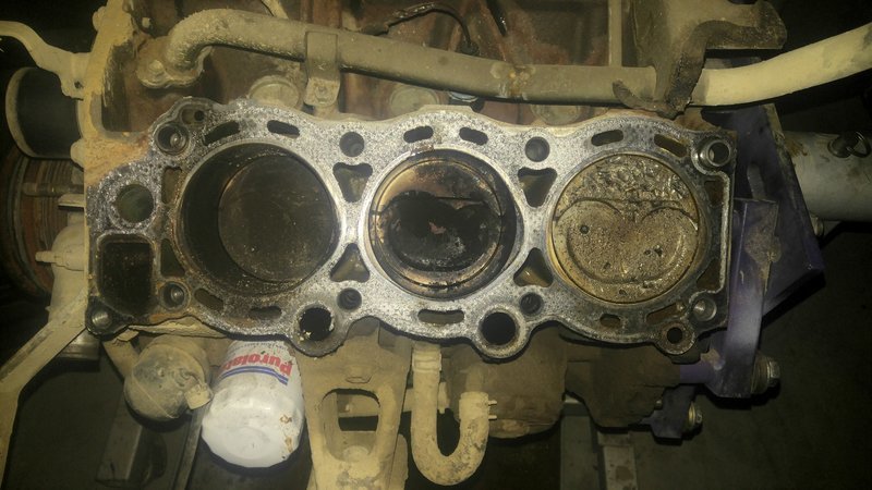

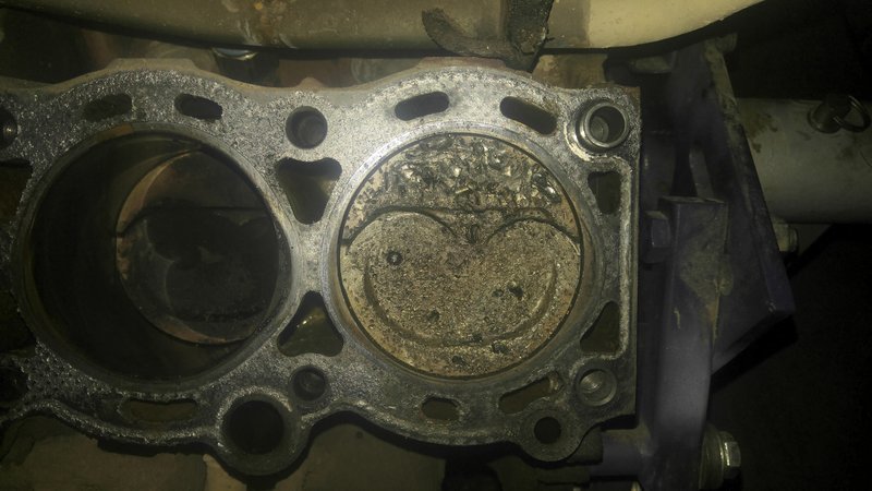

    I have to take more pictures, but here is what's gone on yesterday and today:

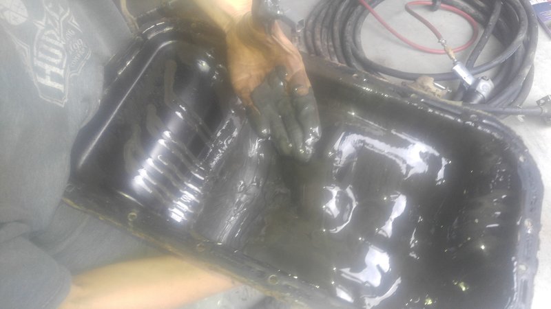

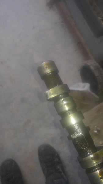

    The 91 engine is pretty bad off. One head is toast. Broke a valve (at you guessed it, cylinder 6) and it got all chewed up. Piston is done, but initial inspection of the cylinder walls and crank are fair. May be able to salvage the block and one head. Bearings are bad. Gouged all to hell. The remants of the oil in the pan were so solid that I was picking up great goopy globs. All silvery with crushed metal.
    The 94 started getting torn down today. Initial inspection after pulling the intake is that it has a blown head that spit outside, because there is a ton of oil in the V of the block, but no noticeable hole in the block. I do not have any pics of the 94 yet, and need to get pics of the bearings as well. Probably take them later today or tomorrow. So here is a picture dump of the 91.
