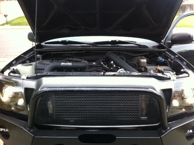

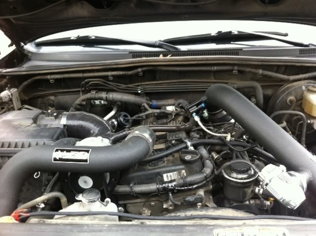

    Just updating my truck. I have the URD 2tr supercharger with Doug Thorley headers and my gasket blew and my header cracked. The DT headers are not made of the same strength steel as LCE headers. I am getting new LCE headers to replace my thorley headers. So if your truck has boost, the LCE headers are a better option. I will post my review of the difference once I get the new headers on my truck.

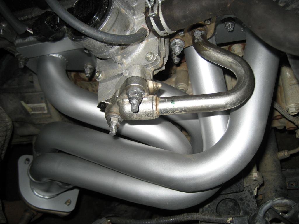

    Good move. The LCE 2TR header is built like a tank and fits like a glove. :)
    63eecebd-d227-4758-af55-202fc9a4543c_zps_c76abb5afe56ac871da739345075a31da92c58db.jpg
    If I'm not mistaken, you're one of the first guys here (and maybe the only guy) with a force inducted 2.7. Would you mind posting some pics of it as well as perhaps a video of how it sounds?

    I will try post a video when my truck is repaired. These are some old photos

    All that black plumbing looks really badass. :thumbsup:
    And that would be great if you could post a video, as boosted 2.7's are so rare.

    That's a good description of the theory... however the actual dyno test results show exactly the opposite.
    A bone stock 2.7 has a torque peak of 133ftlb @ 3,800 rpms.
    Doug Thorley header has a torque peak of 144ftlbs @ 4,000 rpms.
    LCE header has a torque peak of 158ftlbs @ 3,150 rpms. (blue run)
    The DT 4-2-1 short tube header raises the torque peak over stock by 200rpm...
    ...while the LCE 4-1 long tube header lowers the torque peak under stock by 650 rpm.
