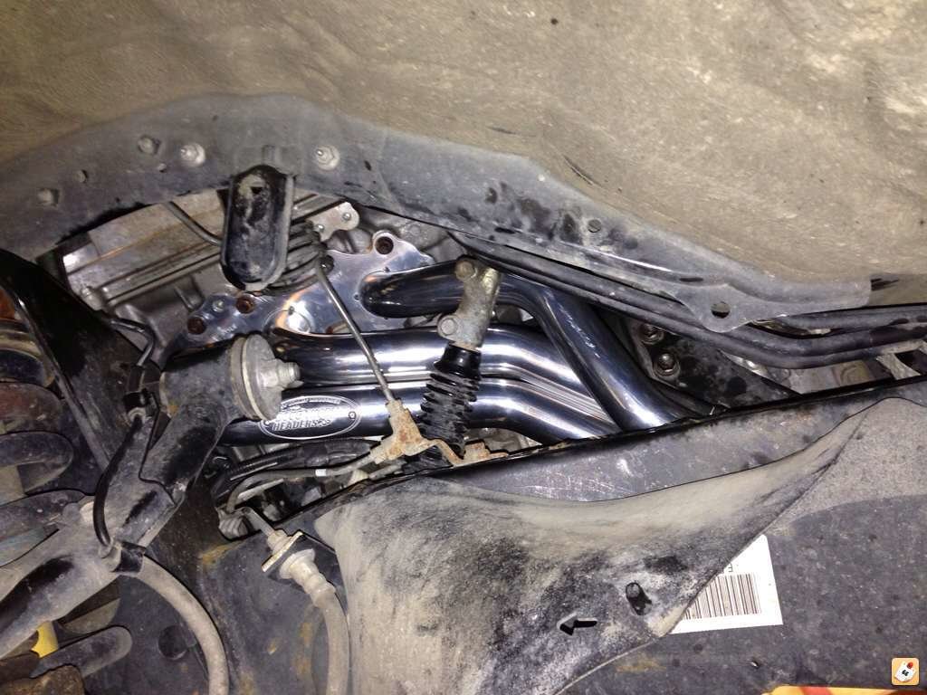

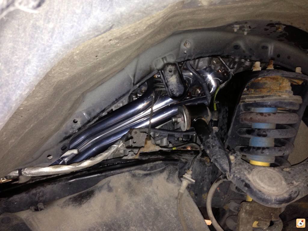

    To be more clear than my previous statement, the '05-'11 headers are all bolt-up the same. No O2 tube.
    The OEM headers changed in '09 from a log style to more of a "swept back individual primary header" than the '05-'08.

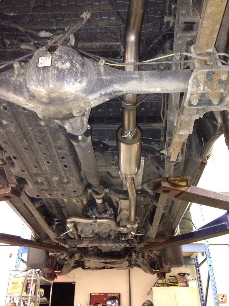

    The long tubes delete 2 cats from 2005+ tacomas then you can delete the other two by getting a y pipe or a custom exhaust like I did. This changes the sound but it also makes my exhaust toxic in my opinion haha but I accept that and I love to see the prius drivers next to me I even get some dark smoke coming out when I get it above 3000 rpms!! so they pretty much die from horror now :D

    I also have the dt y pipe and I'm toxic as well :)

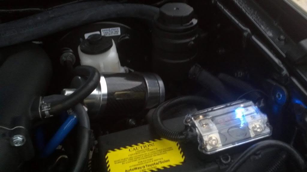

    I do believe that the catch can needs to sit upright, to collect all the oil/sludge at the bottom, depending on the design, it might just be sucking all the oil right back in.

    That was just for the install its sitting up rightish but the way its designed it won't matter I already looked at it. Thanks though :D
